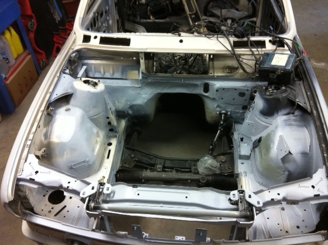

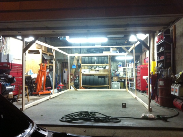

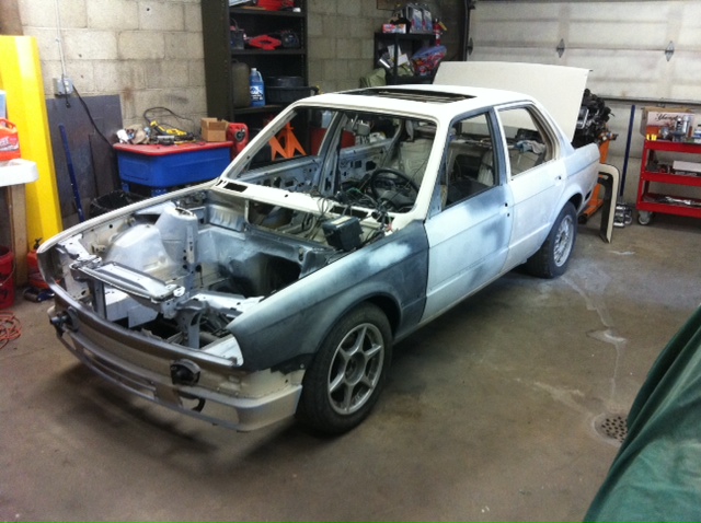

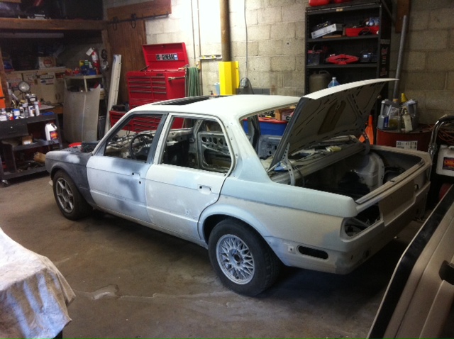

                        If all goes as planned, the car will be fully prepped by this coming weekend and I can start building the paint booth.
                        There's just a bit more sanding to be done, then the car needs cleaned. I need to do a bit of fiberglass work on the rear bumper, otherwise all of the actual body repair is finished.
                        I'm building a 20'L x 12'W x 8'H booth, using 2x4's. It will be wrapped in 2 and 3 mil plastic sheeting. I'll build in a couple fans and filters. It's pretty basic, and I'm sure it won't be perfect for painting a car, but I'm not building a show car.

                            Got the paint booth framed out. Still need to figure out fan and filter mounting and hang the plastic sheeting. Using 3 mil for top and bottom and 2 mil for the sides.
                            Car is fully cleaned and prepped for paint. Just need to tape it off and do a final wipe down when its in the booth.
                            It's currently a BMW 300i LTW :)
