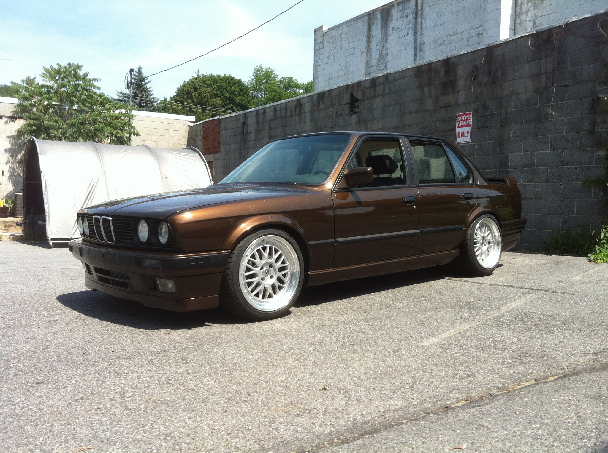

    hell ya man! shit's dialed. need tire shredding video.
    • brianao34
      • Jun 2010
      • 660
      #497
      Great job man. Didn't take you very long at all. Can't wait to hear it
      • dirty30
        • 3005
        #498
        Originally posted by JGood
        Initial test results are in: Traction in 2nd gear is non-existent. Mission Accomplished!
        That color looks incredible in the sunlight!
        • RobertK
          Kicked cancer's ASS.
          • Jun 2005
          • 5864
          #499
          Video!
          • MR 325
            • 37827
            #500
            WOW.
            Fucking wow.
            Classic BMW Specialists
            Santa Clarita, CA
            www.BimmerHeads.com
            • BUDNUNTA
              • Apr 2005
              • 996
              #501
              Can't wait to see it in person
              We're out there in here.
              • e30m3s54turbo
                • Jun 2010
                • 3209
                #502
                Dam! It looks so nice.
                • Simon S
                  • Oct 2004
                  • 3758
                  #503
                  From swiss cheese - to show car.
                  Fuckin A mate. Well done.
                  -----Zen and the Art of e30 Maintenance - / - Zen TOC - / - Zen Summary
                  • rich4rdee
                    • 595
                    #504
                    just found this thread! everything looks fantastic..the color, stance, and attention to detail really stick out. great work.
                    • evandael
                      • Oct 2009
                      • 2881
                      #505
                      beautiful. great job man, hope it provides you with many miles of smiles (as it should, it's practically a brand new car now!)
