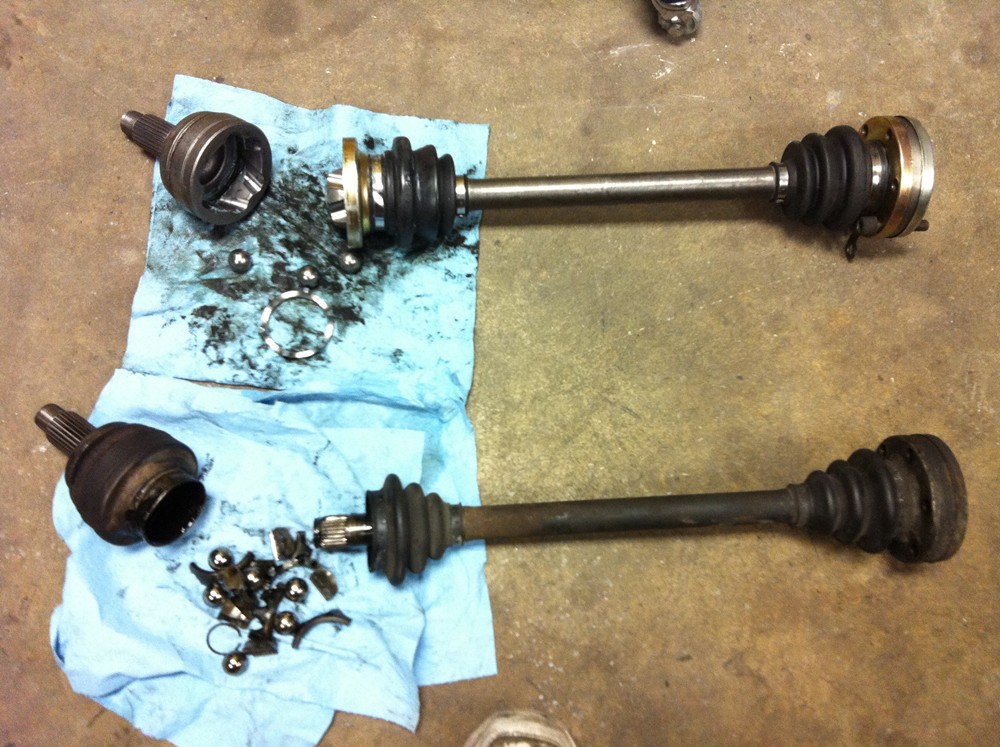

    Put the rebuilt axle in, took it for a test drive, made it 20 miles, and the CV joint blew apart. Had to get it towed home again.

      Shit.....thats discouraging. Think you got a bad one, or were you wailing on it?
      Maybe its wishful thinking, but I would have to think that the stock axles should be able to hold up to daily driving? I mean, sure you can break something if you wanted to, but I never looked at a stock E30 rear end like it was made of paper. I'm surprised your chewing through CV joints. What the plan moving forward?

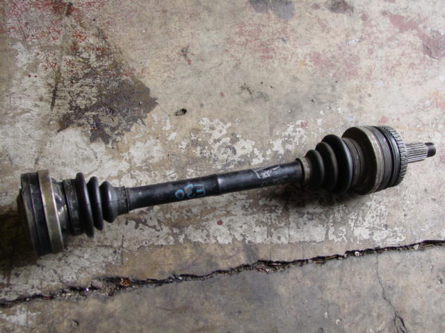

          Hmmm, maybe the early axles ARE weak vs late model? So many guys pushing WAY more than 300 and are ok on e30 rear ends.

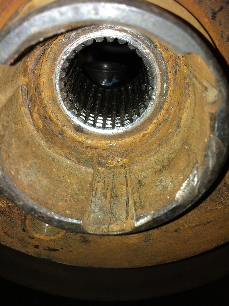

            Pulled the axle out, the 32mm nut was loose. No idea how/why. I definitely 100% positively torqued it
            As soon as I pulled it out, I noticed play in the hub. So I figured the rear bearing is shot. No idea if this is related to the axle failures. But it moved a LOT. I felt/heard nothing while driving though. The splines in the hub are also destroyed.

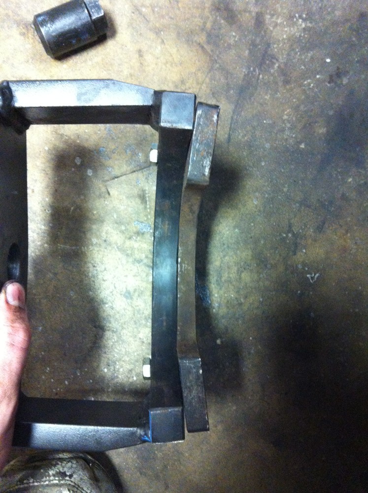

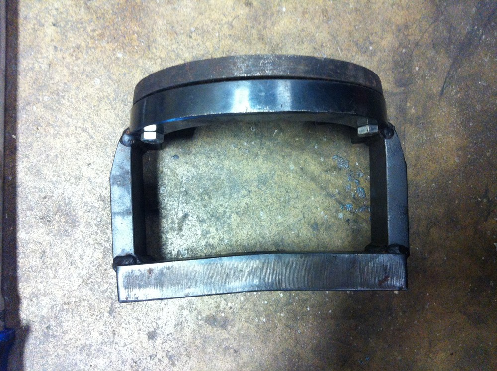

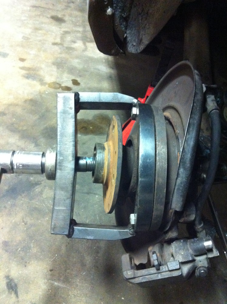

            Pulled out the $300 Sir Tools B90 kit. After some cranking, I ruined the tool. Bent the 1" (yes, ONE INCH) steel plate. Also destroyed the ebrake, backing plate, brake lines, and everything else that is back there. I kept going, but couldn't get my 3' breaker bar to turn any more. The hub didn't budge.
            So, my only option is to swap in a new trailing arm, hub, bearing, ebrake, backing plate and axle, and hope the problem magically goes away. That's not going to happen for a few months, I'm leaving the car on jackstands and resuming normal life for now. I have no desire to continue working on the car at this point. It's not worth it at all.

                    It seems like you have the small axles - they can't even hold a stock m20b25.
                    Get the larger ones with a hump on the middle of the axle and you will be ok.
                    You might have to change the trailing arms if you have the small wheel bearings.
                    • kristov
                      • 222
                      #580
                      This is normal as the axle and 32mm nut is what is clamping the wheel bearing together.
                      I had the same issue with NEW bearings and thought something was wrong.
                      As soon as I put the axles in and torqued the nuts it was all tight and good.

                        #581
                        They held the 190whp m50 for 4 abusive years (including launches with slicks), and they had 300k miles on them. The rebuilt one lasted 20 non-abusive miles, and the nut was loose when I removed it. I don't think the axle is to blame here. The first one broke due to abuse, the second one broke because it was loose and something is wrong, with the hub and/or bearing. Or maybe the axle wasn't pushed in far enough, which would bind up the cv joint.
                        Ahh, I didn't even think of that. Well, I needed to get it out anyway, as the splines are jacked.
