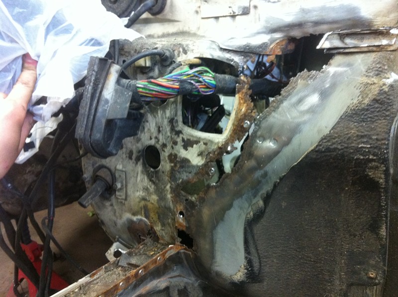

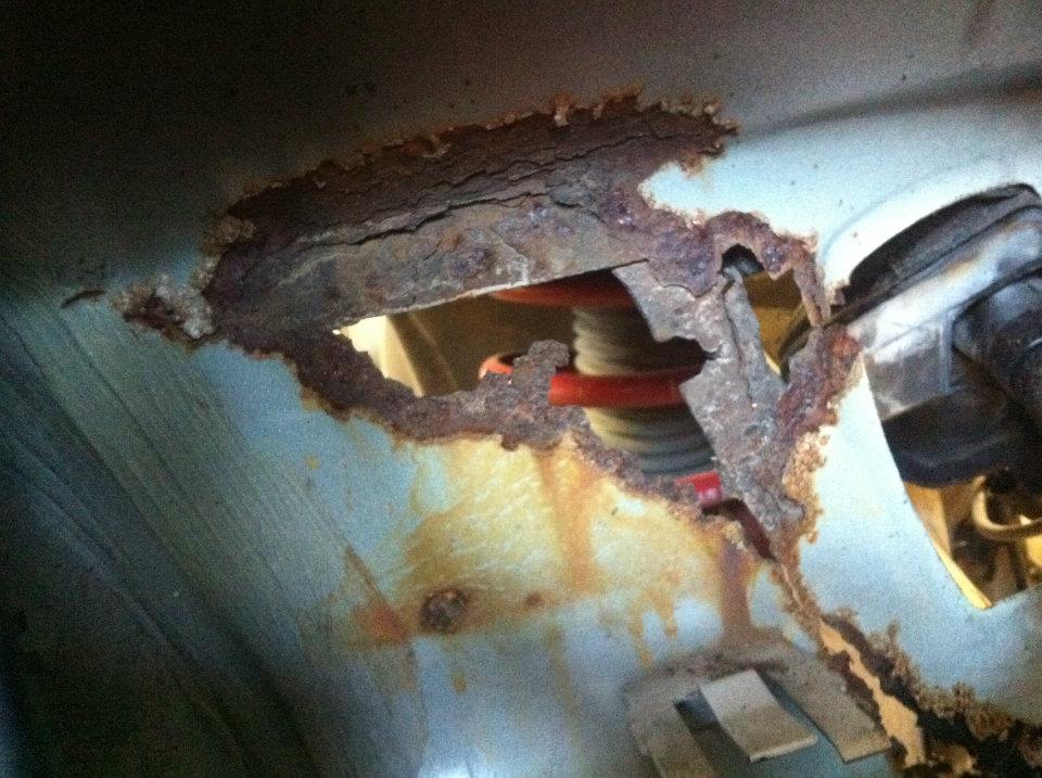

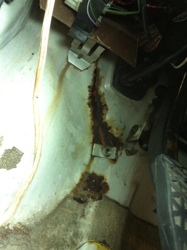

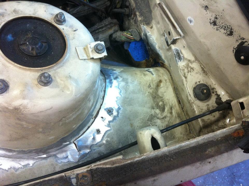

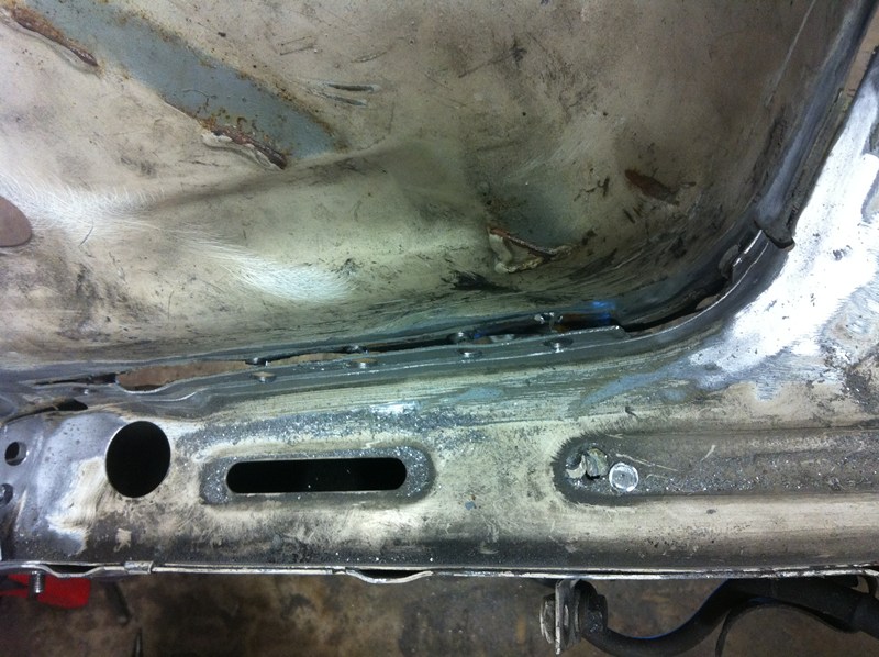

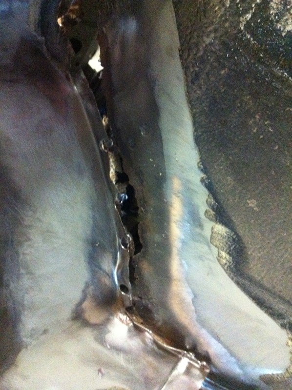

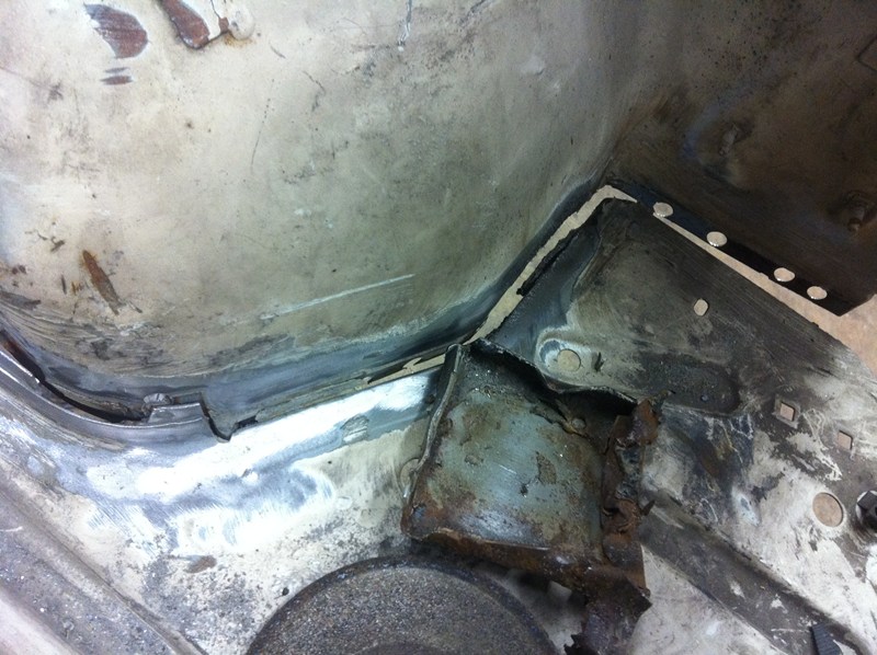

    The car was t-boned about 5 years ago, which was fixed by replacing the quarter panel. The fix was decent, but the body work is wavy, and the paint didn't match, so I want to address that. But more importantly, about a year ago, I noticed some rust under the floorboard, and the carpet was getting wet. Then the strut tower started cracking. So, I decided to tear the entire car apart and fix everything.

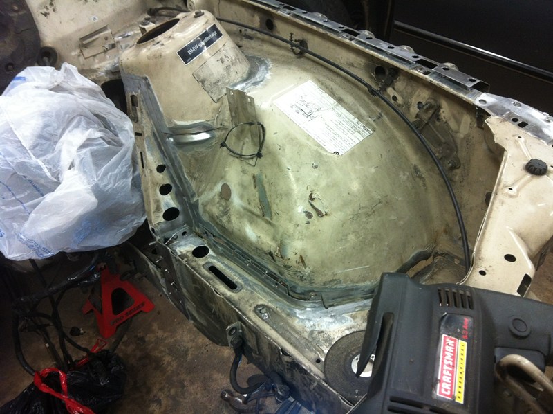

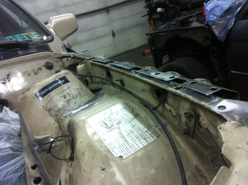

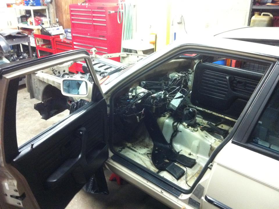

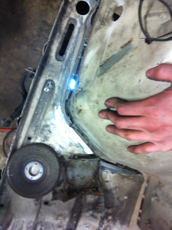

    I started on 10/12, and by 10/14, (2 hours each night, 6 hours total), I had the entire front and interior of the chassis stripped of everything but the wire harness. So far I did everything by myself, it's nice having some alone time in the garage
    I put about 10 more hours into grinding and stripping the area around the rust to get a better idea of what I'm working with and how I'm going to repair it. And that's where I'm at today (10/18 ). Here are a few pics of the teardown and some of the rusty spots.

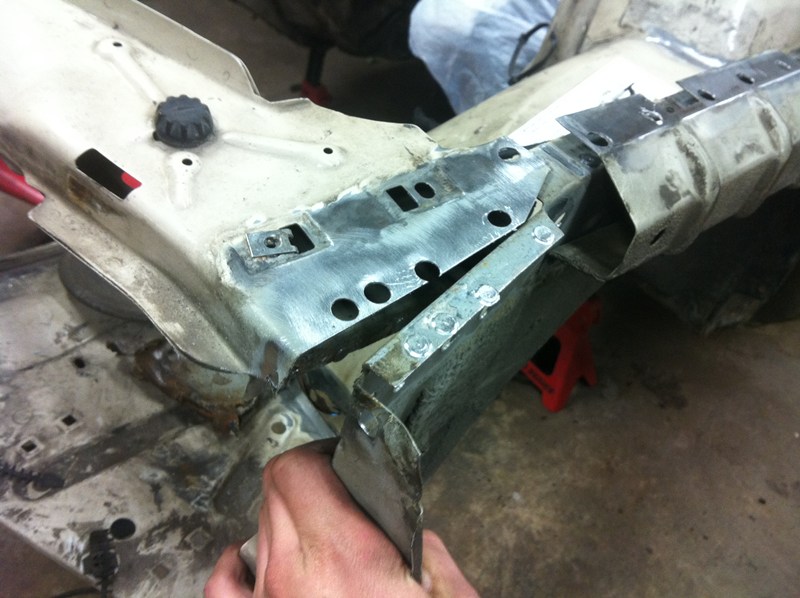

                    So I began the process of stripping the seam sealer around the edges to locate all of the spot welds. There are a LOT. I've been researching various spot weld drill bits, and am still undecided, but I think I'm going to give the harbor freight hole-saw style tool a shot first since it's so cheap. If I get frustrated I'll move up to an Eastwood bit (Eastwood is across the street from my work). If that doesn't work maybe I'll try the Blue Point bit.
                    This is going to be incredibly time consuming, but is really the only correct way to repair this rust. While I'm in there, I'm going to make the radiator support removable, so I can unbolt it as needed.

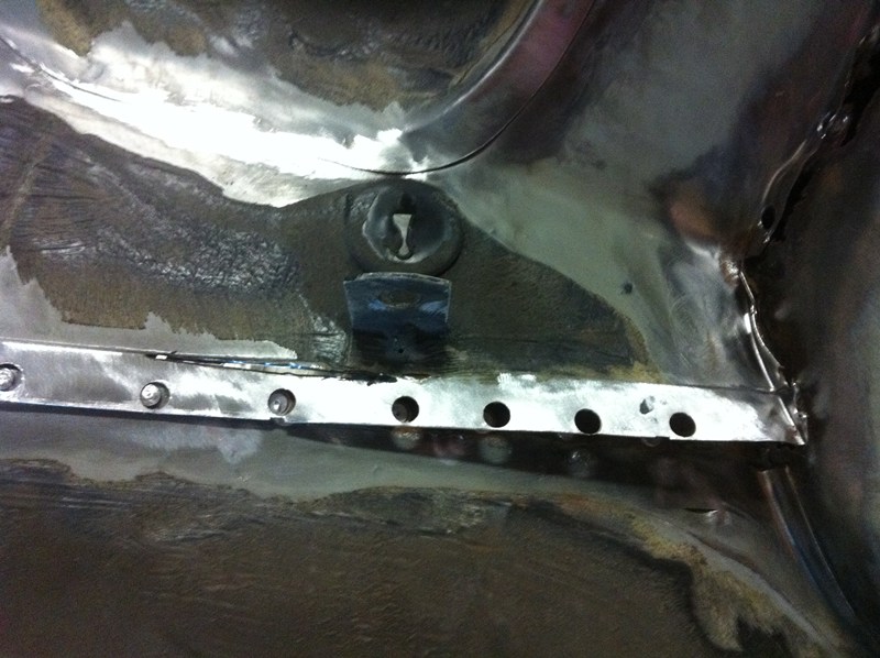

                      Picked up the Harbor Freight spot weld drill bit. It's nice to use. Just use a hammer and punch to put a nice dimple in the center of all the spot welds, then go around and drill them out. The drill bit is a whole saw, with a spring loaded centering pin in the middle. So you push it in slowly, the pin keeps it centered, and the pin retracts as you push further. You have to use very light pressure and keep the drill speed slow, or else it hops around.
                      The goal is to put the hole in the metal that you're removing, and leave nice solid material in the metal that's staying on the car, so you can re-spot weld it. Doesn't always work that way though, as there isn't enough room to get a drill in the tight spaces, so you have to get it from the other side. It seemed like 75% of the spot welds, I had to put a hole in the good metal. Oh well.
                      Here's the bit:
                      And here is the strut tower housing, with about 80 spot welds drilled (I'd say there's another 10-15 very difficult to reach ones left before it's ready to be removed).
                      It is amazing to think the entire car is basically held together by thousands of these tiny spot welds.
                      I'm going to be spot welding the new panel in, then stitch welding all of the seams on the entire front of the car, then seam sealing the entire thing. Will be time consuming, but should make the front end strong enough to last a LONG time.

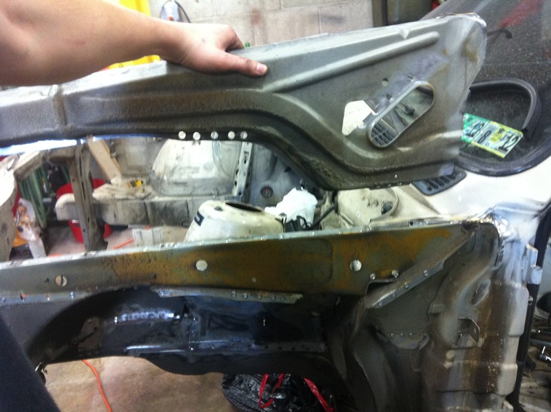

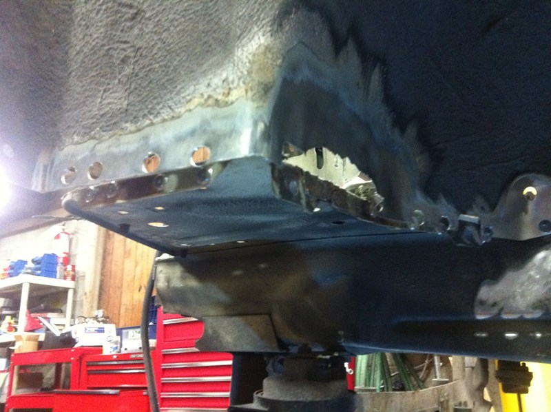

                        The old strut housing is finally out. I also carefully cut the side support out. I now have MUCH better access to the rust. Looking back, I can't believe I even considered trying to fix this without removing the strut housing.

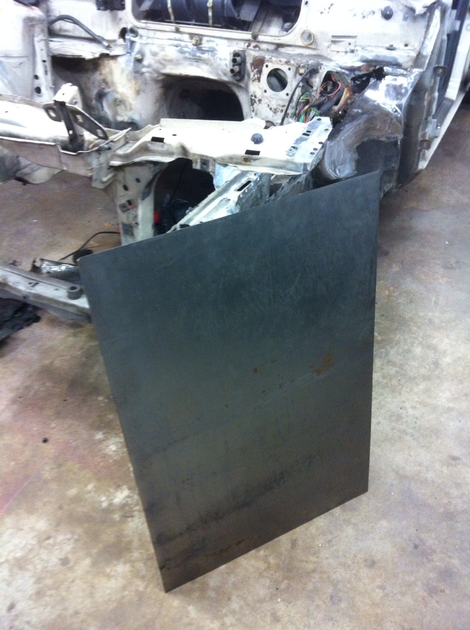

                              The past few days I just did some supplies gathering. Picked up a set of ball peen hammers, body hammers and dolly's, some welding magnets, an auto-darkening welding helmet, brushes, wire wheels, etc... Also grabbed a sheet of 20 gauge steel. $6 for a big 2'x3' sheet, gotta love the local Mennonite shops!
                              So, now I have to learn to use these tools, lol. I've done a few small things, but nothing of this scale, where structural integrity actually matters.
                              The size of this project is finally starting to sink in, and I'm beginning to lose hope that this will just be a winter project. There is a lot of rust. I started digging in to the passenger side and although it's not as bad, there's still a lot of rust. At any rate, it's going to get fixed, even if it takes me into next summer.
