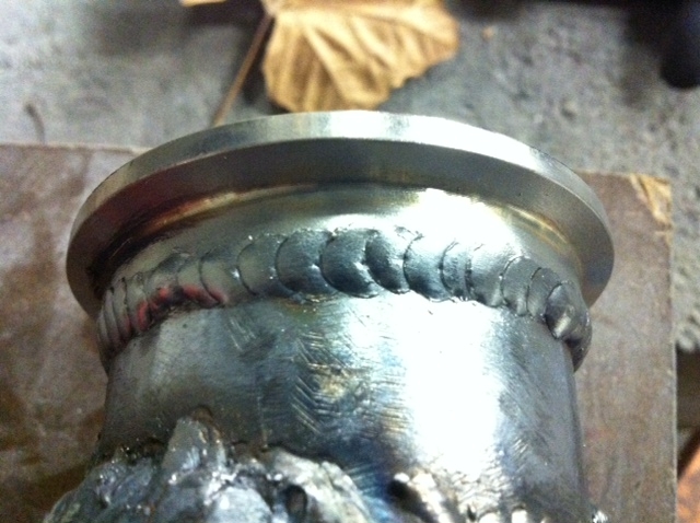

      My exhaust welding looked exactly like yours, that is why I made the front end removable so I could remove the whole unit to fix the welds..!!! The auto box is a monster size so getting the engine/box out as a unit is a mission with the front end in place. This was early in my build, engine out to sort the exhausts...

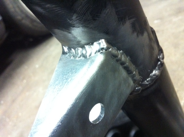

        Today was productive. Welded on v-band flanges on the manifolds

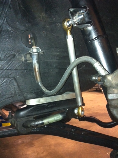

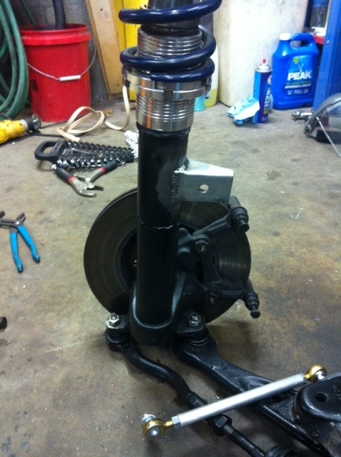

        Also got my adjustable end links and strut mount tabs installed:

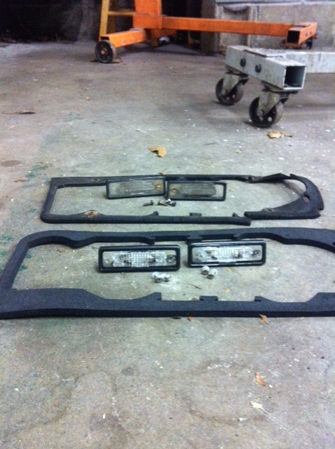

        Also put some new tail light gaskets and license plate lights in (old junk parts in the back, fresh parts in the front)

            Funnily enough, the LHS (passenger to us) was almost a bolt-in for the standard e32 exhaust manifold, just a minor tweak to the end of it necessary. The RHS (driver's side) was a mission!!!! Had to put a flange joint into the rear 2 cylinders so I could install the manifold with the steering shaft in place.
            Your welding is improving I see.. practice makes perfect! Looking good!! :D

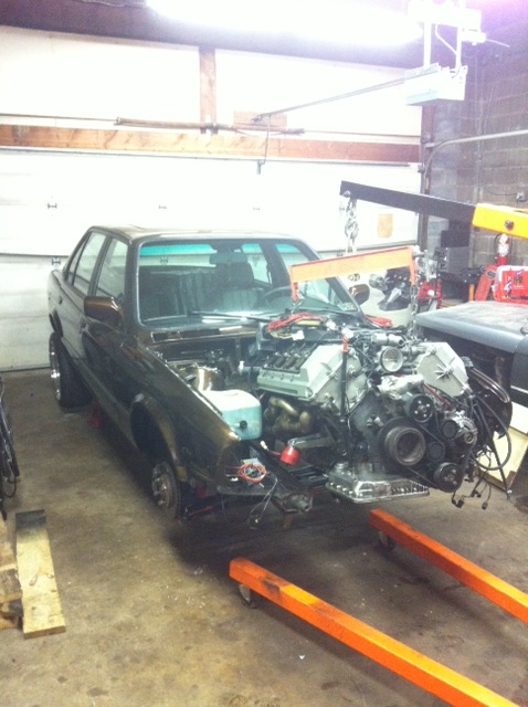

                    While the engine is out, I'm going over some little things that I knew needed attention. But, there are some things I didn't even know about that need attention, such as this...
                    The oil pan must have been resting on the steering rack. Not sure if this was from before or after I installed the urethane mounts. I'm going to put a small spacer on the mounts just to be safe.

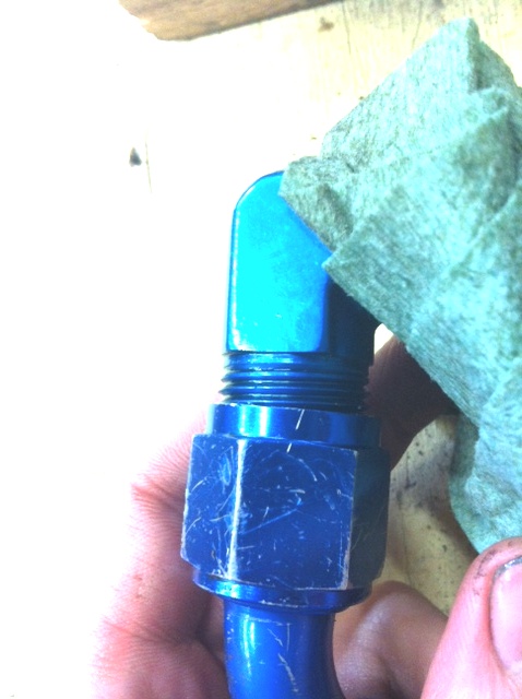

                    This is $50 worth of cross-threaded AN fittings. I ordered new ones and will be very careful in the future. It kind of sucks that it happened, but if this is what is causing my oil leak and the new fittings fix it, I'll be very happy.

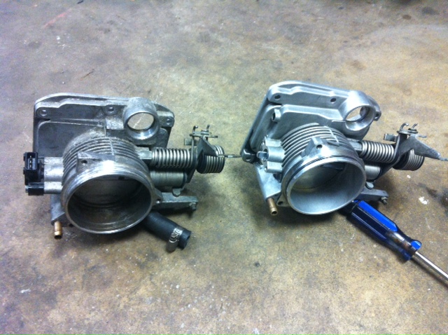

                    I also picked up an m62b44 throttle body, as it doesn't have the huge wedge on the throttle plate to block airflow.

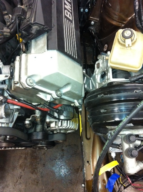

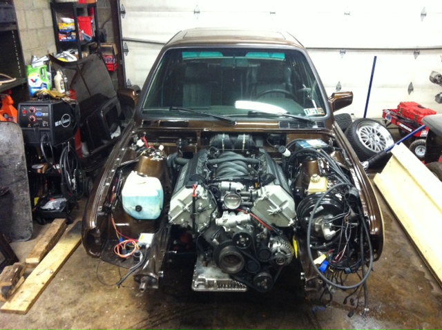

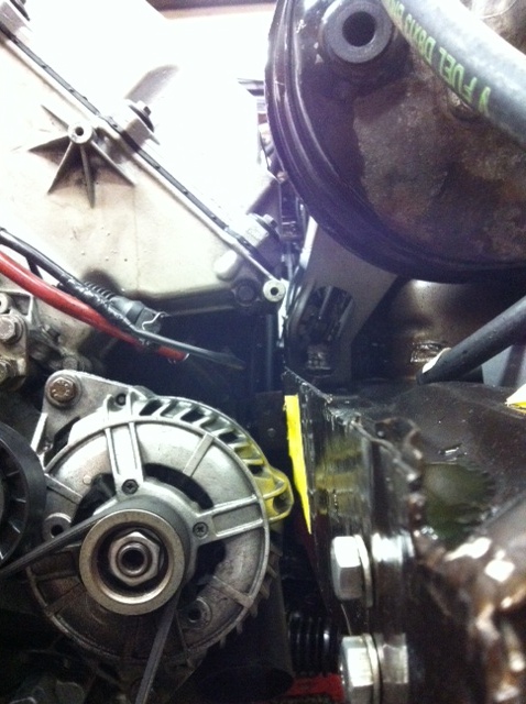

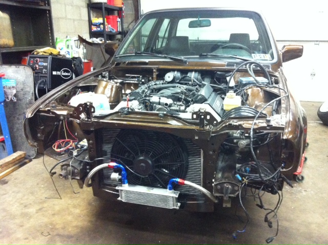

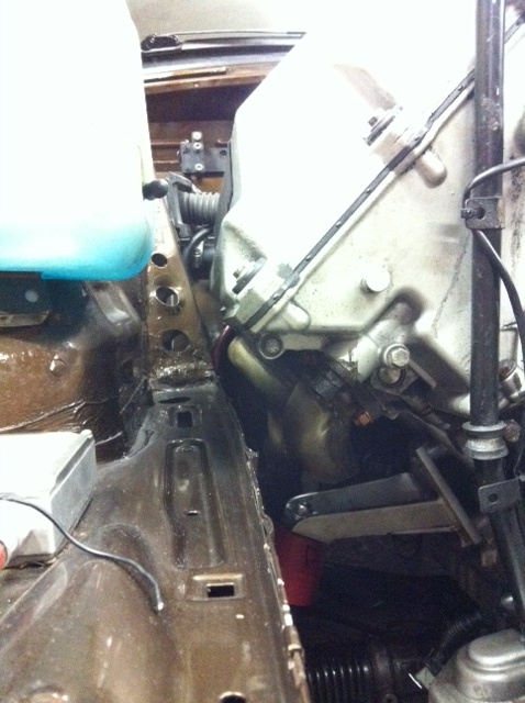

                      Got the engine back in this weekend.
                      I can't get over how little clearance there is...
                      Made some new fan and oil cooler mounts, much more durable and better fitting then before, then got that stuff installed and wired up.
                      The only thing left to do is reinstall the P/S reservoir and hoses, reconnect some wiring near the DME, then add fluids. I'll do a test fire of the engine, then reassemble all of the front end parts (lights, grilles, bumper, valance). Then it's time to build the exhaust system from scratch...
