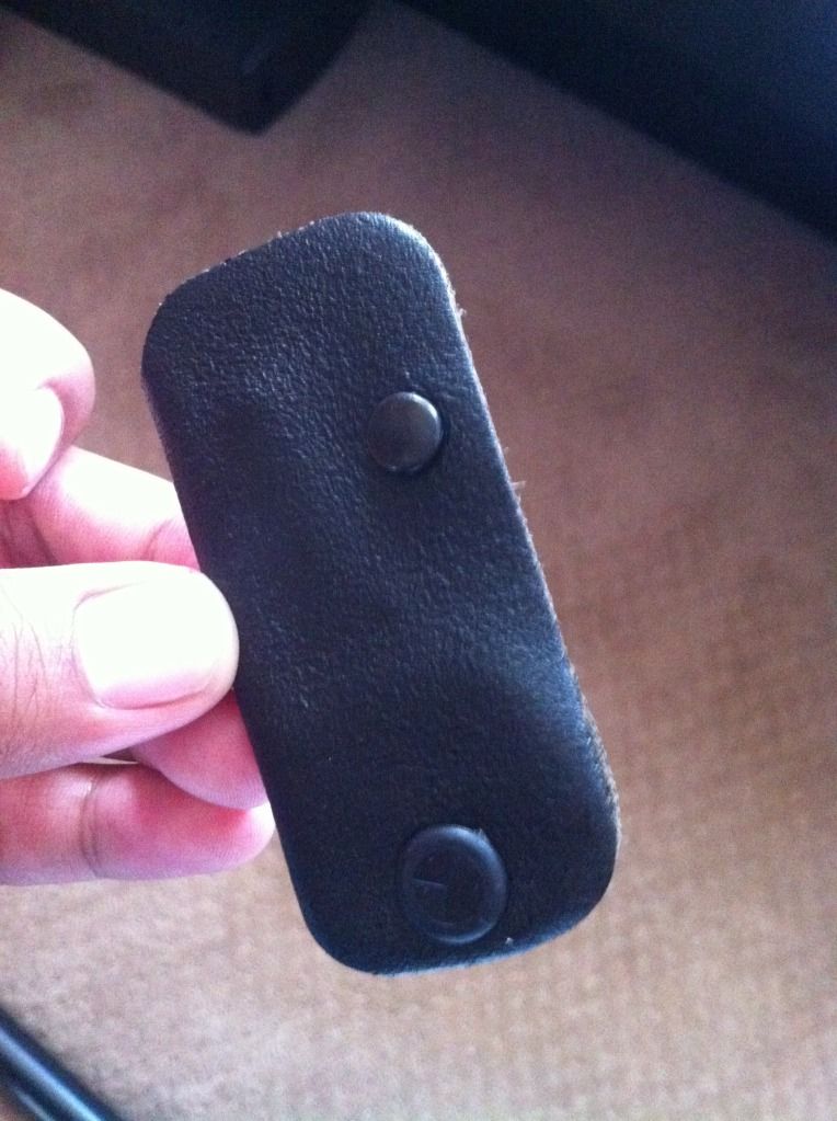

        #198

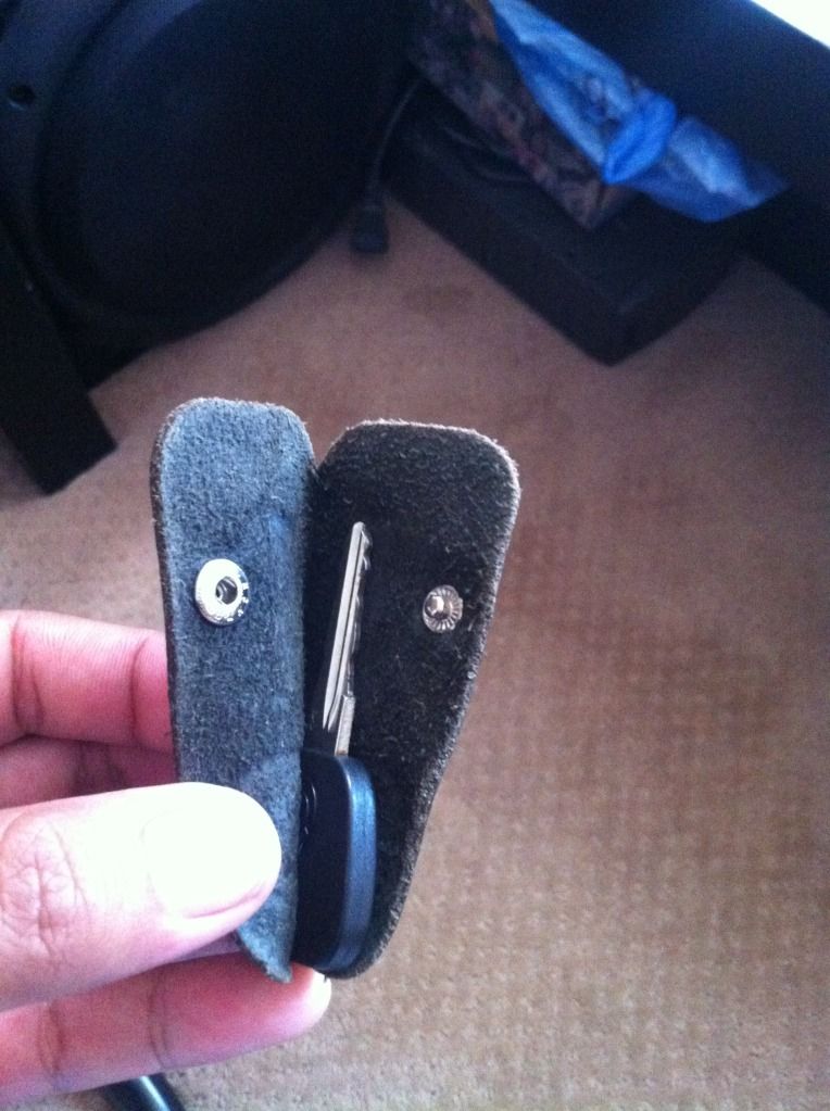

        Has anyone seen this kind of key case before???
        came with the car when i got it... looked brand new... found it in the glove box inside the owners manual...

          #199
          Oh my god! What a throwback!!
          My aunt had one of those for her 91 318i when I was a little kid.
          I used to play around with that thing all the time, as a lil' kid.

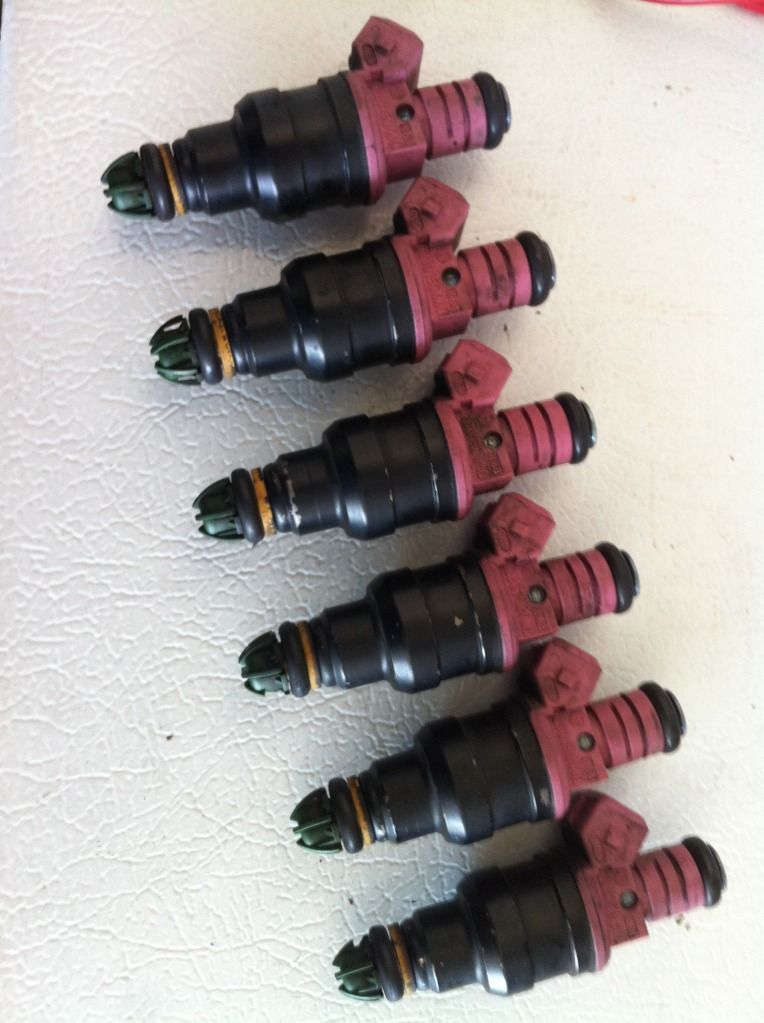

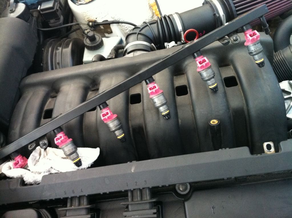

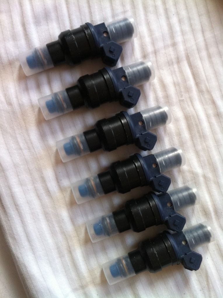

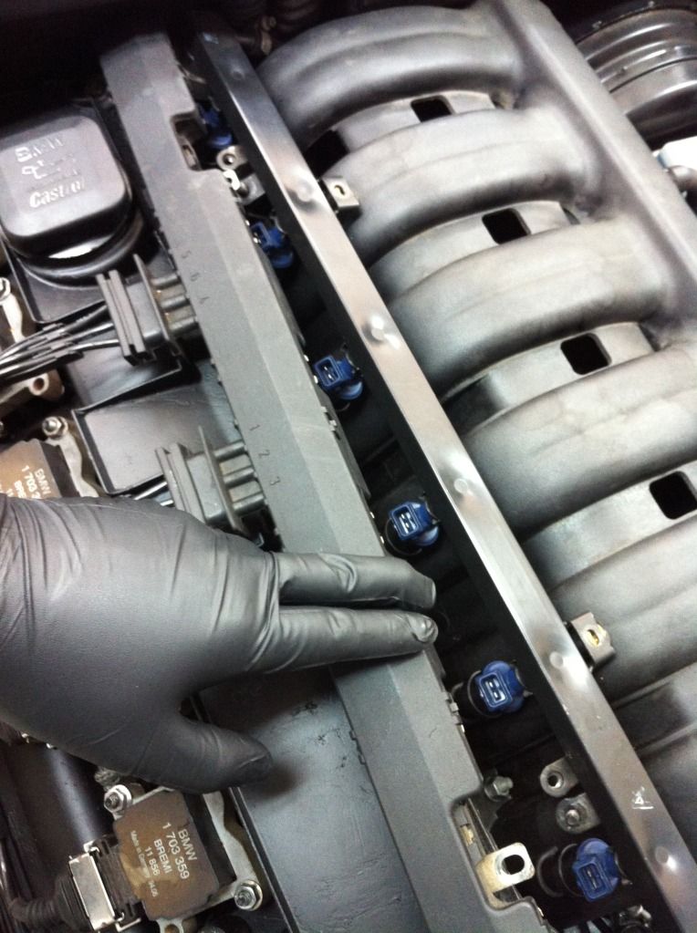

            RE: Let's do the Engine!
            Replacing Stock 21.5# to Bosch 24# injectors
            91' MtechII AW/SW BAR'd S52/SC

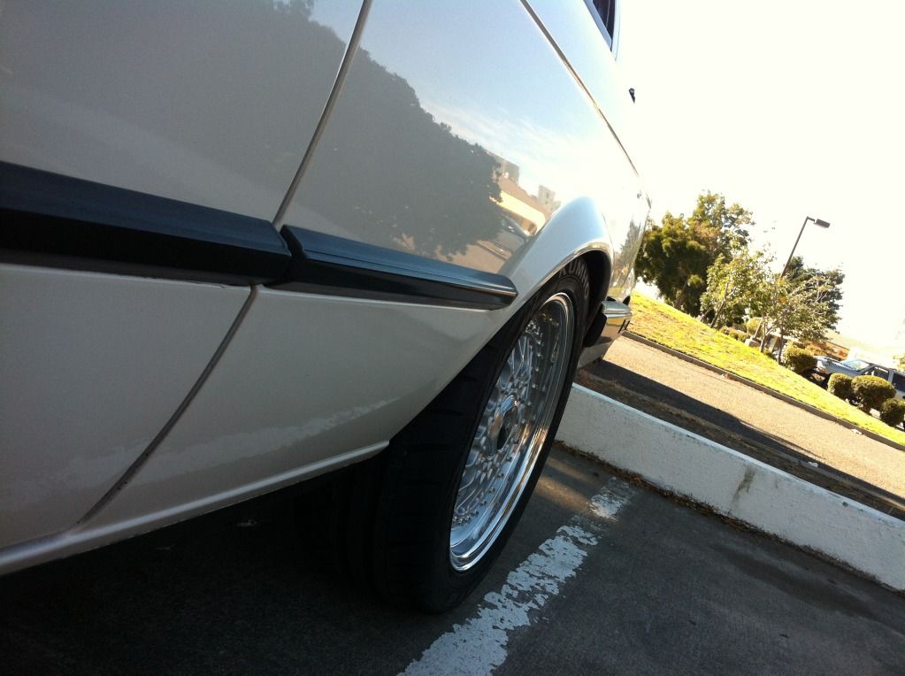

                  #203

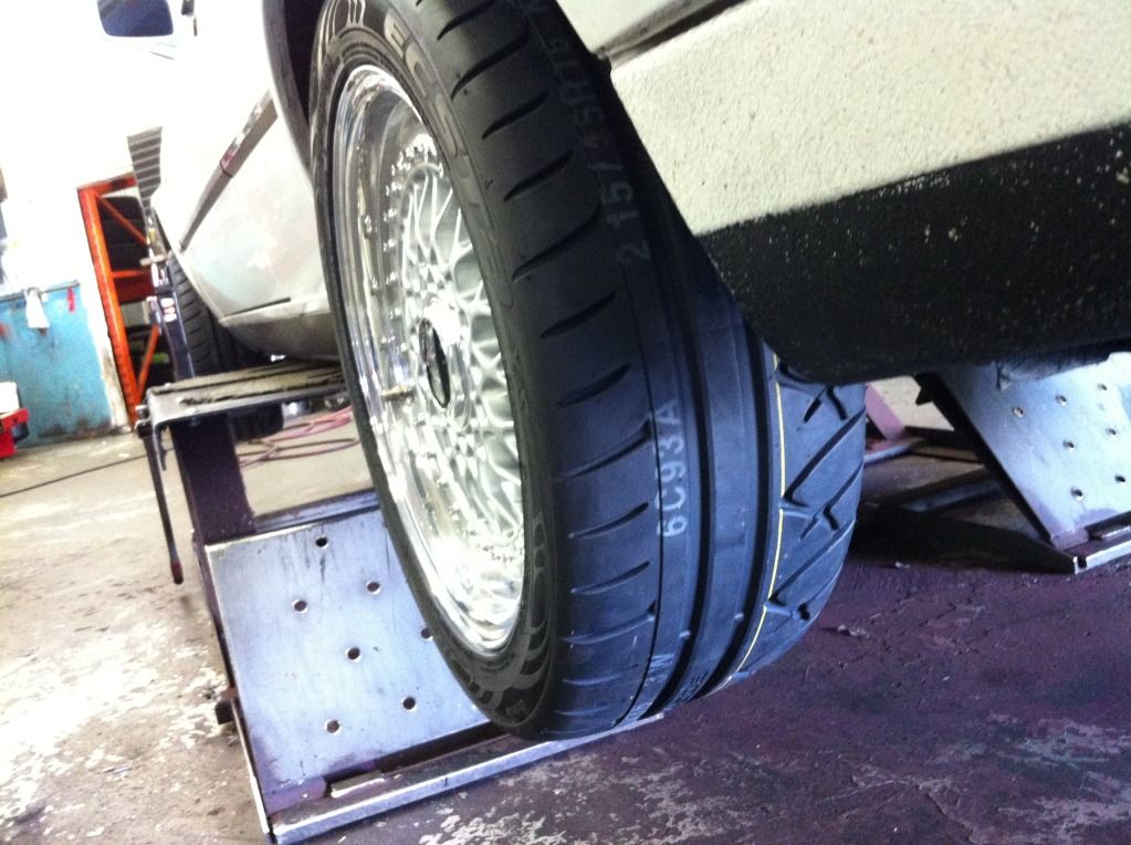

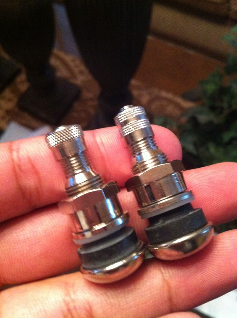

                  RE: Lets do the Suspension!
                  Refinished BBS RS 003 with quarter height caps and new BBS center and valve stems with BFI bolts on 215/45/16 Kumho XS tires...

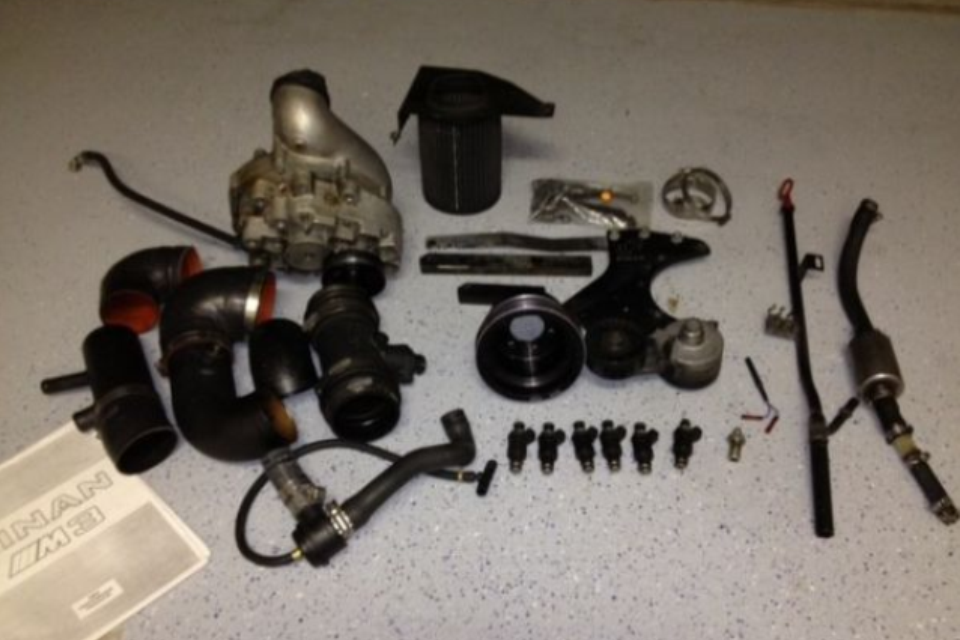

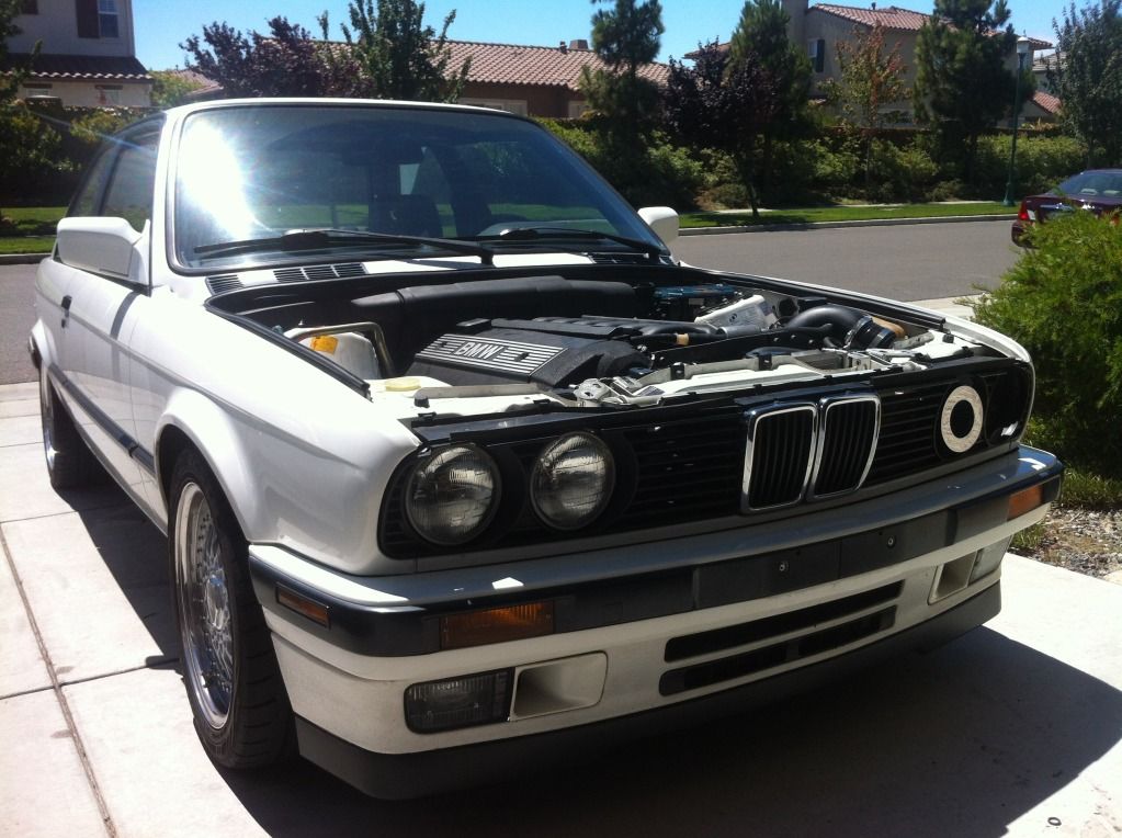

                    #204

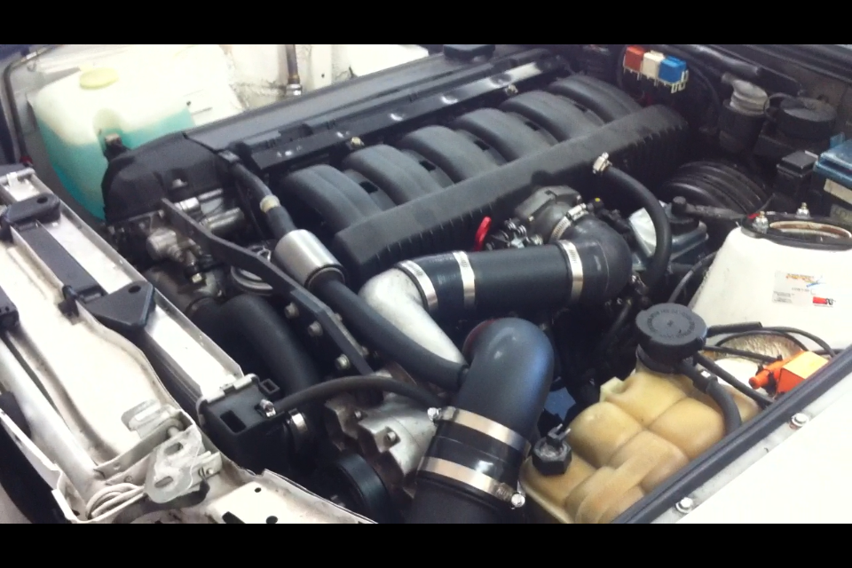

                    RE: Lets do the engine!
                    Complete Dinan Vortech-V2 Supercharger Kit, i am still using the original dinan mount and not a custom one, and i am still using ABS and just needed to relocated 3" to the driver side... a few more modifications needed to be done with the radiator and the intake as well as the dipstick tube as i am using an e34 oilpan and not the e36... the reason i picked this supercharger kit is because its the only kit on the market that is smog legal in california... im a lazy person and didnt want to remove it when its time
                    Still working on the intake placement
                    Carb sticker
                    COLD START VIDEO, CLICK ON PICTURE!

                      #205
                      Meaty tires are meaty! Any plans for spacers?
                      Looking mighty fine there
                      Edit: And boost too!!
                      Hero status accomplished: You have beat the e30 game and are now free to bask in your own awesomeness

                        #206
                        Love the wheels and the charger
                              no spacers, but wheel locks, yes.. 4 different ones for each lug lol

                                haha I would be super protective of those wheels too
