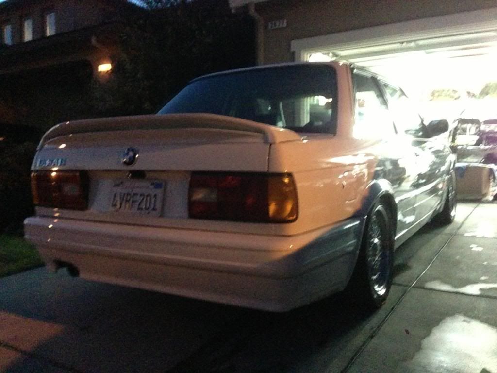

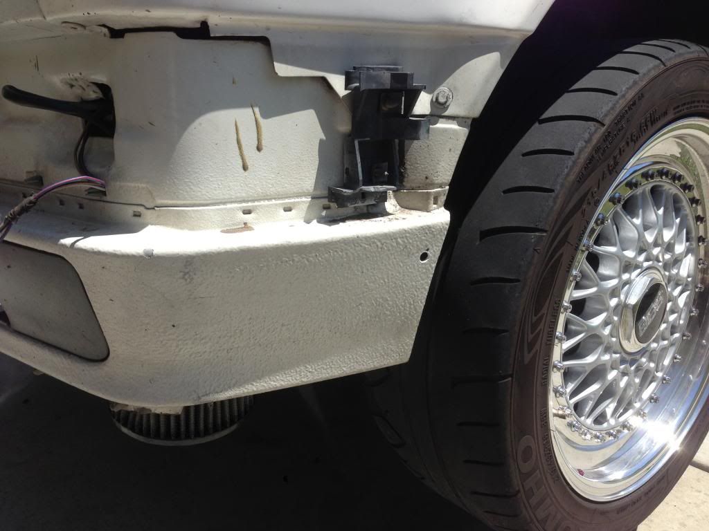

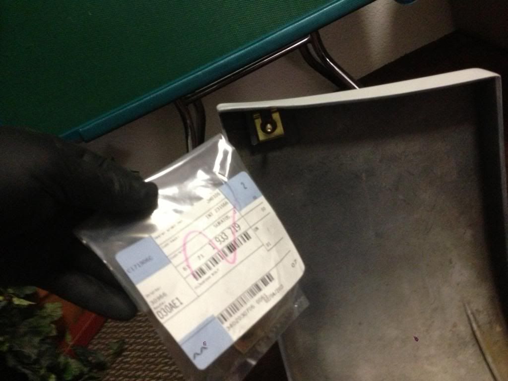

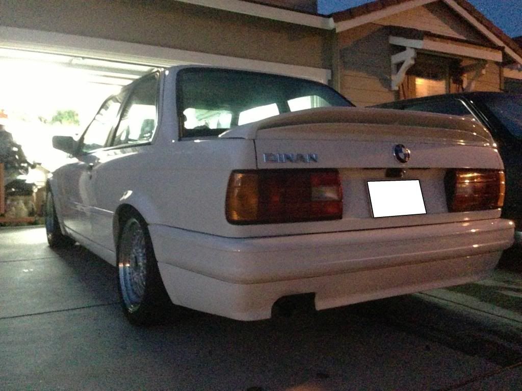

    Next was the rear bumper
    Had to remove the bracket plate that bolts to the back and switch it from the stock bumper bracket
    Comparison Left-Stock Right-Mtech
    Stock bracket installed on mtech
    Ready to be installed but first i wanted to paint my faded bottom trim
    And heat shrink the parking light connectors for protection as this kit deletes it
    Rear bumper installed

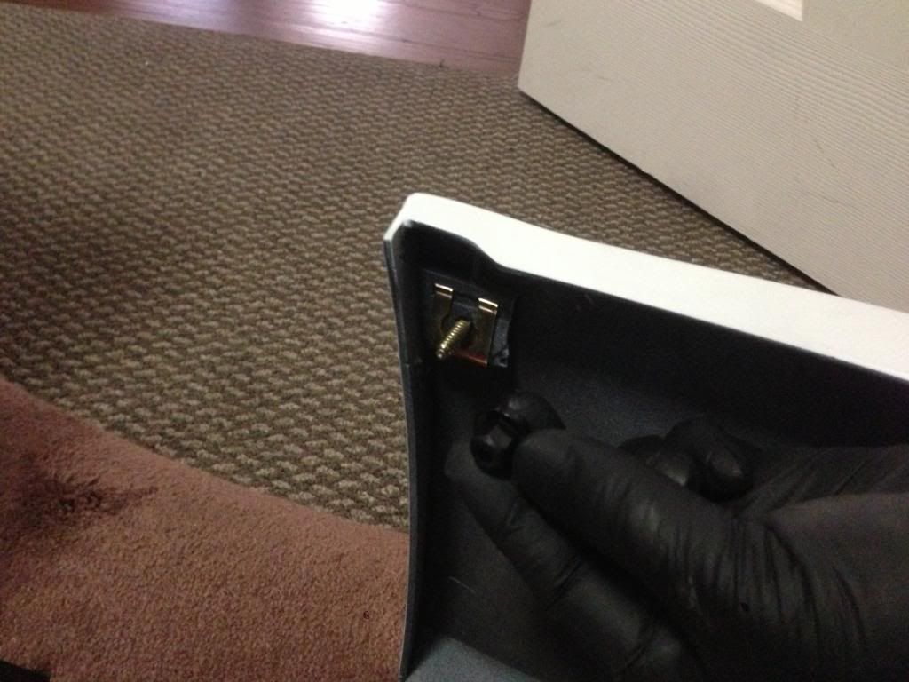

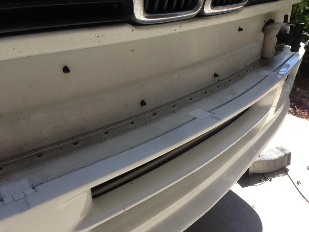

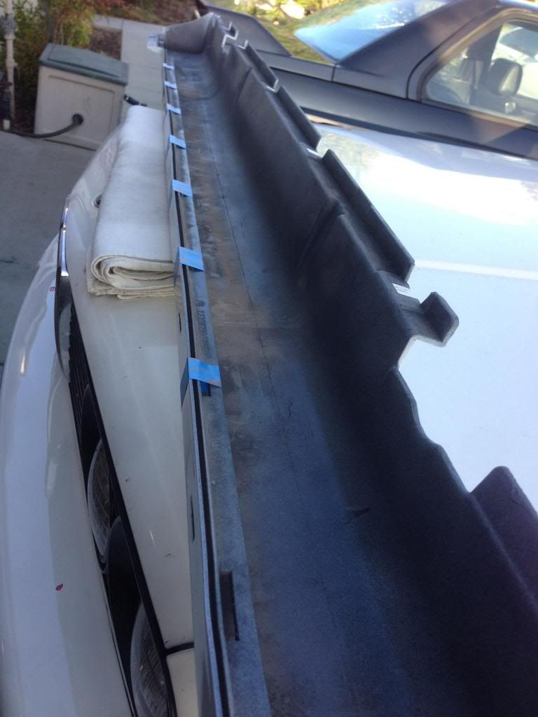

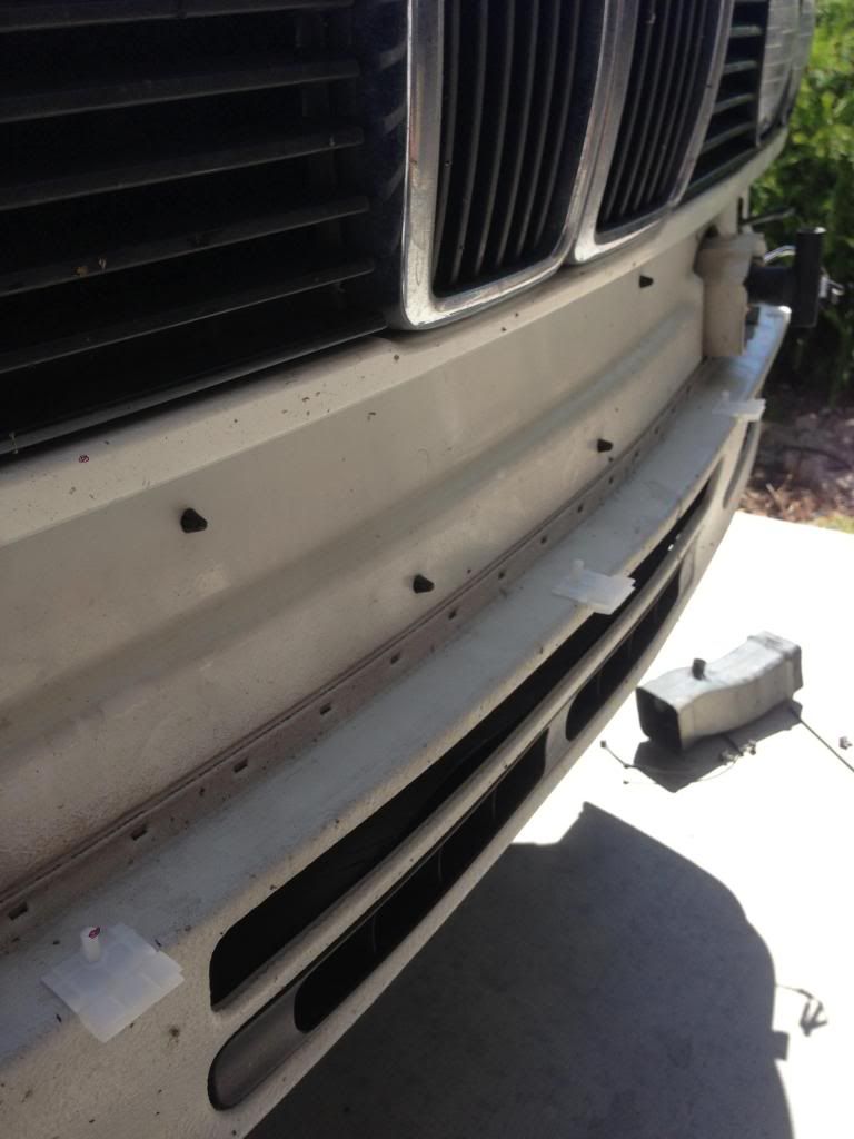

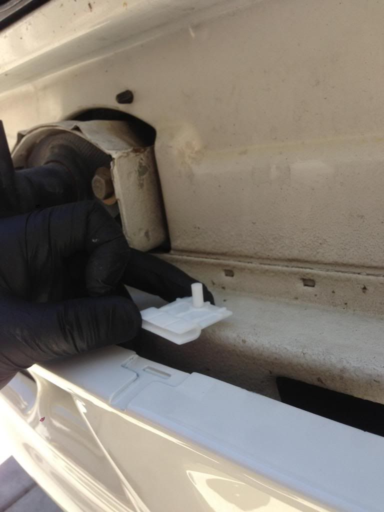

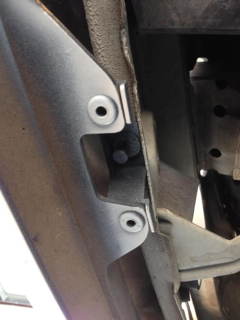

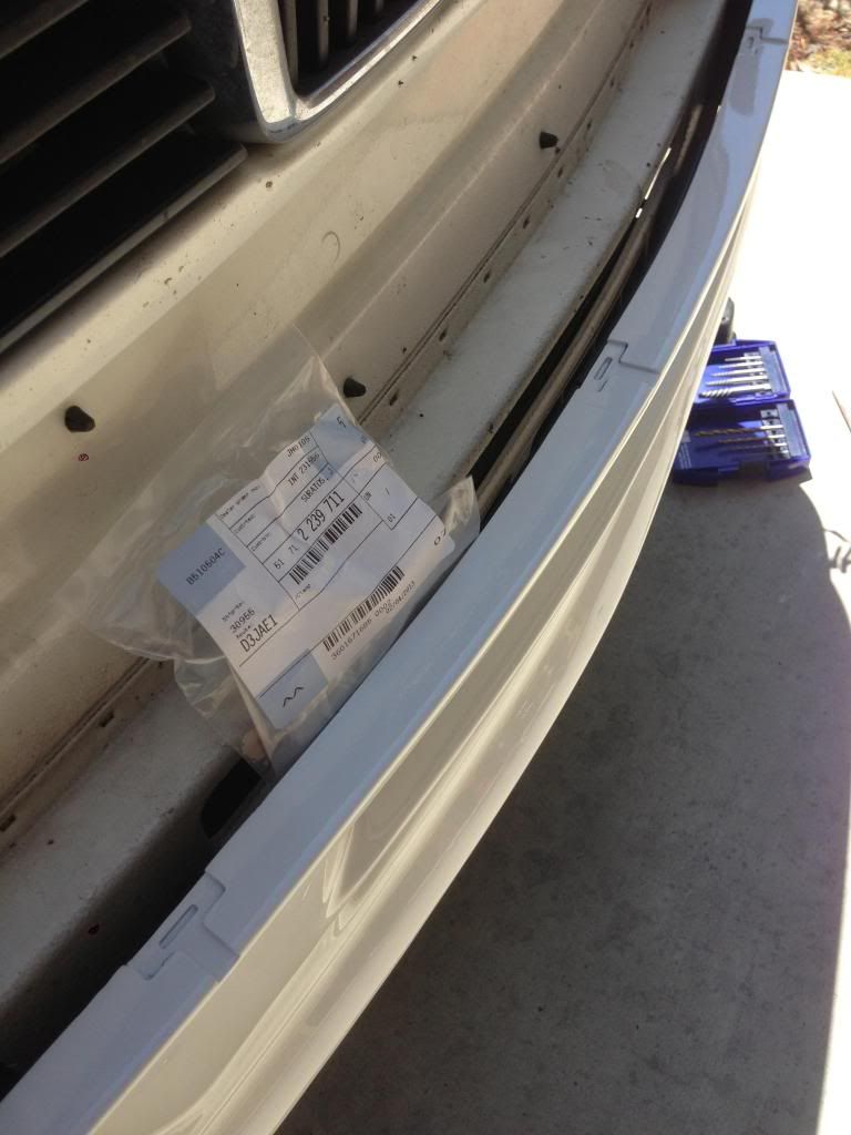

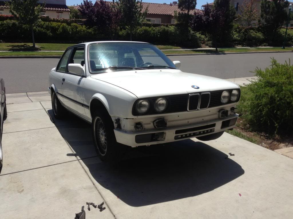

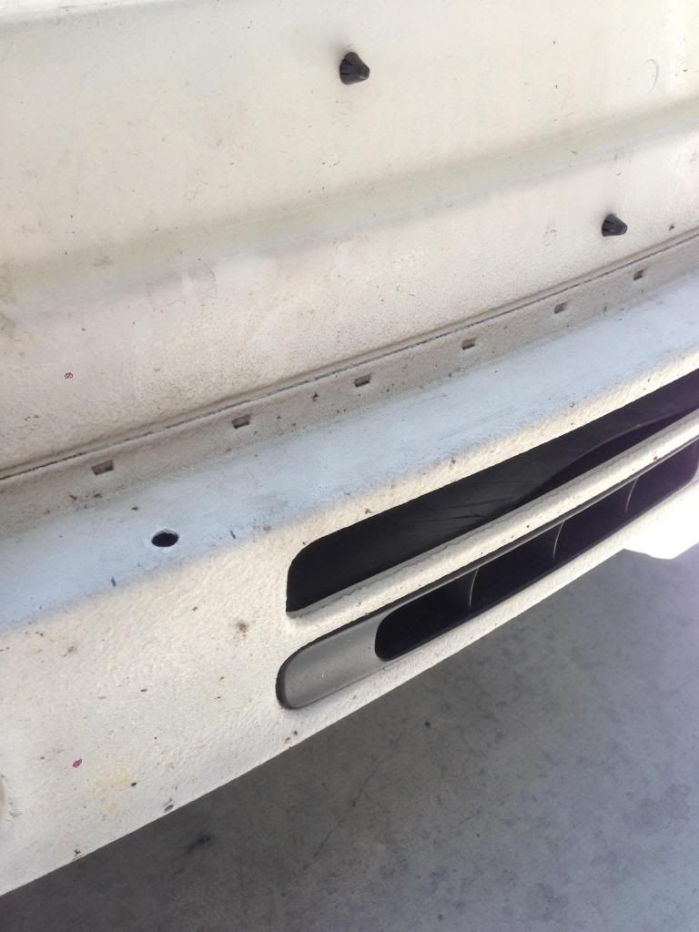

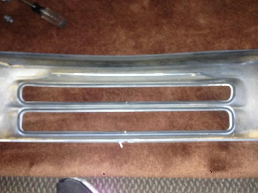

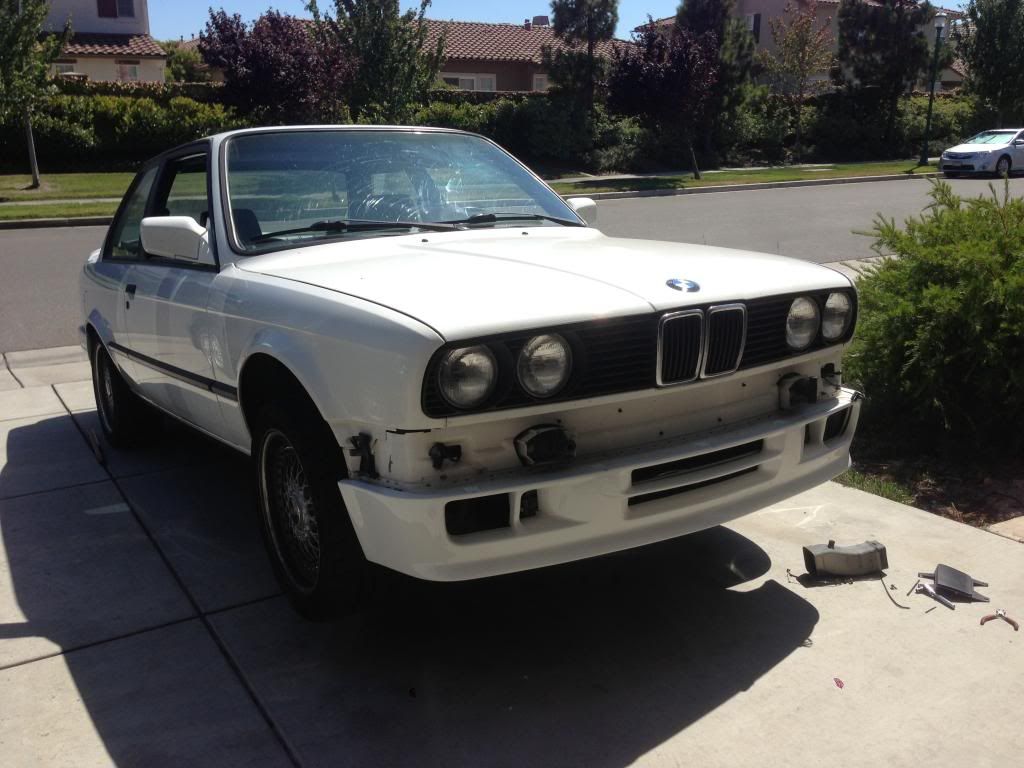

          Next is front valence and bumper

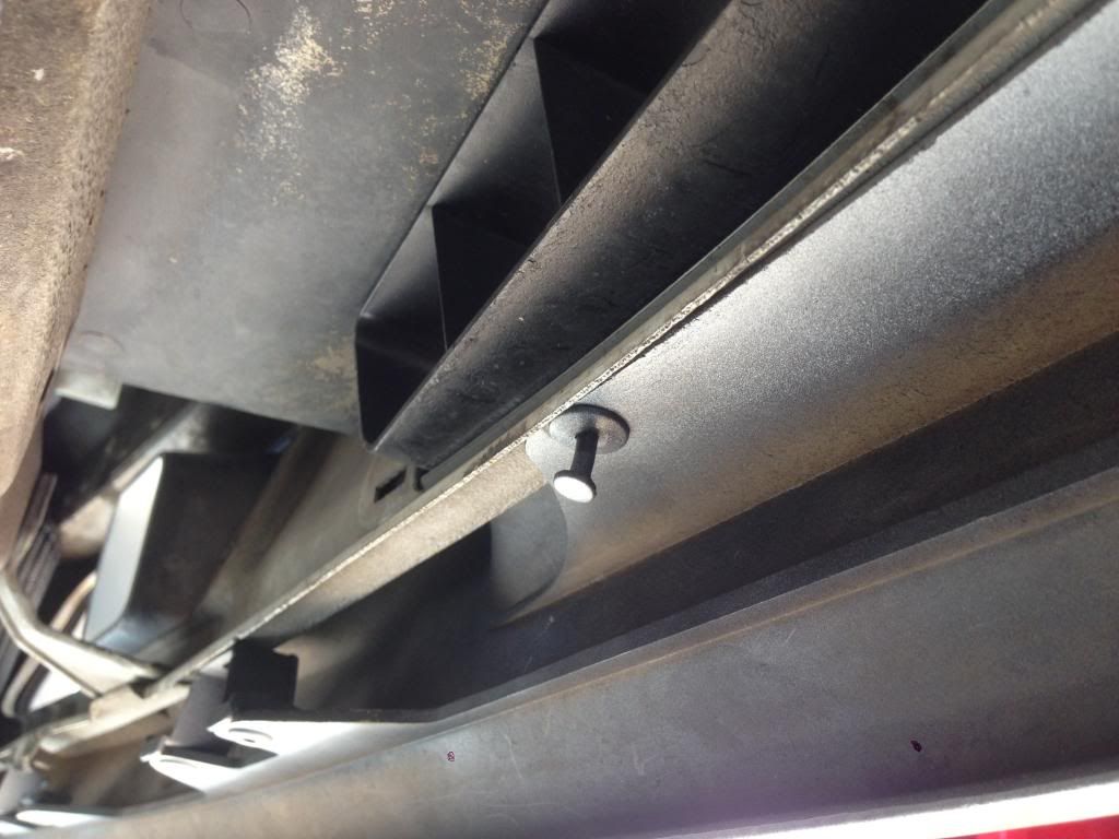

          Clips for the sides
          Rubber seals
          Drilled hols on both sides for valence clips
          Nut for the clip
          Top valence clips
          Drilled holes for the top clips
          Clips installed
          Bottom clips
          Valence finished
          Bumper installed

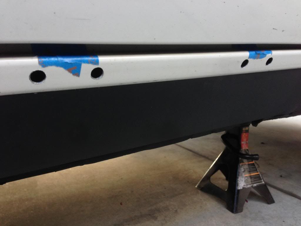

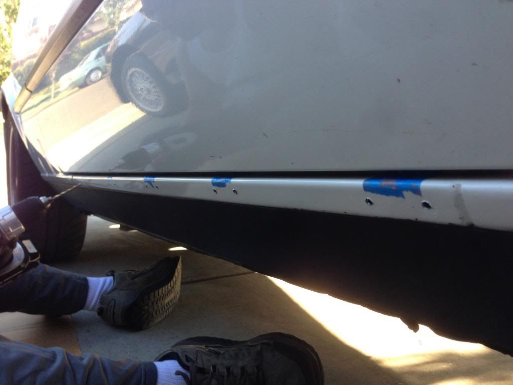

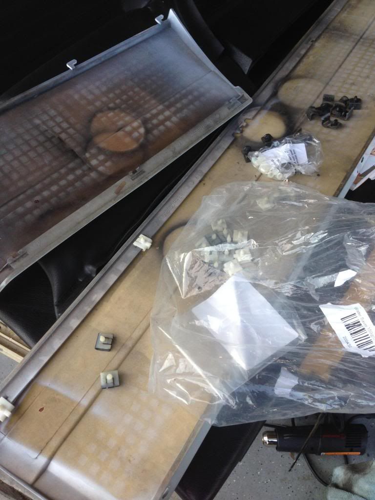

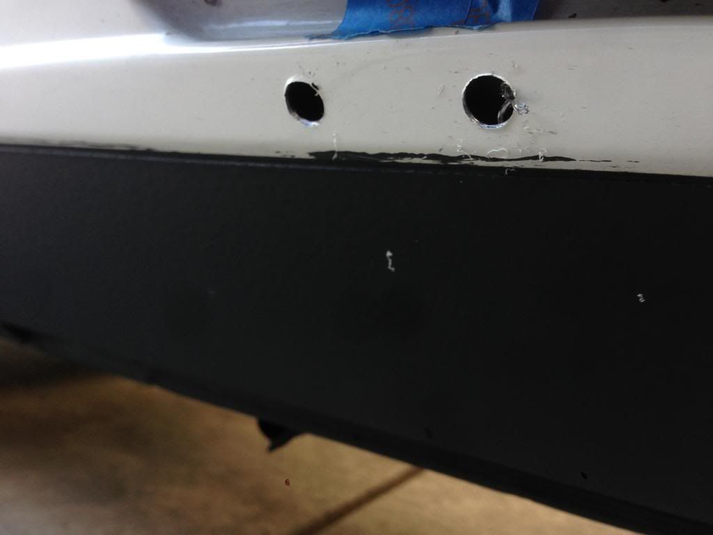

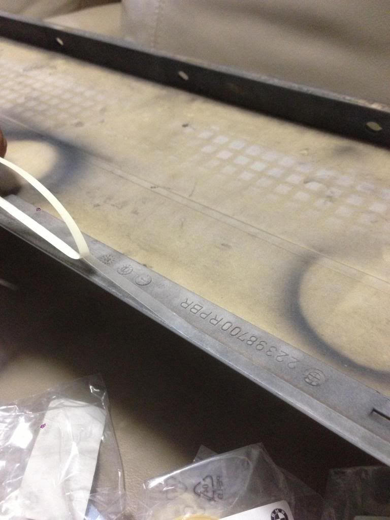

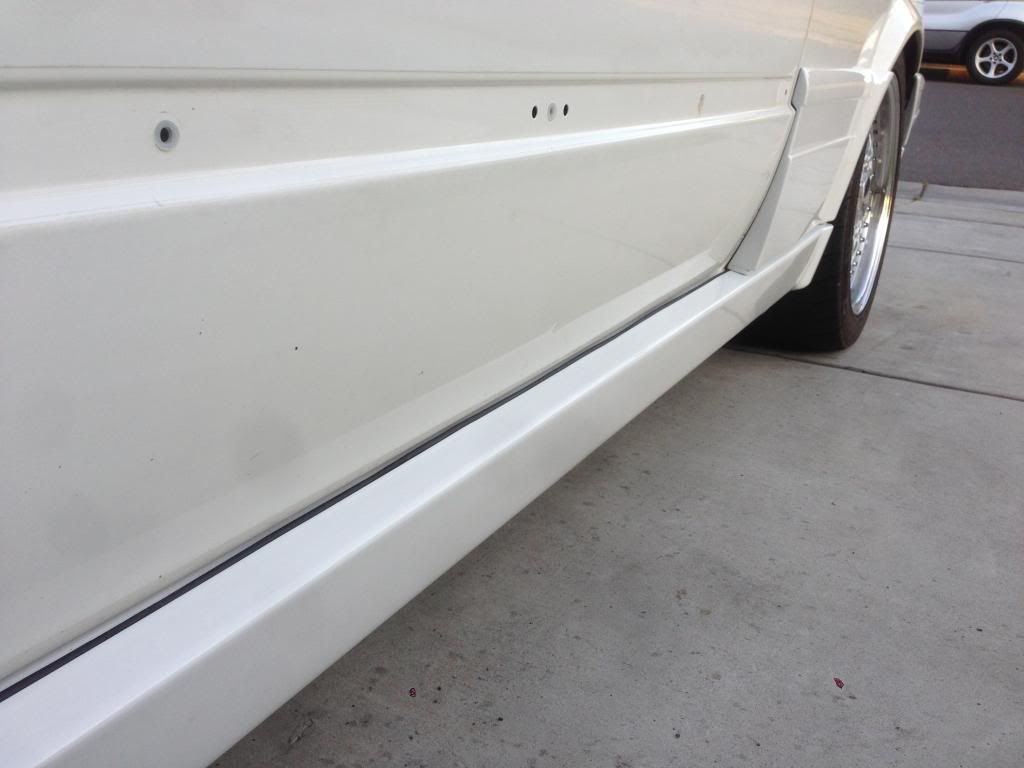

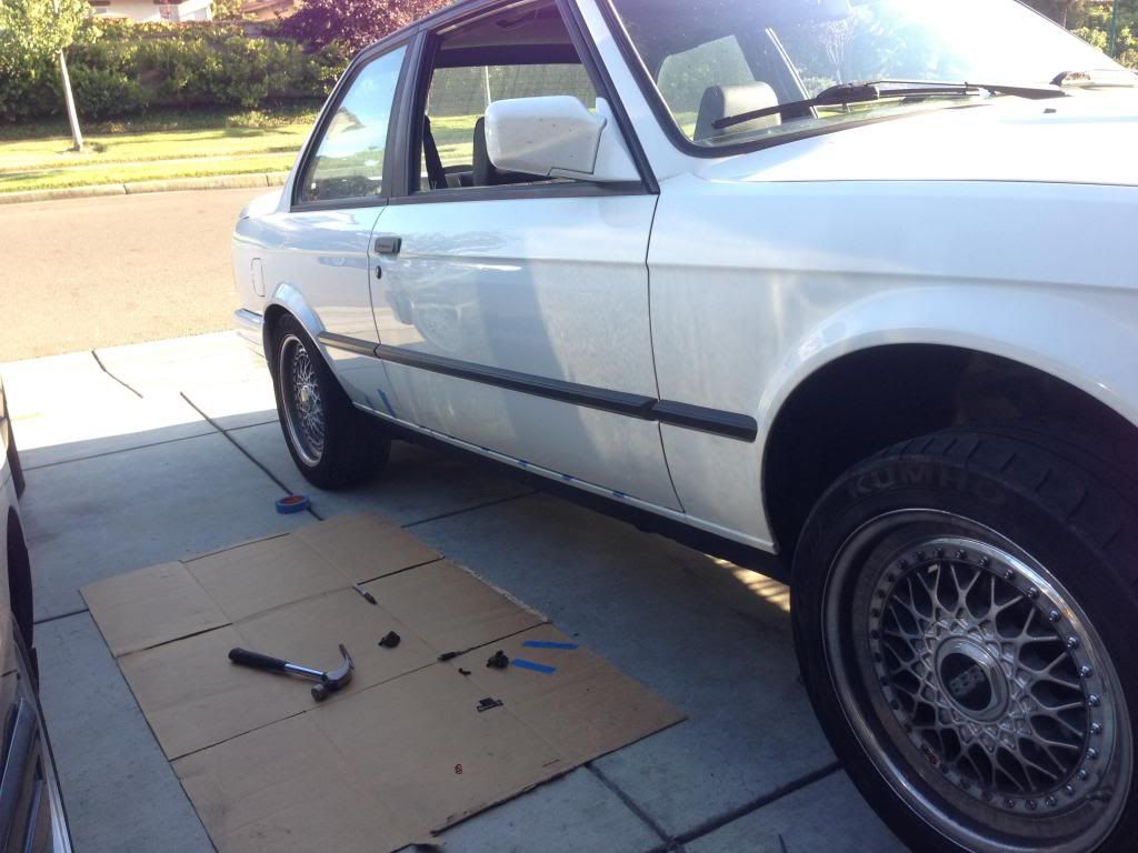

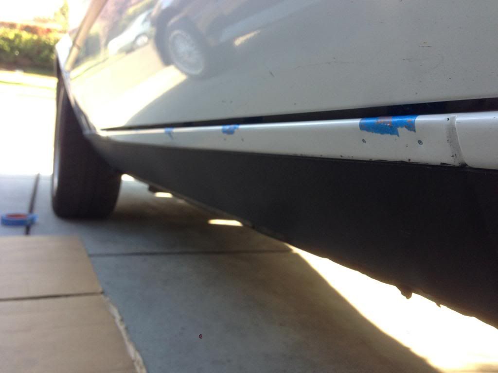

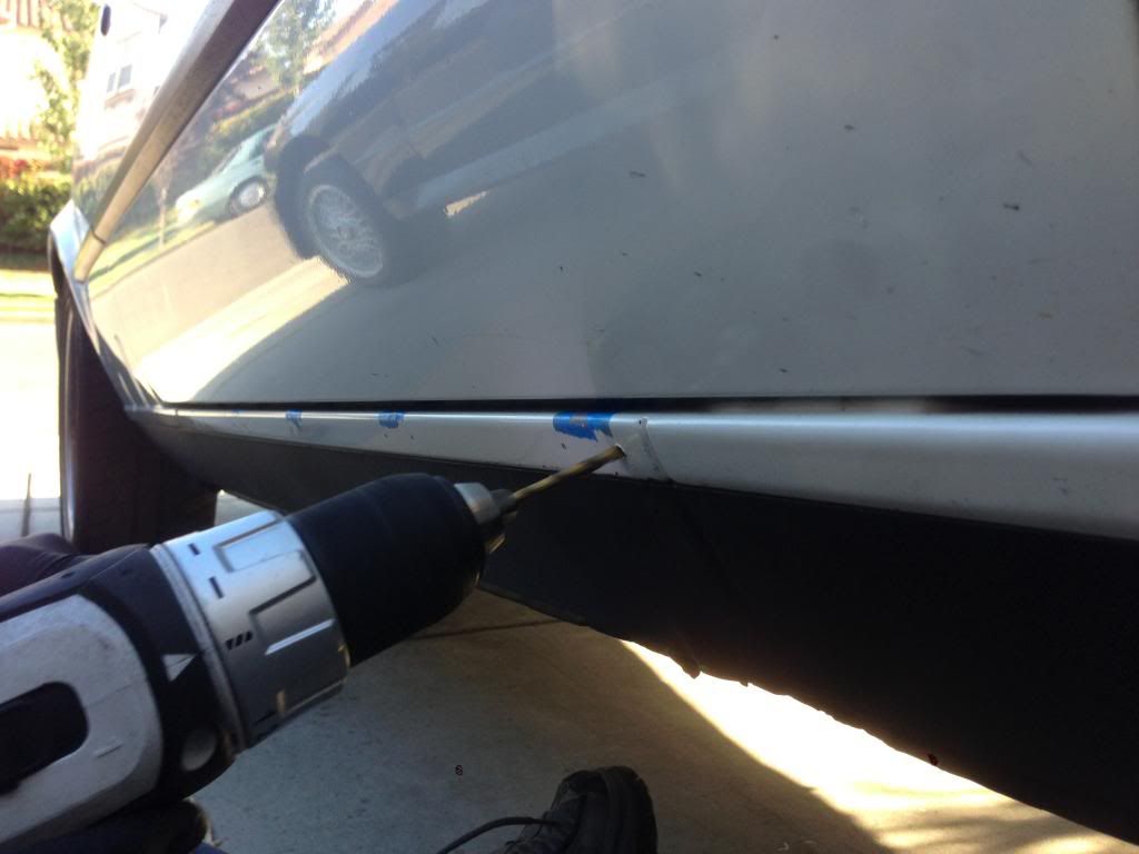

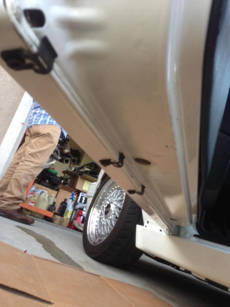

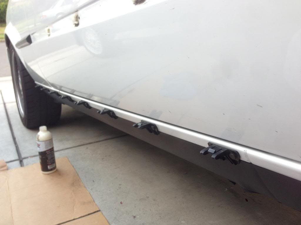

            Side skirts are up
            Started with clip alignment with blue painters tape and punched holes to prepare for drilling from template

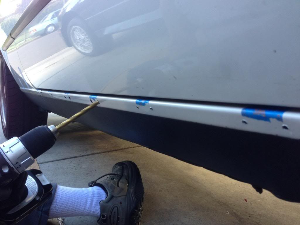

            First drill on the body! cant mess this up...
            Few more
            Bigger holes now
            Rough
            Sanded down

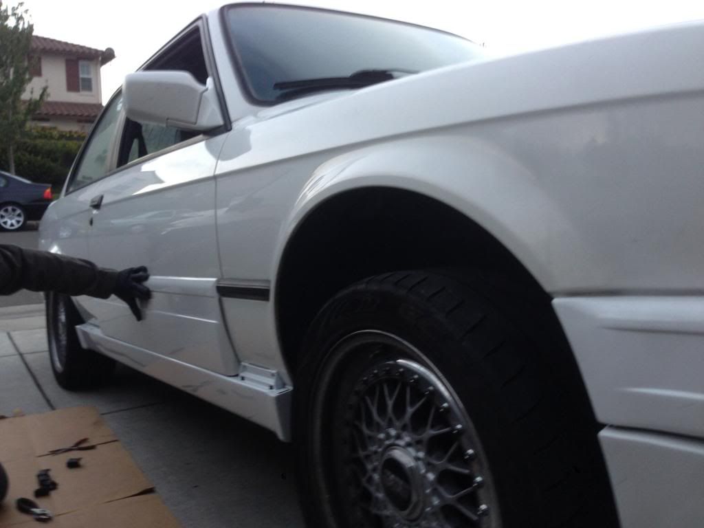

            Clips are on
            Side skirts installed
            91' MtechII AW/SW BAR'd S52/SC

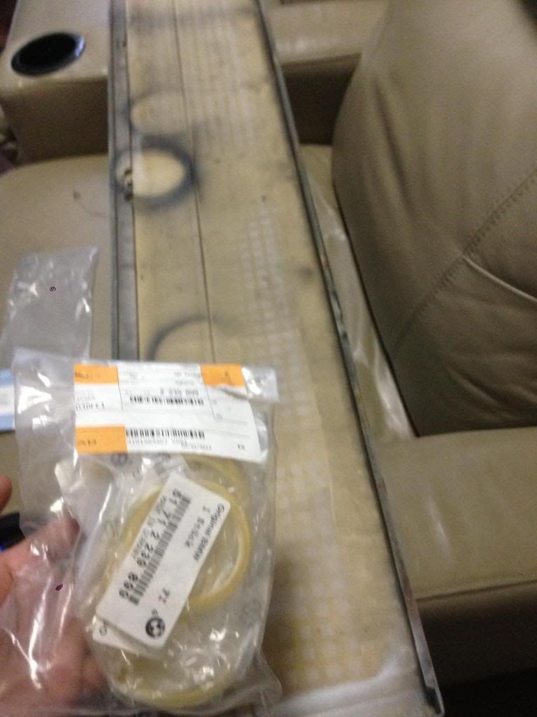

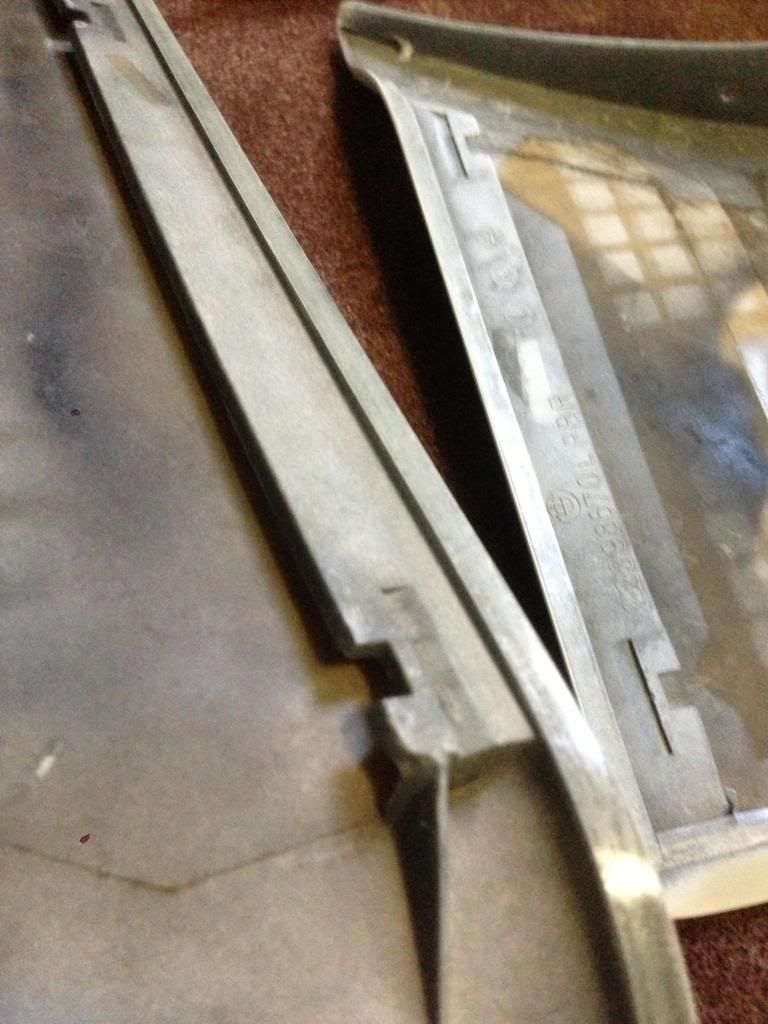

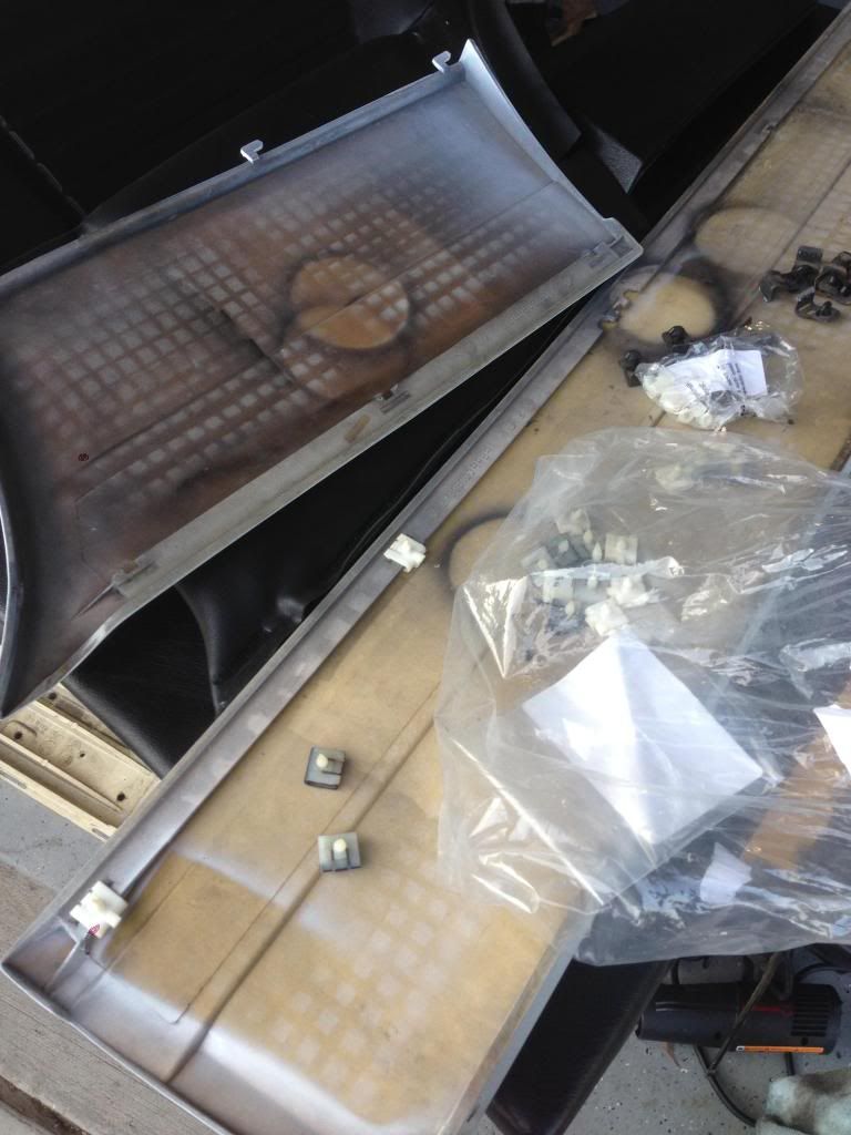

                Pods are last

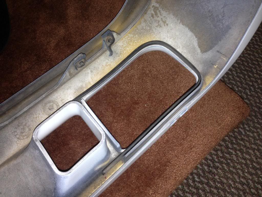

                Started with factory liner that goes around the edge to prevent the panels from rubbing on the body paint
                Can barely see it
                New panel clips
                More clips
                Rear pods is on
                Door pods
                Bottom clips for door pods
                Installed
                Front pods on and finished
                Washed

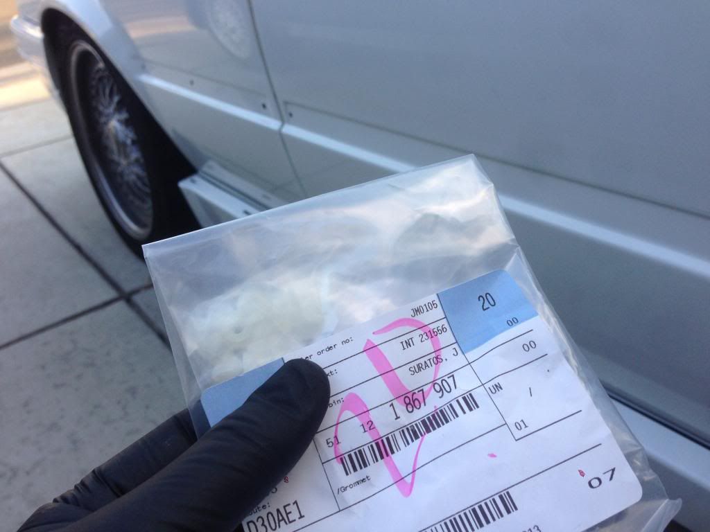

                    Now the wheels need a 5-7mm spacer to fill wheel wells better, shame all the little grommets cost nearly the price of a kit.
