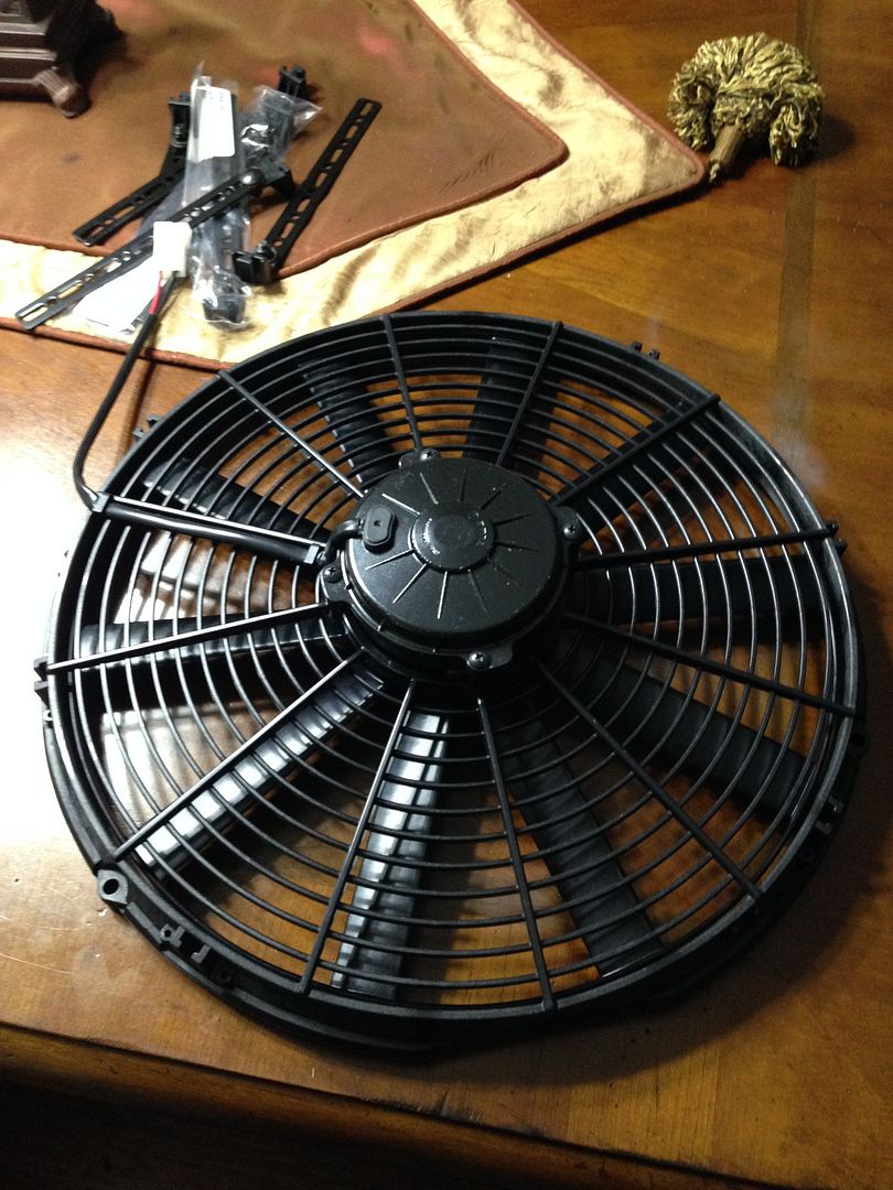

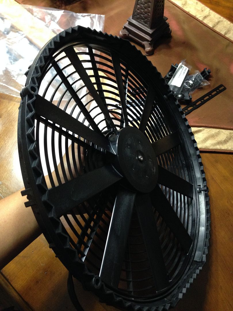

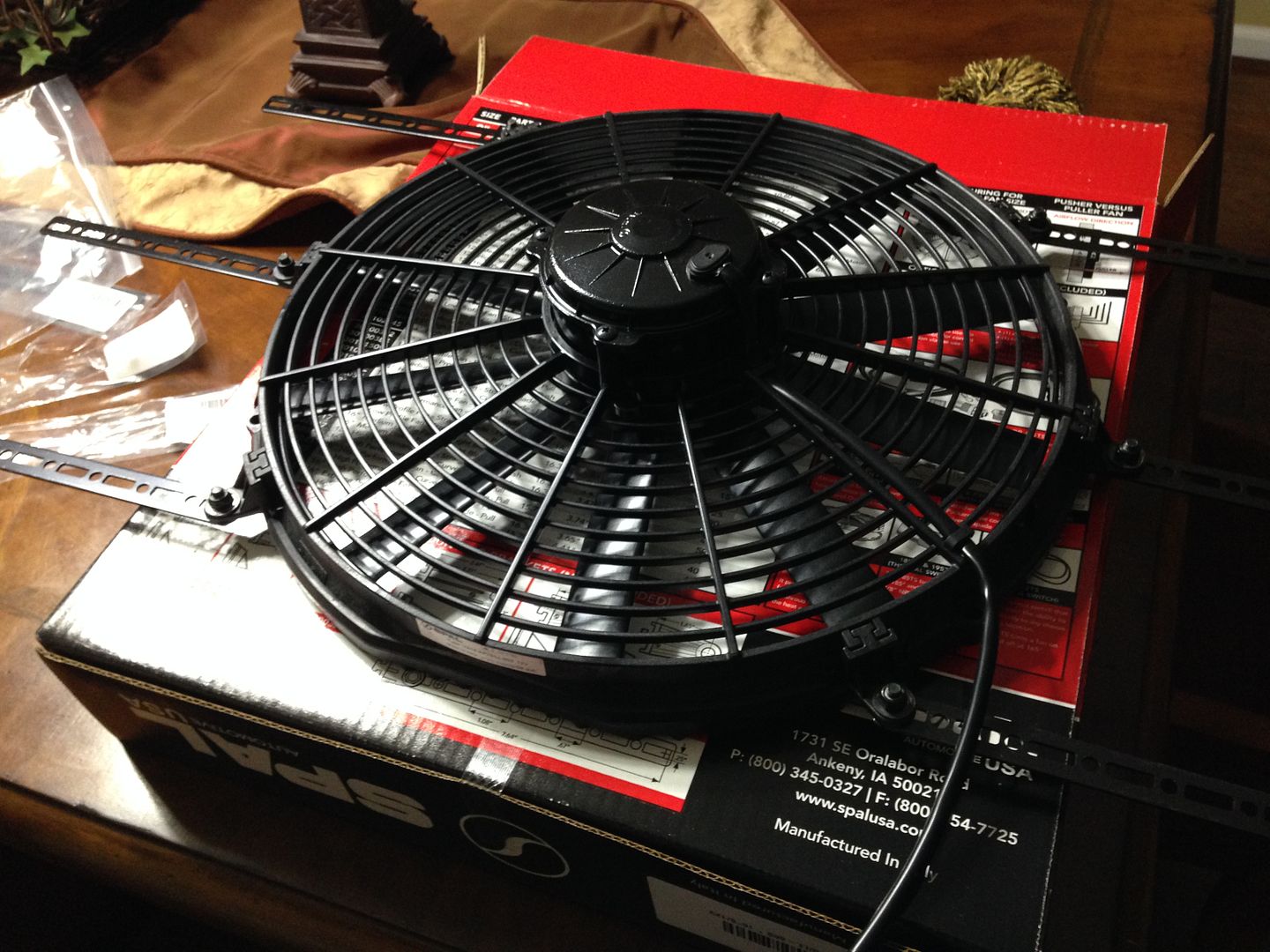

    RE: Let's do the engine!!!
    So first thing is first. lets fix the culprit of the overheating cause... the FAN!!!
    Going to upgrade to the spal straight... which is apparently the strongest fan I can fit with 2,036 cfm!!! Perfect for that hot day with the A/C on.
    Perfect clearance even with the condenser behind it

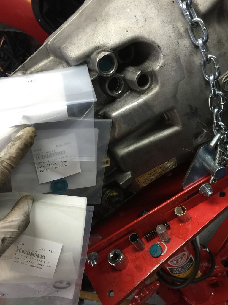

  • KoKoSe7eN

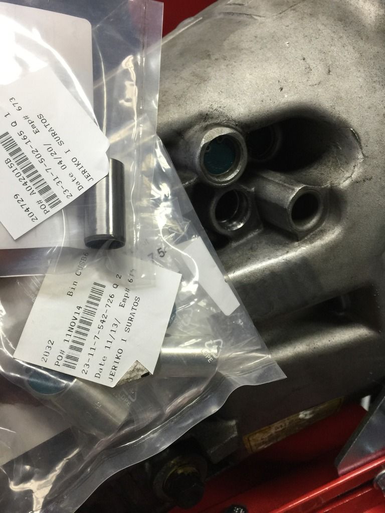

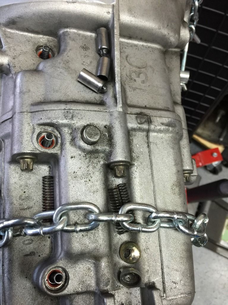

    replied
    Zf320
    Originally posted by pandaboo911
    Was there significant wear on the pins?
    My trans has trouble shifting into reverse. Really takes a lot of force to get to the reverse "gate"
    Yes, mine was the 5th... The pin for 5th was stuck in the bore... I decided to replace all serviceable pins around the transmission and now every gear feels smooth and notchy!!

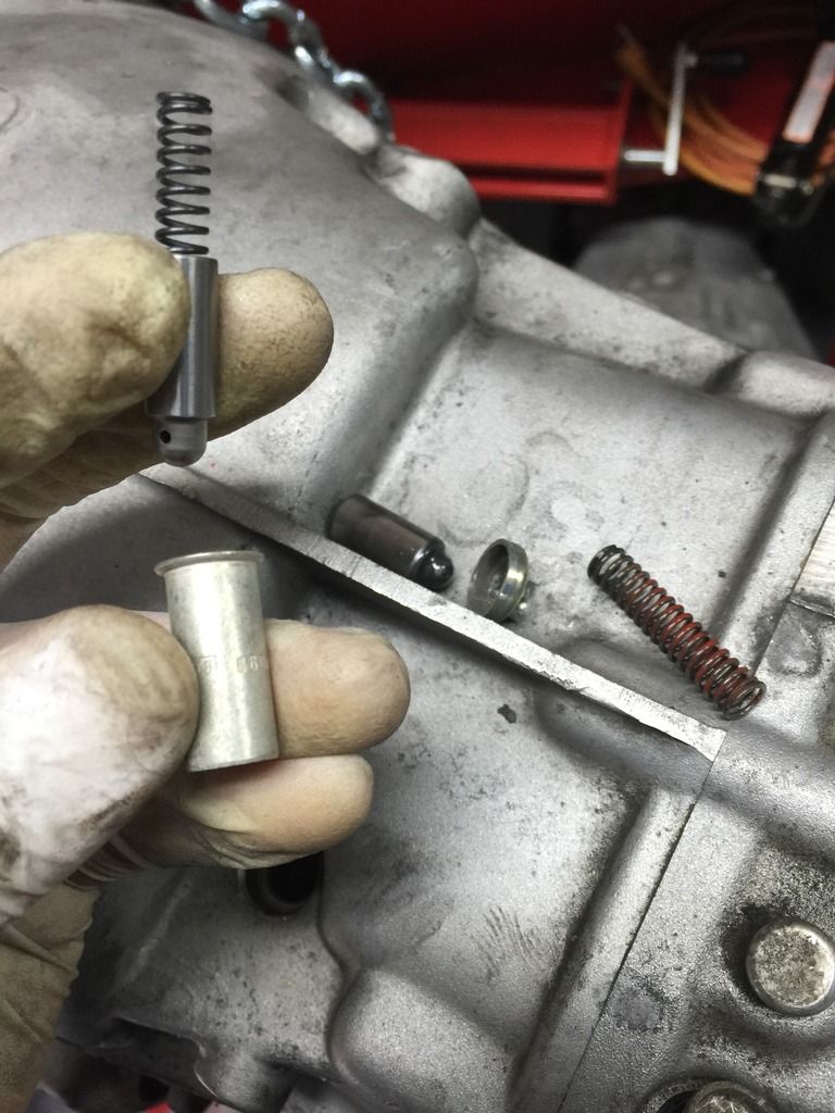

  • pandaboo911
    replied

  • KoKoSe7eN
    replied
    5th/reverse sleeves, pins and spring for shift gate problems on ZF320
    And 1-4 shifting sleeves and pins
