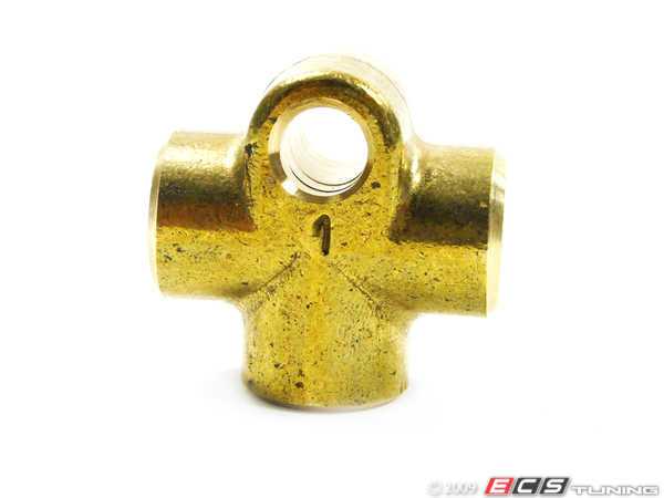

        You can have compression fittings on your brake lines?

            #245
            Where you splice brake lines together. I know is pa we are not allowed to and can't pass inspection with it.
                I dont know if this what you mean by splicing brake lines together but this is the way I'm setting up my lines.
                Originally, the E30 (I'm sure you know this) has one brake line going towards the rear and then splitting to each rear wheel with a T FITTING.
                Coming out of my AUDI MC on the booster, I have two exits or two feeds. I passed two separate lines. So coming out the MC, I'll have the lines feeding TWO of the original E30 T FITTING. Then out those T's the brakes will be setup in a X pattern. Front right with rear left. Hoping it works out!
