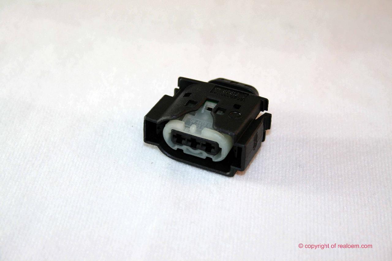

                      Looks like it's made by LK. I believe the PN is 52518 0.

                          No luck with that part # you gave me (sorry for the trouble!).
                          But, I did find the BMW # (pretty sure)
                          12521433915 (connector)
                          12520007170 (pins, pretty sure I already have a bunch)
                          12521732634 (rubber boot)
                          cliffs: cross reference oil level sensor PN (12617508003) on real OEM. Click on random models (it's used on almost everything) because sometimes BMW will show you a part # for something electrical, and sometimes they don't. I found it on a diagram for the E53 X5 3.0:
                          http://www.realoem.com/bmw/showparts...12&fg=05&hl=14
                          WHY BMW does this I don't know. I've had to do the same thing to find other electrical stuff. Same damn part, but only certain models will give you a #.
                          now to make another blunt order.. sigh. yeah, just buy a damn harness. :p
                          edit: yep, pretty sure it's right. here's a pic of #12521433917, which is in the same part family:
                          Build thread
                          Bimmerlabs
                          • FredK
                            • 14762
                            #73
                            Yep, that is the connector.
