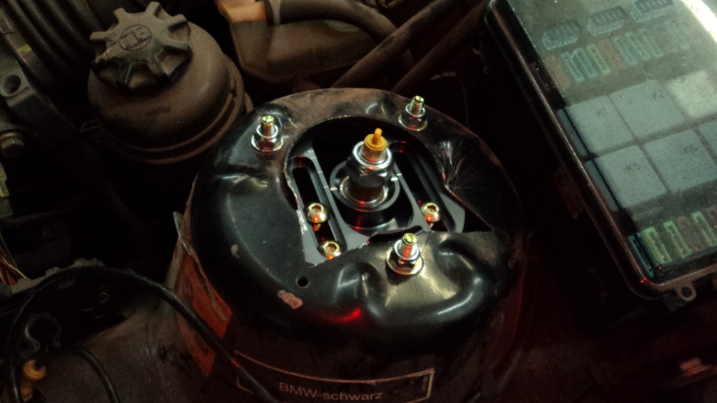

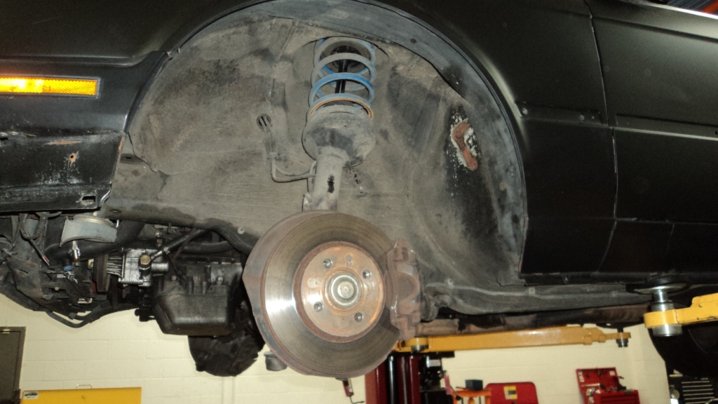

            Front suspension

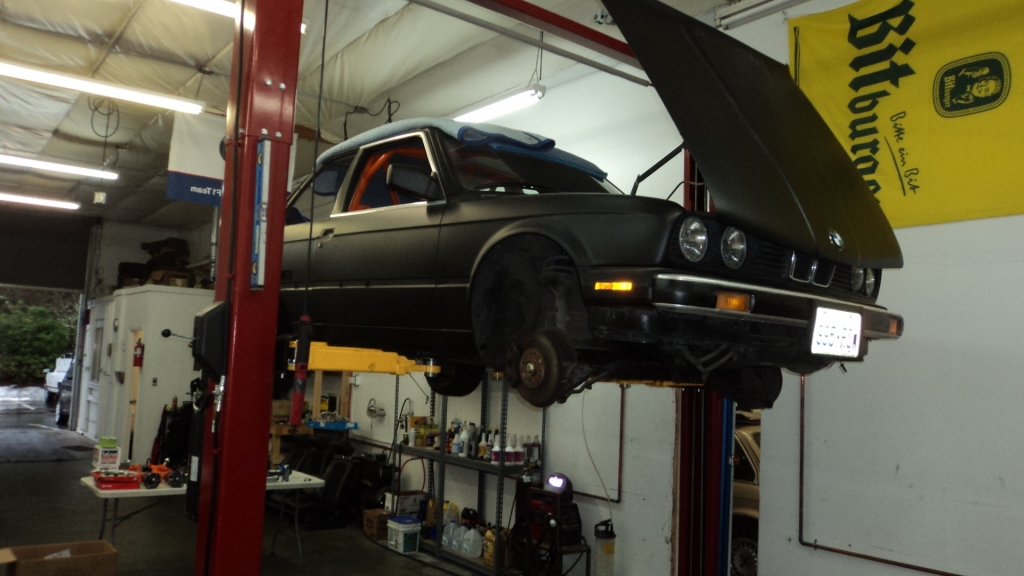

            reassembled and up on the lift
            before shot
            Front goodies
            Dirty
            Clean and freshly undercoated

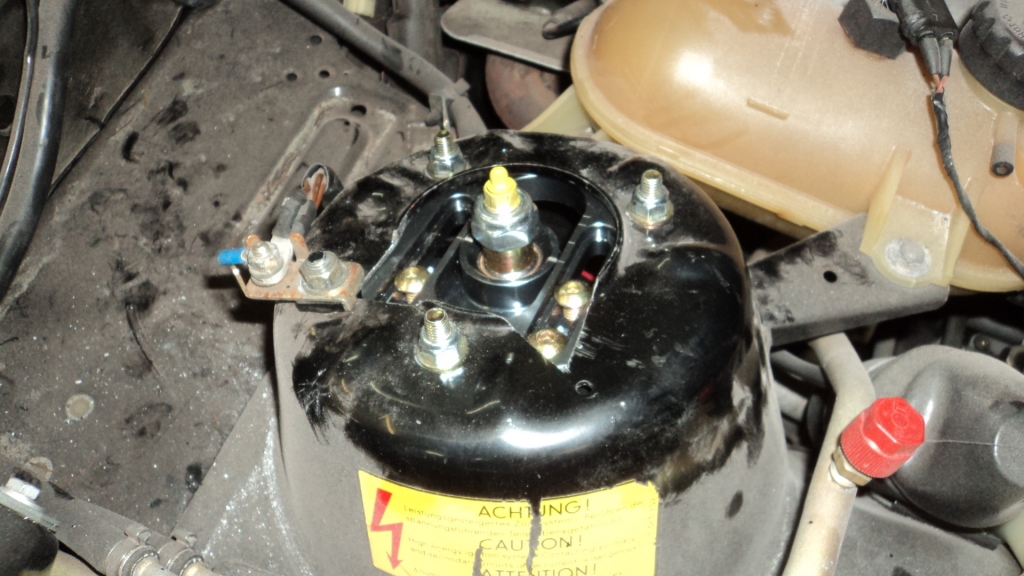

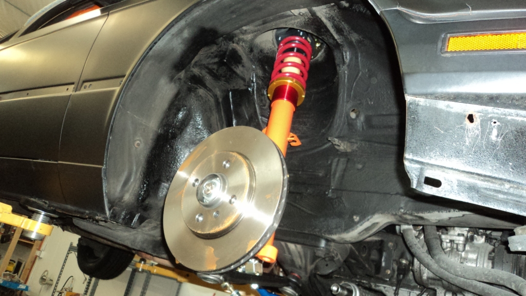

            Cut for the camber plate
            Girlfriend filling down the sharp edges

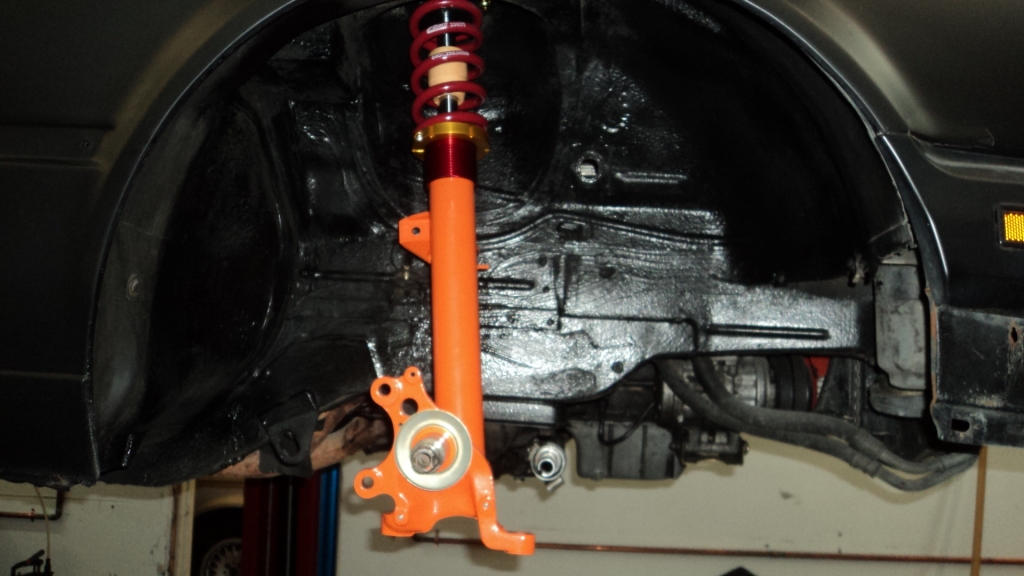

            Strut assemblies installed

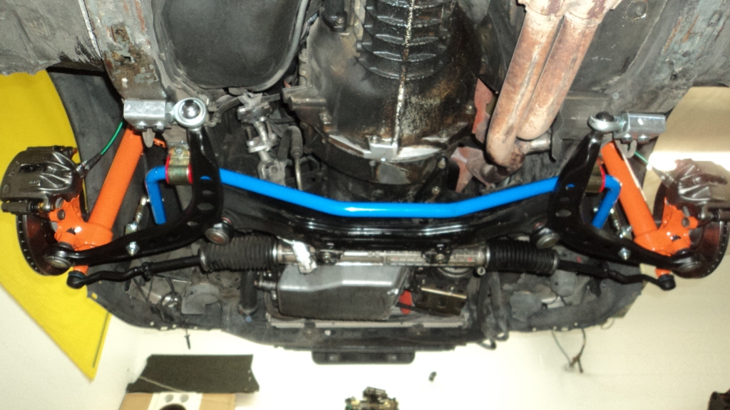

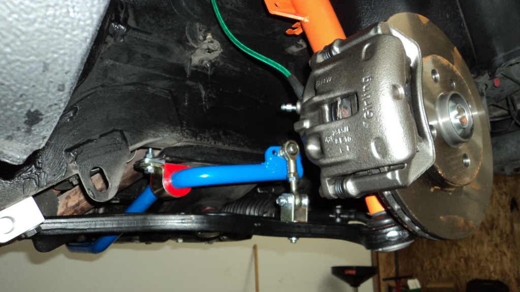

            Sway in, control arms in.
            AKG adjustable caster CAB
            Getting it done, my Dad looking at the progress
            Bearing and hub installed
            Brakes in, Sway hooked up
            Tie-rods in
            Fronts done.

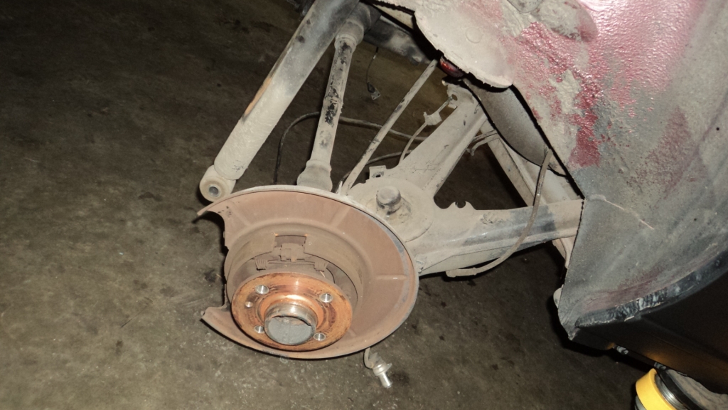

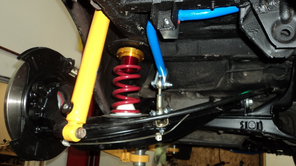

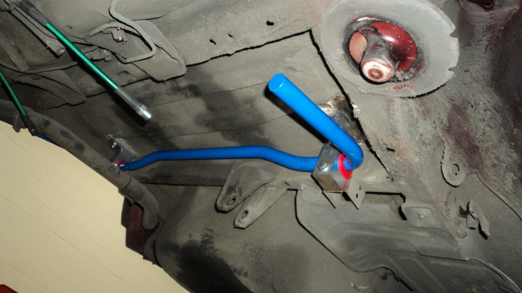

            Rear suspension

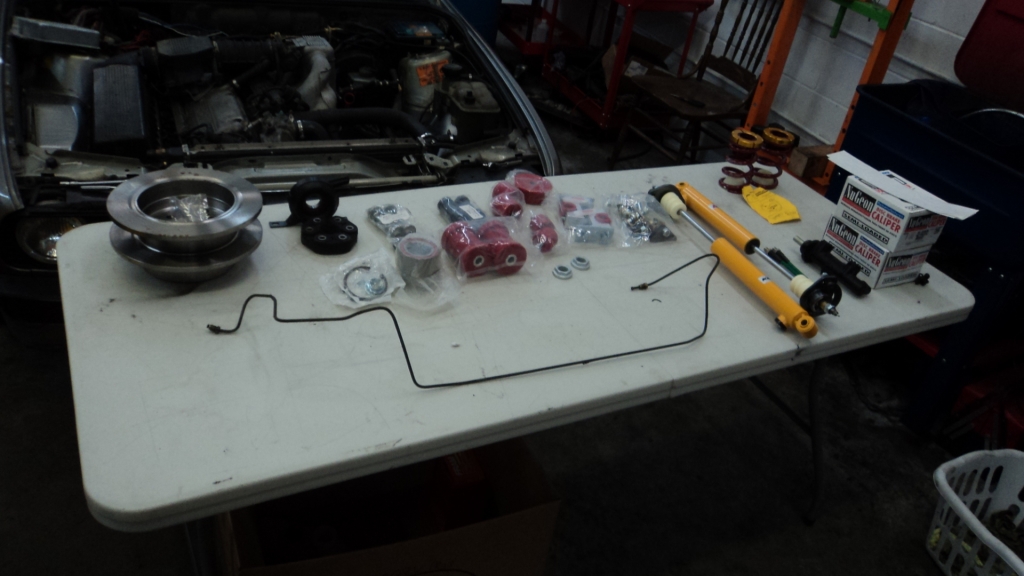

            getting some of the parts ready
            Disassembling
            Subframe out
            Chassis before
            bye bye diff, it went to James' car

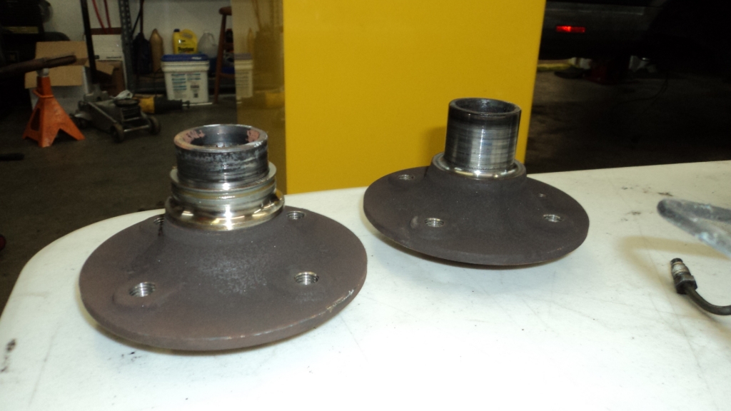

            Pulled apart subframe and pulled hubs from bearings
            Damn. Well one inner race stuck on is better than two.

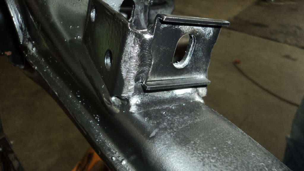

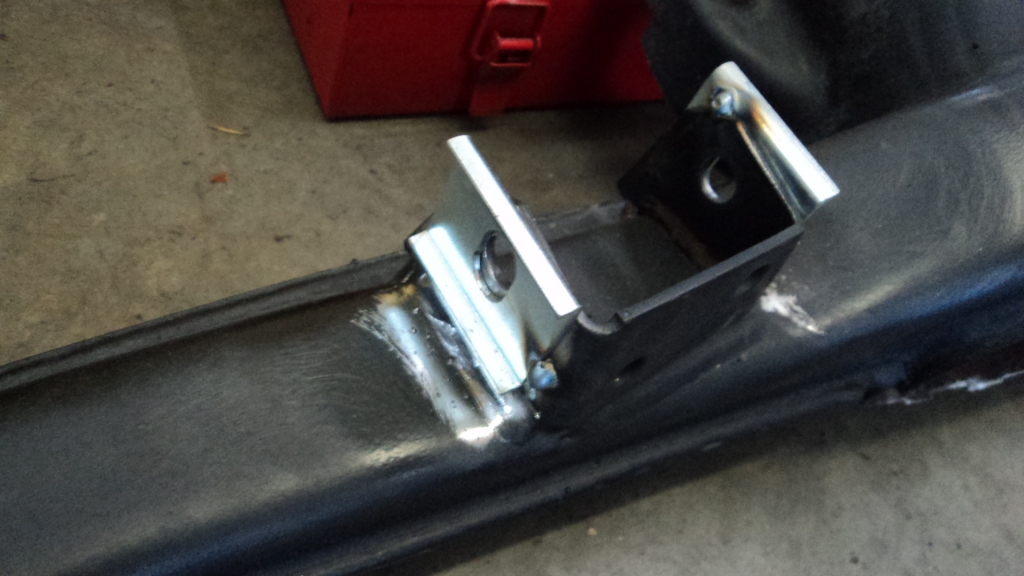

            Pressure washed the subframe and tacked on the toe adjustment plates
            Tacked up the camber plates

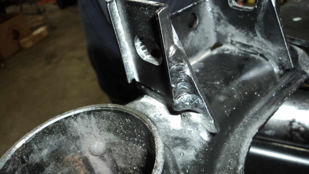

            Welded, painted, and ground out camber plate
            Toe plates done.
            This was my work bench for welding and painting
            Trailing arms clean painted and ready for reassembly

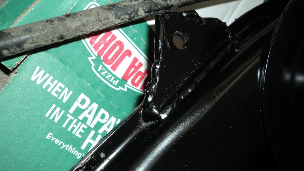

            Re-enforced sway bar mount.
            Wheel bearing time
            Bearings in
            Hubs pressed back in
            Got the sway fitted in, then took it out to undercoat.

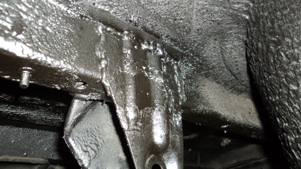

            Reid welding up the diff mounts to re-enforce them.
            Undercoating
            Diff mount toughened up
            Fitting the subframe, I had to see how much of the bushings to shave off. It need to be done to get to the nuts on the outside of the toe adjustment plates.
            Assembled and ready to go in.
            In, and sway hooked up.
            Shocks and springs installed

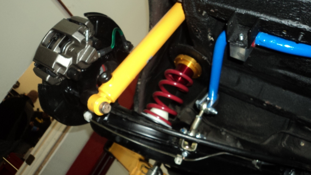

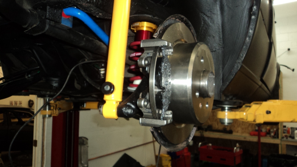

            Assembled, time to do the brakes
            Brakes! Hooray!
            Stance be damned! this car does real work!

                  Looking nice! I would be concerned about cutting the strut towers. I guess you don't see it as a source of more flex/weakness?
                  S50'd
                  Originally posted by TDE30
                  What is this faggy shit I have happened upon?
                  I can always live in a M3. Can't M3 a house.
                  • Jparkr
                    HR Admin
                    • Jan 2006
                    • 3494
                    No, It may be a tad bit weaker when broke down on paper, but it is unnoticeable and completely safe. I have a sparco front strut bar to install as well.
