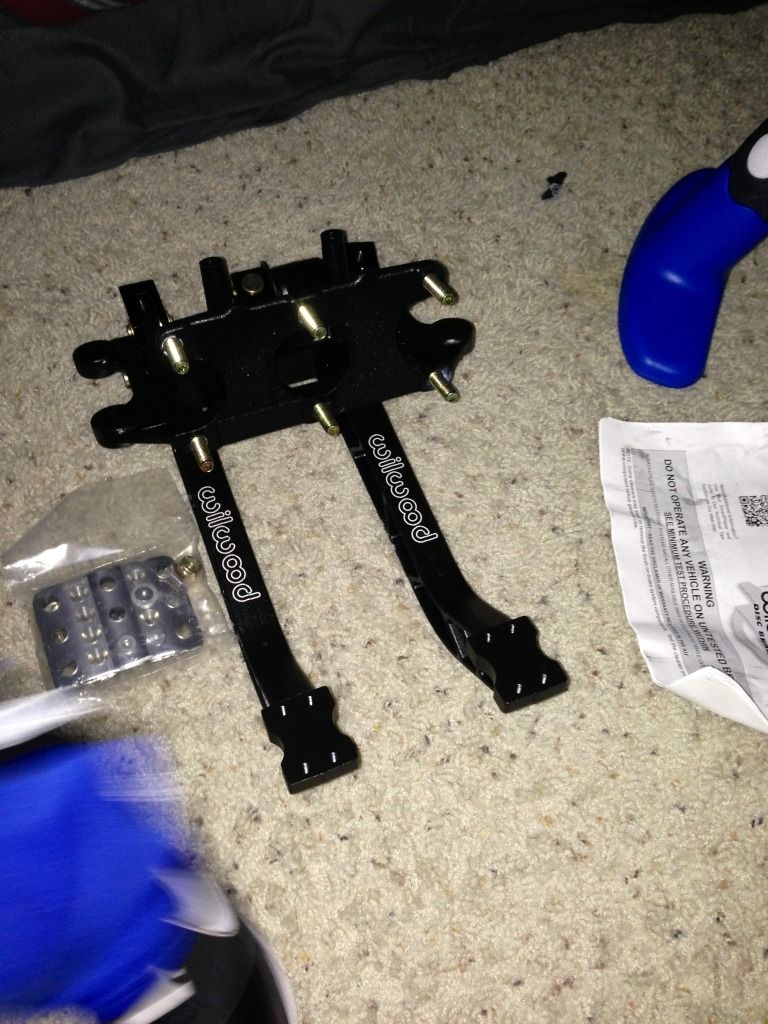

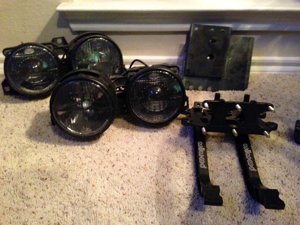

      Wilwood reverse mount pedal assembly
      Pedal assembly mount bracket

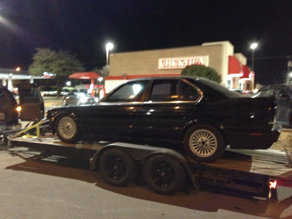

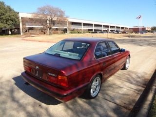

      I looked at this car and was going to buy it and change the entire direction of my E30 V8 swap. Guy sold it from under me when I went to get the money from the bank.
      It was a 1 owner 95 540i auto for only $2500. Yes $2500

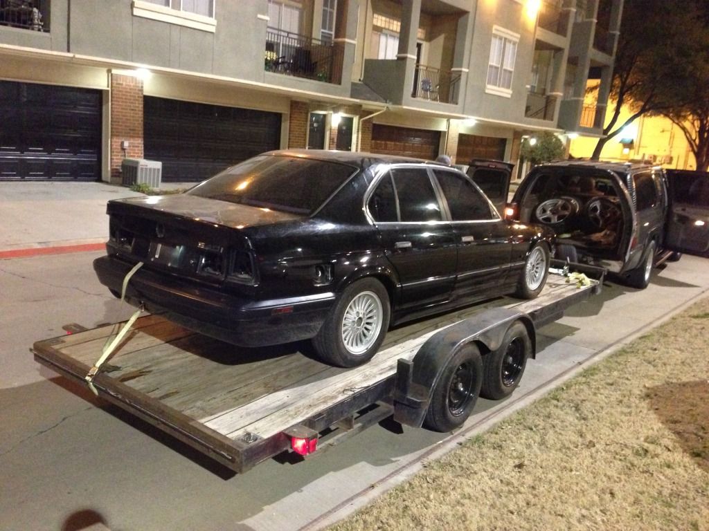

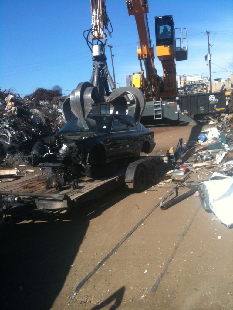

      Whats left of the parts car.

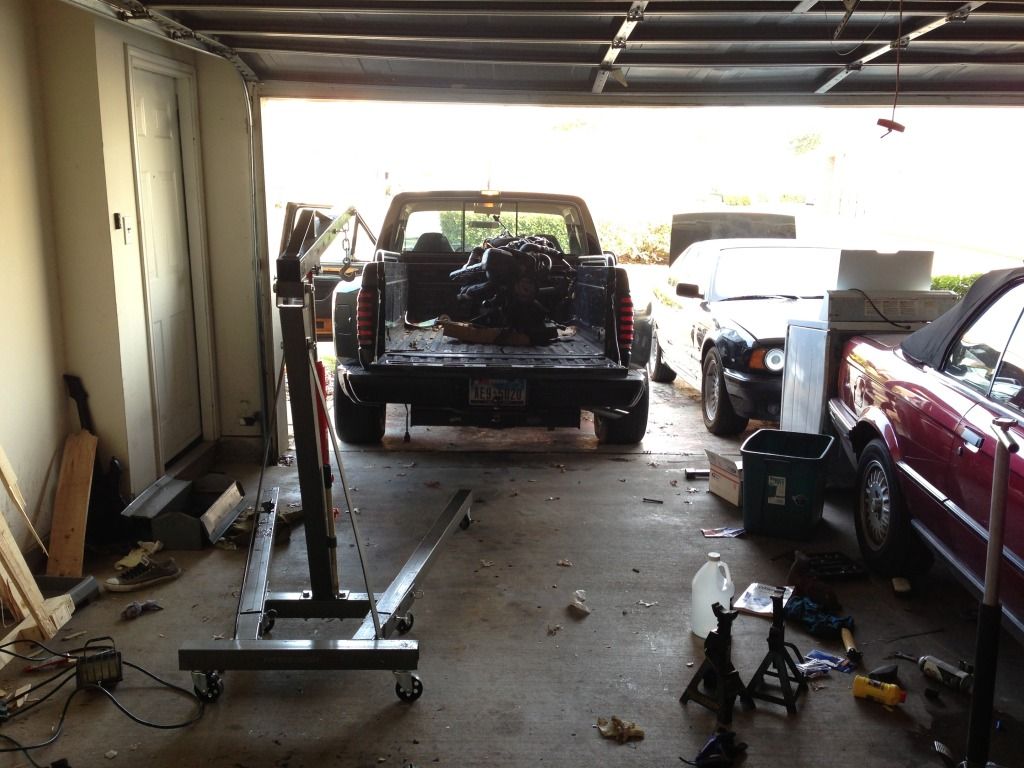

      Hauling off the M20 I sold

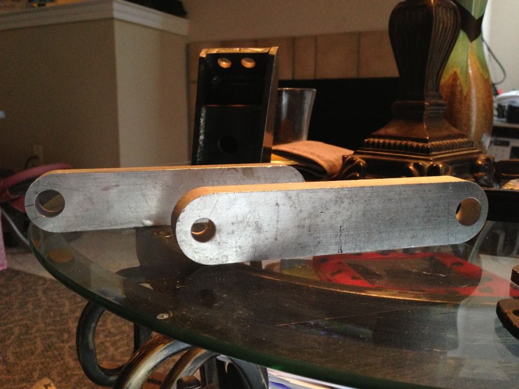

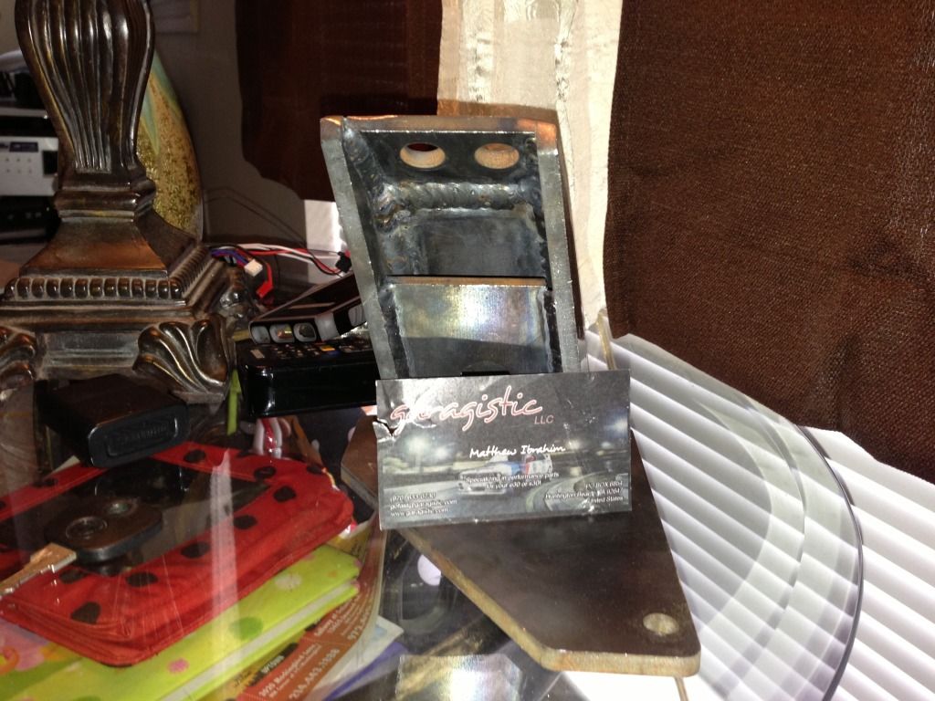

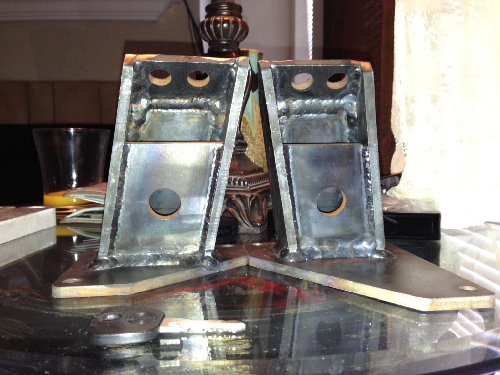

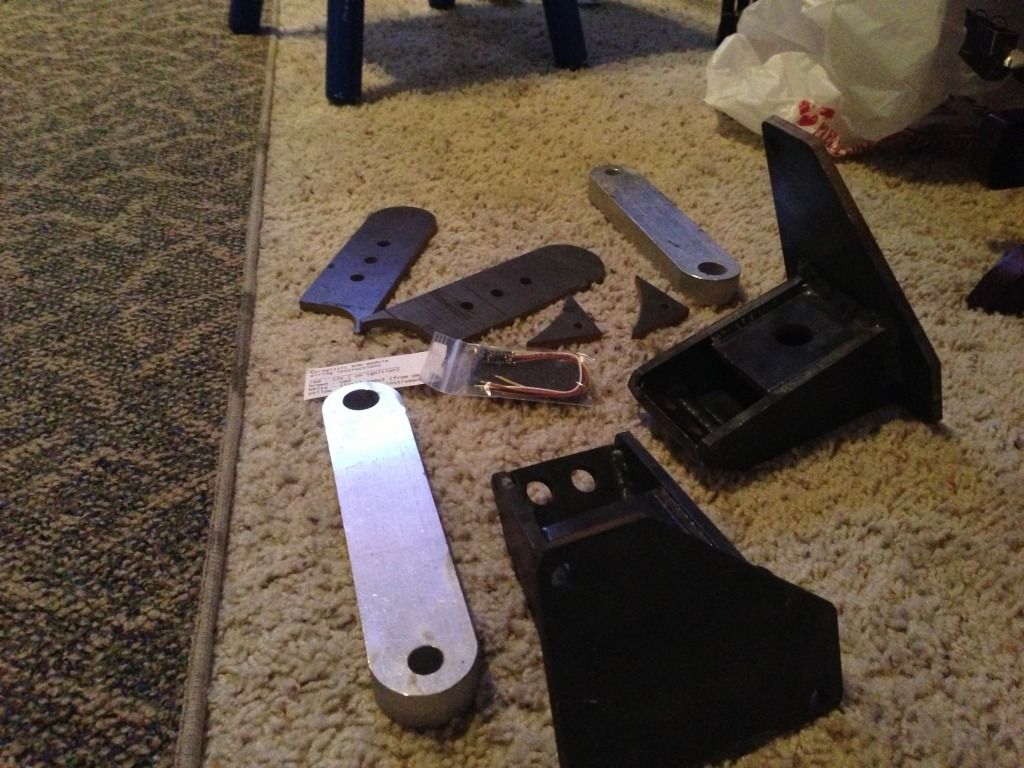

      A package from Matt @gragistic! Awesome guys! Very quality and sturdy mounts.

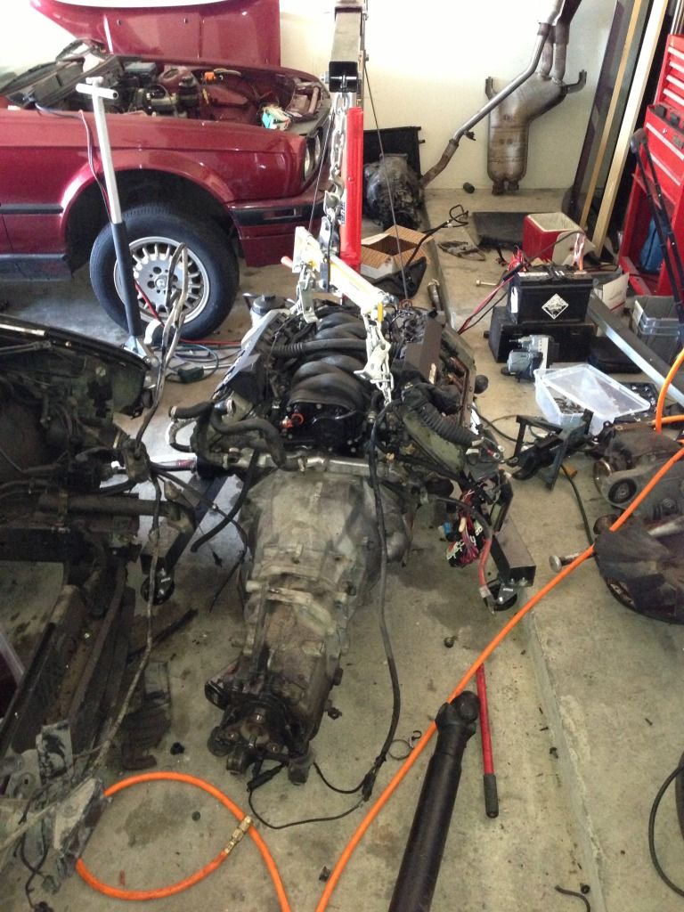

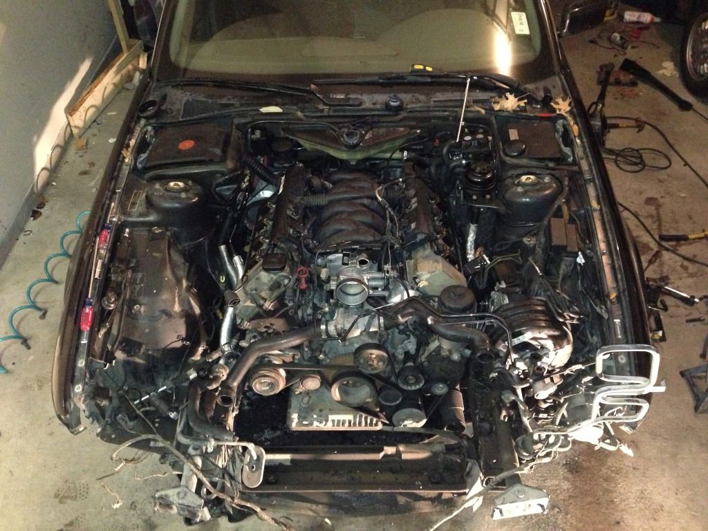

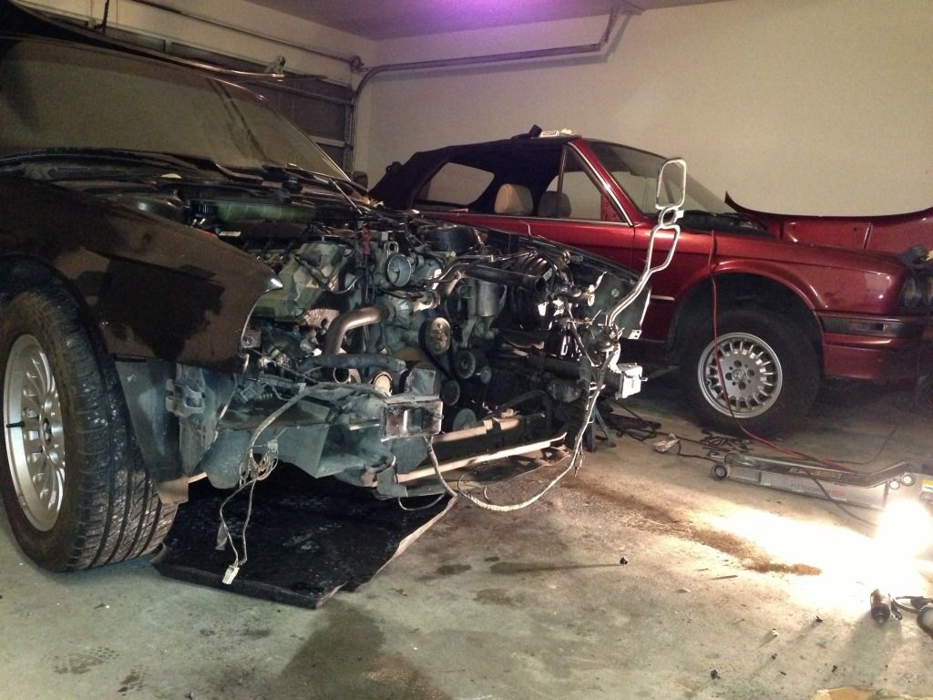

      Getting everything out and ready to pull. I love removable core supports!
      All out and ready to disect. Everything is pretty clean if you ask me. I'll probably brush it all over with a cleaning wheel of some sort.

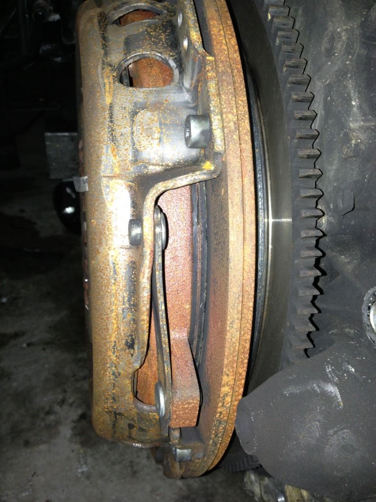

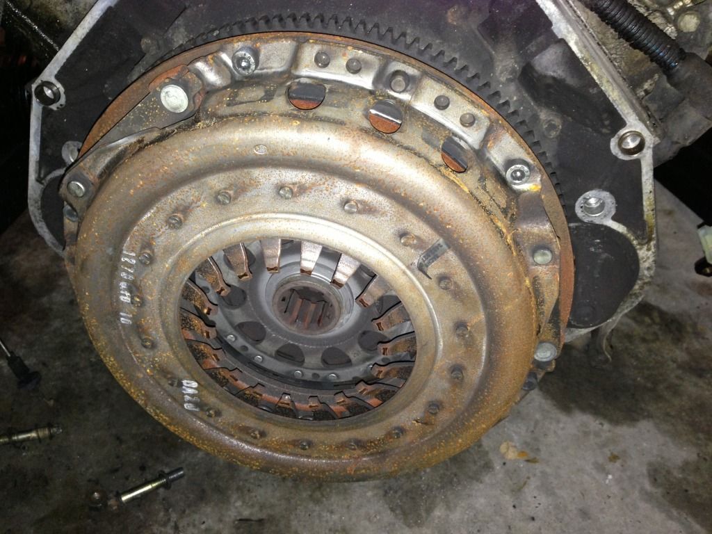

      Clutch looks to have some decent tread. Good enough for now.
      Now the e34 sits low! Hella flush.

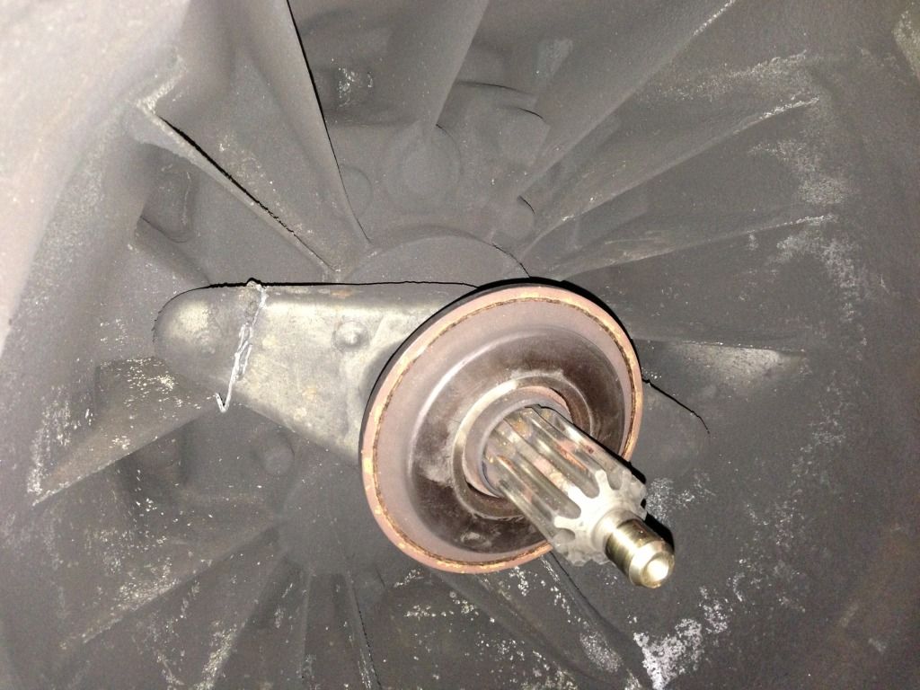

      I'm assuming in the last pic I'm supposed to cut that down to fit the mounts. Looks pretty straight forward. If not, X5 parts will be ordered.

          Wait, you got a one-owner calypso 540i/6 in perfect running order for $2500??? AND you parted it out?!?!?
          I love your swap but 540i/6 cars are hard to find these days, especially unmolested :( RIP E34
            Reading fails you.
            The car he parted was a black 540i/6 with hail damage that he got for $1500.
            The calypso e34 was a 540i/A for $2500 that he almost bought but the guy sold it under him while he was on his way to the bank to get the money to buy it

                The calypso was an auto. I was going to 6-speed swap it and put the m60 swap for the e30 on hold. Why? because calypso E34/6speed > calypso E30 m60/6speed.

                    Looking good!
                    Glad you like the M60 swap kit. Let us know if we can help in anyway.
                    Sidenote: Although the factory m60 rubber mounts in the donor car can work. We recommend unsing e39 525TDS motor mounts. (part number: 22111094248)
                    They are not offset studs, fit perfectly within the e30 frames, and are 7cm higher. The e32/e34 rubber mounts seem to be a bit lower and customers in the past have needed to grind a tiny bit away for the oil pan for them to work. Although that will work, we recommend the motor mounts above.

                      Will do! Thanks again :up:. BTW you guys get that peal assembly write up yet?
                      The bias bar is slightly confusing to figure out.

                        The shell of the e34 is now gone. May its sole rest in my e30.

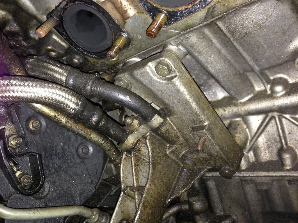

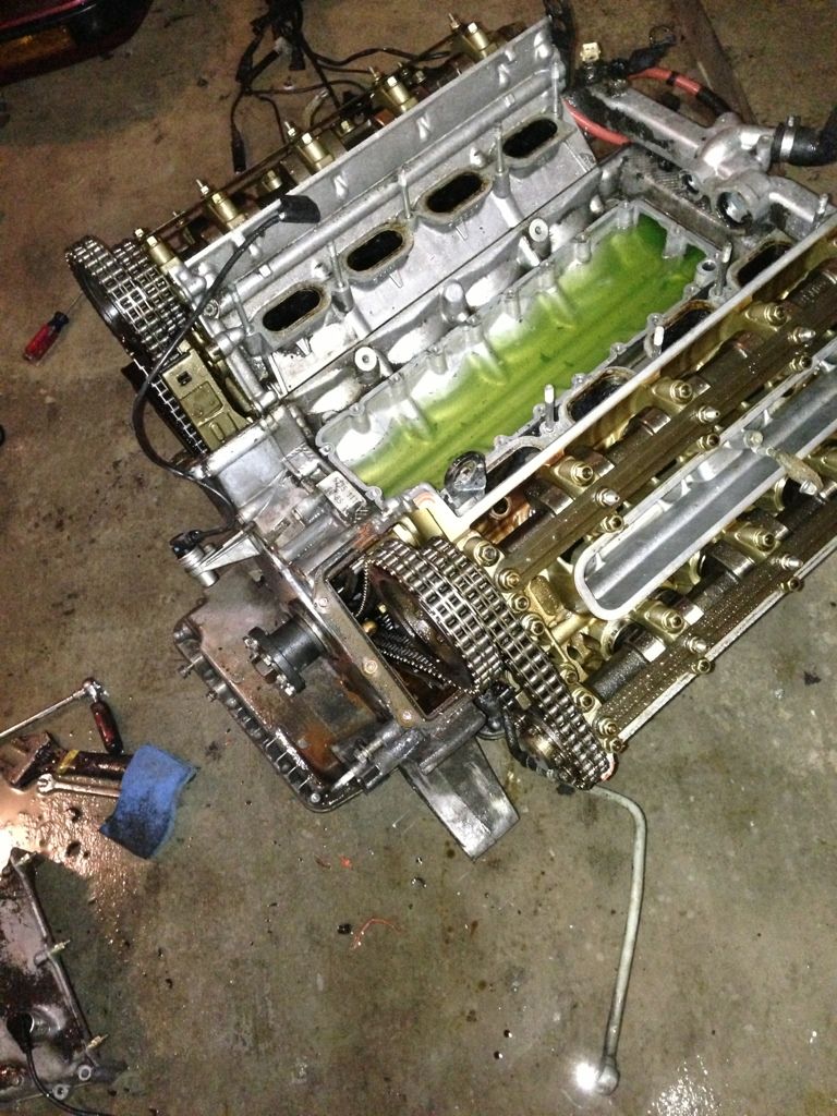

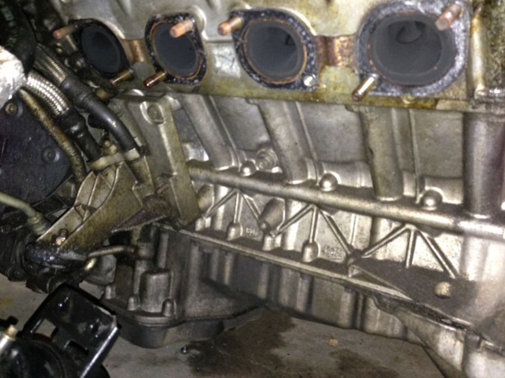

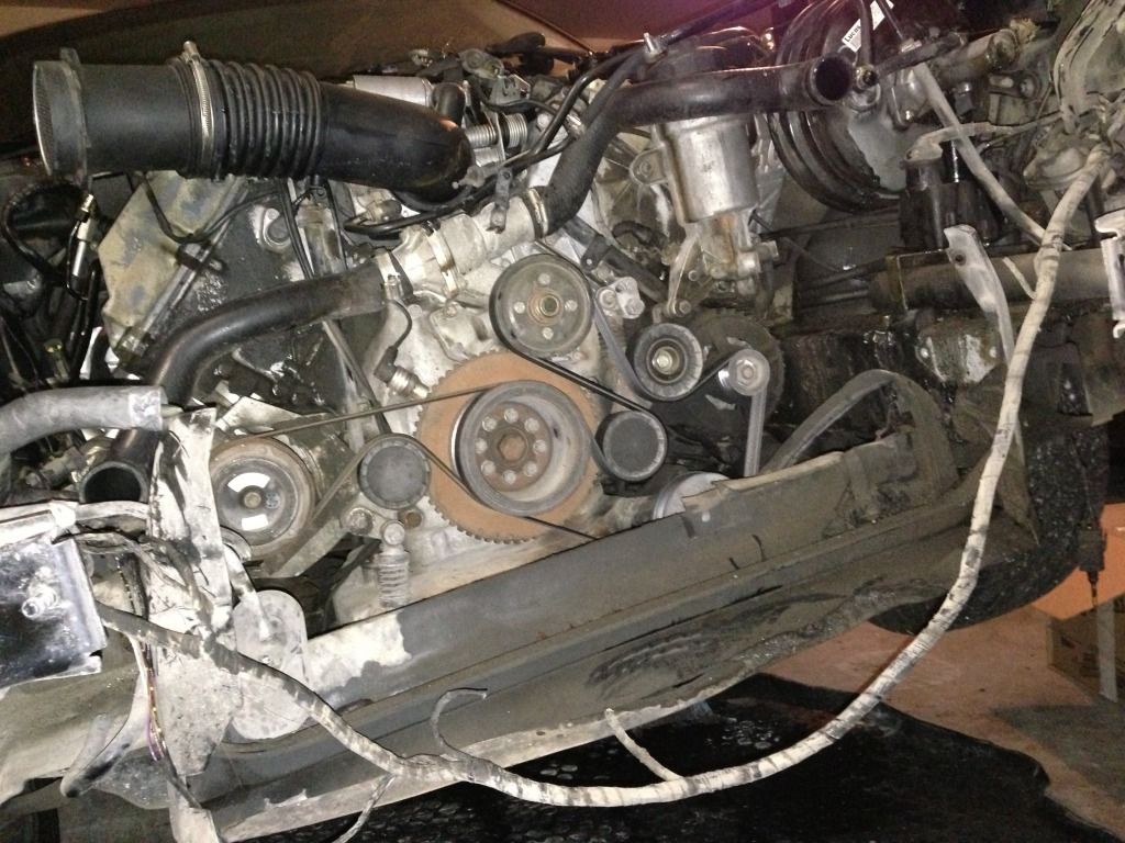

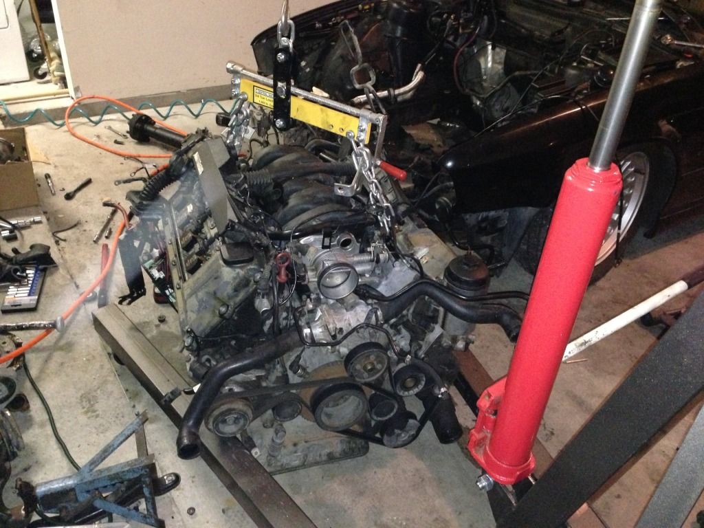

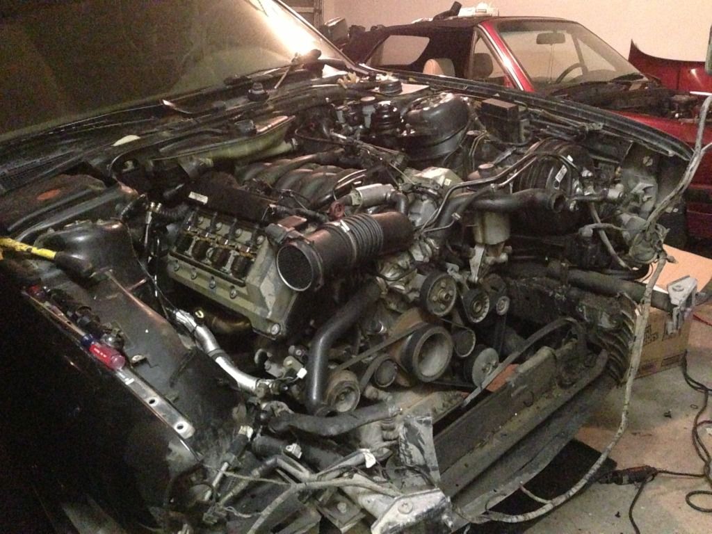

                          Other than that been dicking around and test fitting the engine to see how I'll route my A/C and power steering. Here's a few photos. NOthing special yet!

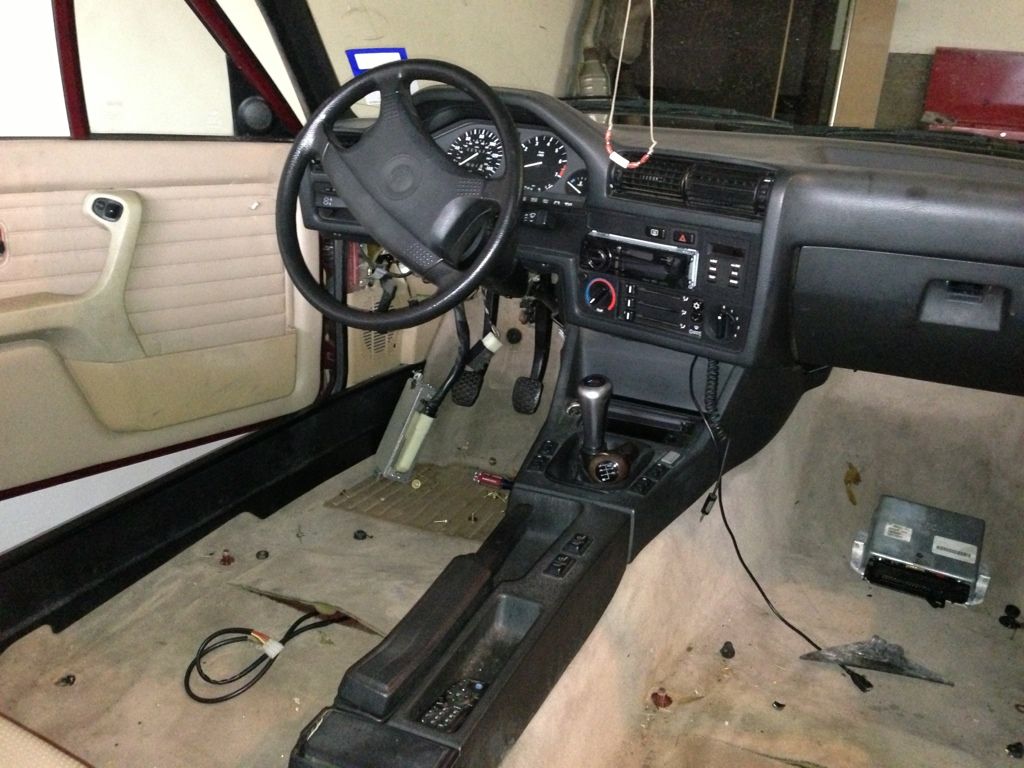

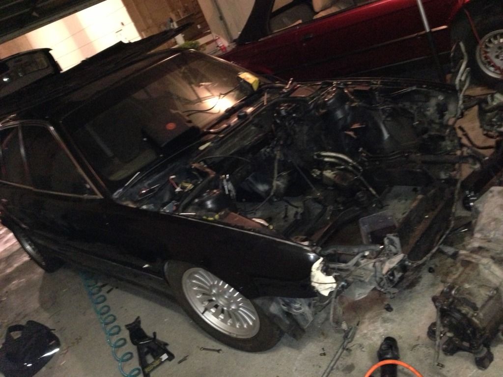

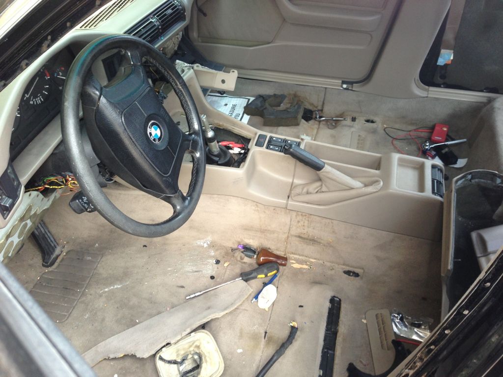

                          started tearing out the interior to get out the steering coloumn and air bag stuff. going to remove the dash to mod the heater core so the rubber tubing can latch on it without binding.

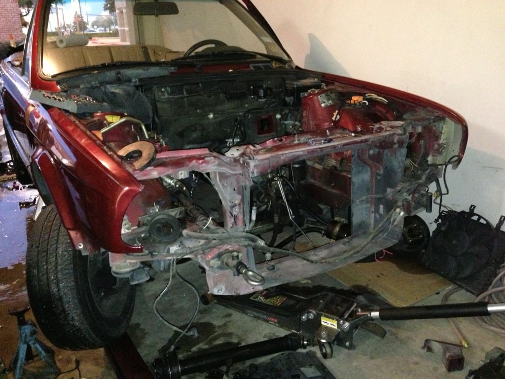

                          Completely stripped the front end and getting ready to make the core support removable

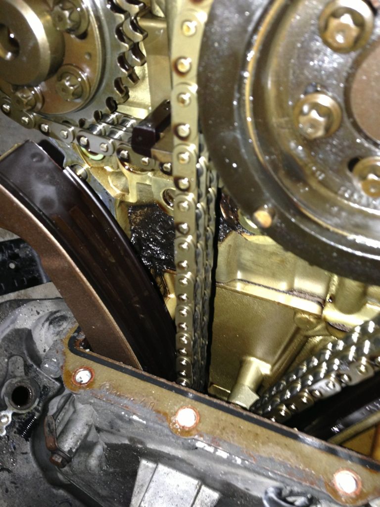

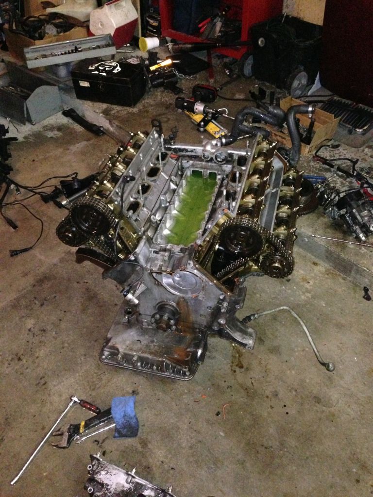

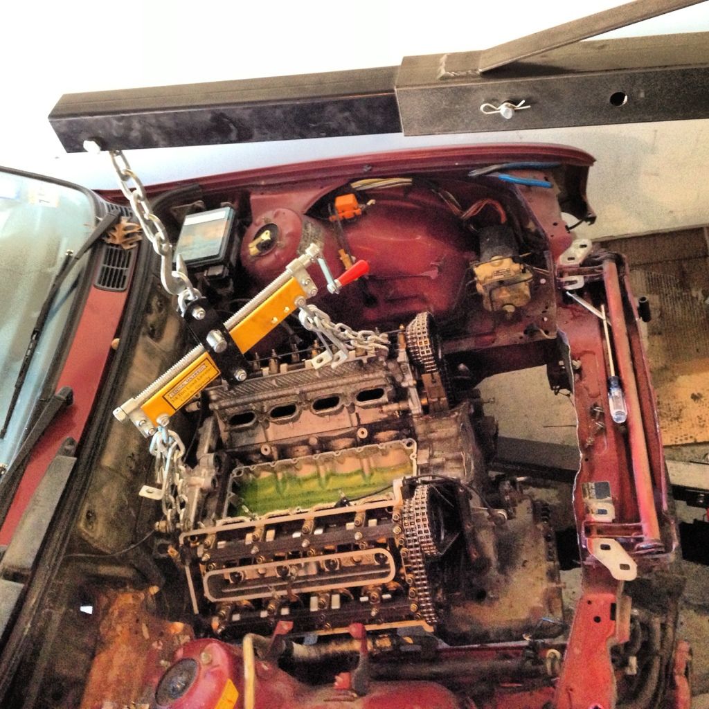

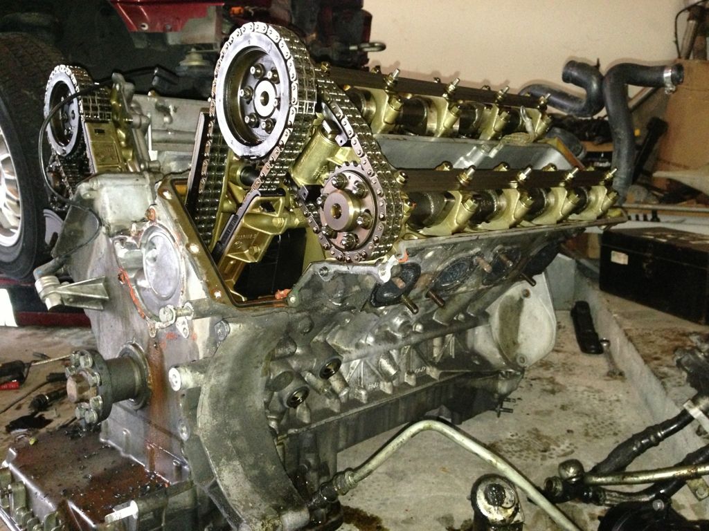

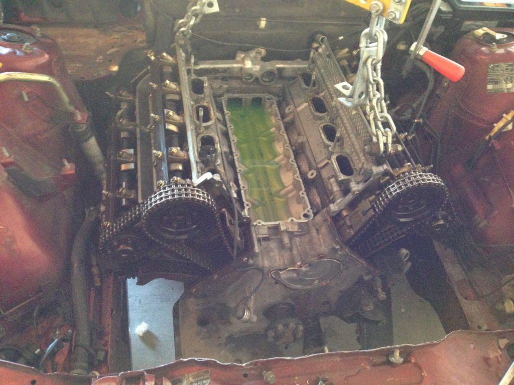

                            The innards of this engine is straight gorgie!
                            although I do have a question, it seems as if the timing of the cams is way off. Shouldn't the bolt be more centered on the cam sprockets?

                              #59
                              It sure does look at home doesn't it. :)
