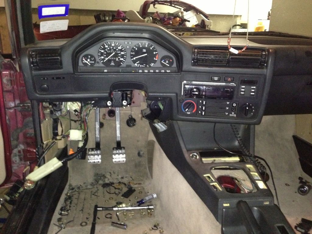

        I got a few updates.
        Got my order from jegs for my wilwood compact master cylinders.

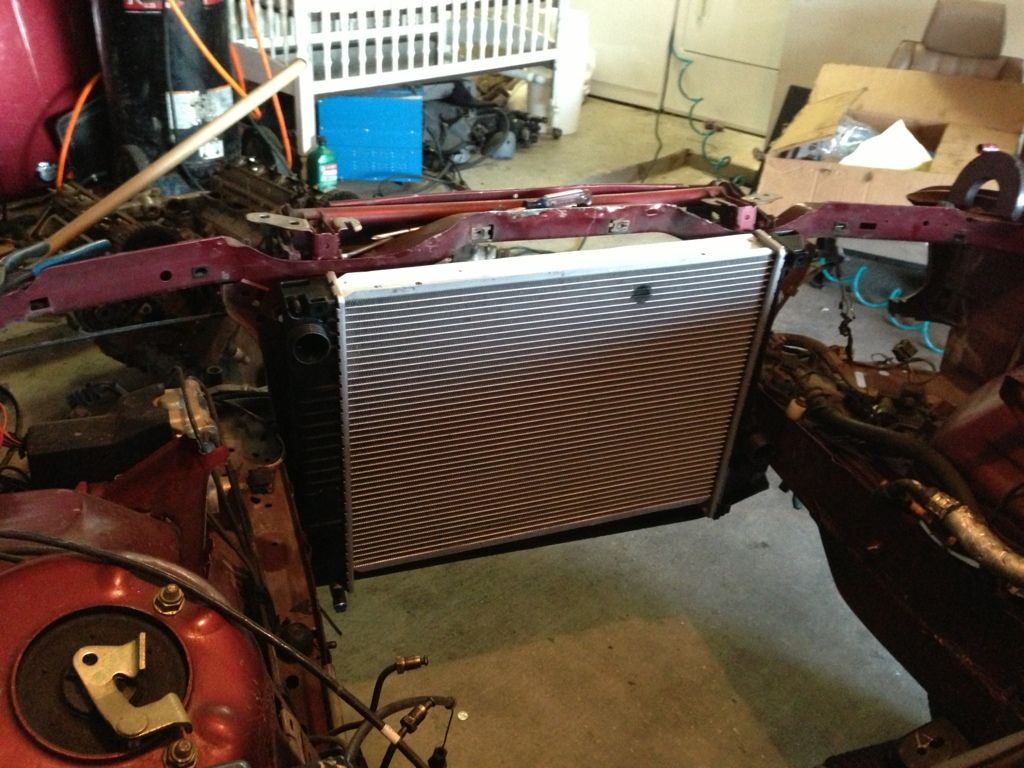

        AutohauzAZ got me my Z3m radiator

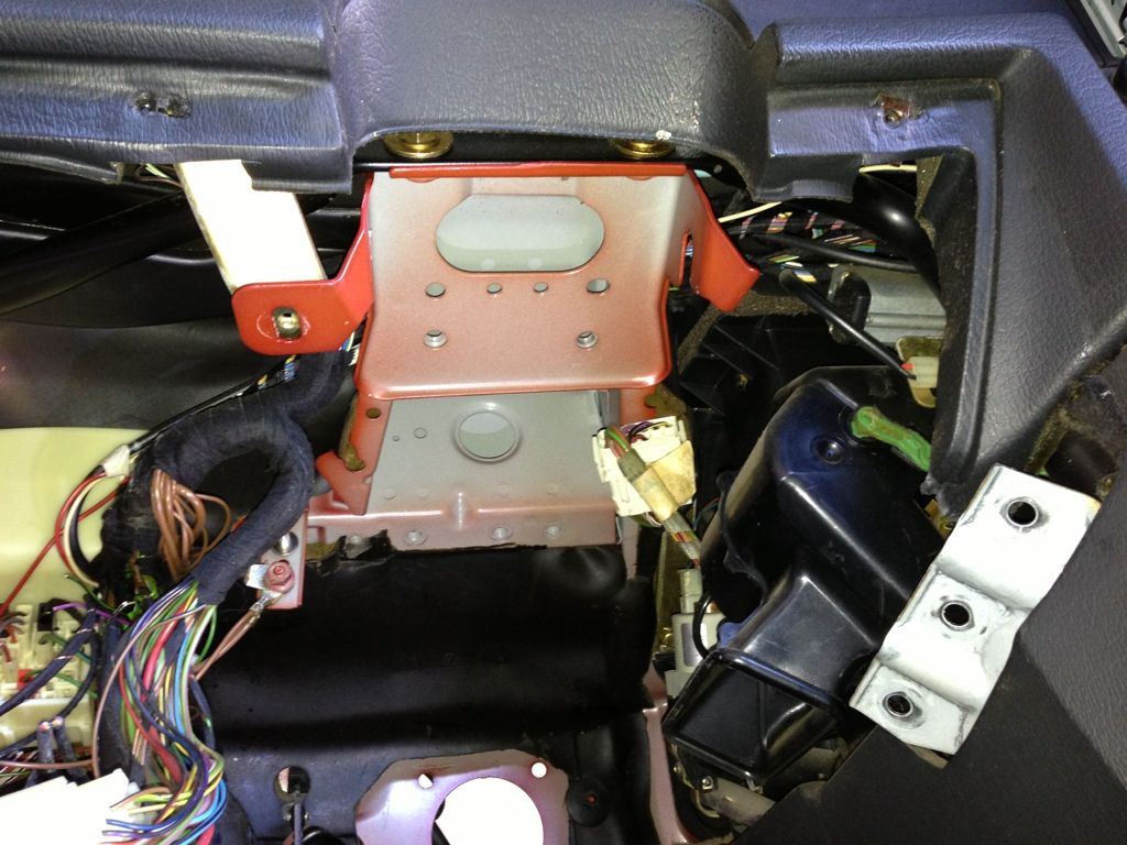

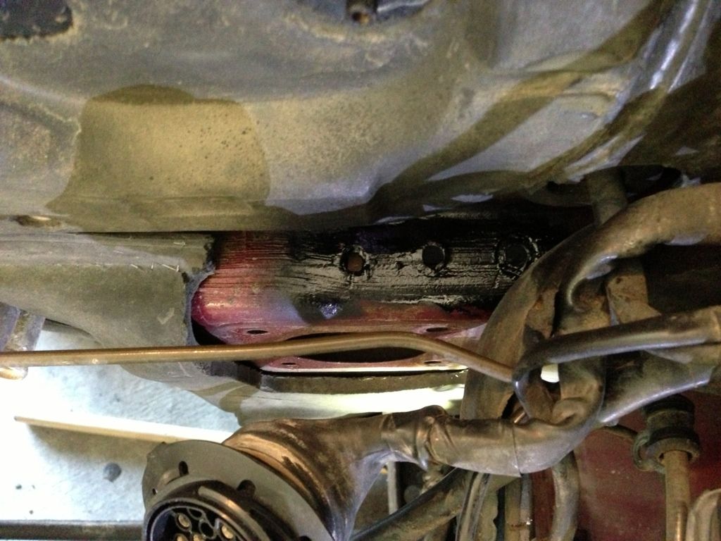

        So I started out mocking up the rear support for the pedal bracket. It required the removal of the steering column which I needed to swap with an early model anyway.
        I then drilled the holes for the sandwich plate and covered them with rubberized rustoleum.
        By far the most annoying part of the swap

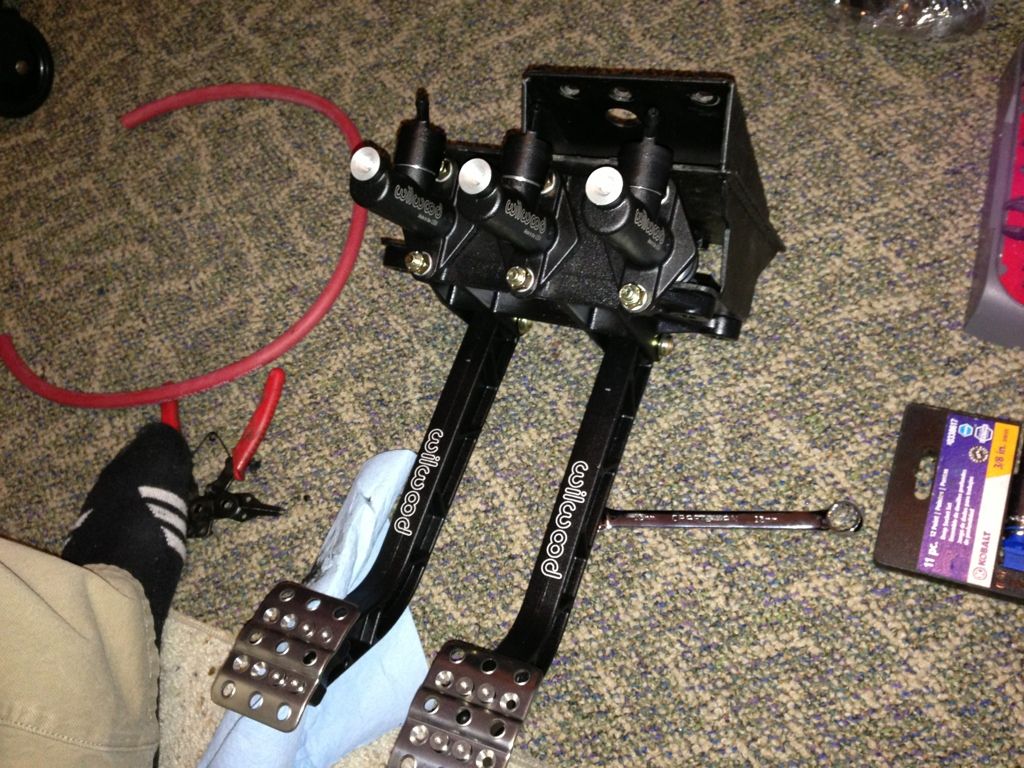

          Got my master cylinders in. Bias bar all dialed in. Pretty cool workin setup. I like where it sits in the foot well. No I need to find some OEM looking pedal covers. Drilled steel looks ricey.

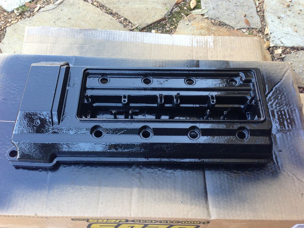

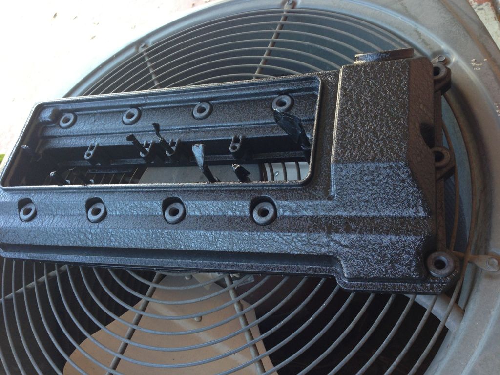

          Also got my valve covers painted. Crinkle paint is fun as hell to watch wrinkle. Quitte generic but I attest, it's still fun to look at and a lot cleaner.

            I love that pedal setup. I want to do something very similar to it.

              That so far is the most expensive part of the swap. The pedal assembly and mount kit start at $380-450 depending on where you get it. Since they are 1/8NPT master cylinders @$80 a pop ($240) you'll need 3 line adapters to get them to fit metric 3/16 line and M10x1.0 bubble flare ends. That's another $50 for adapters and then about $20 for new flared lines.
              Since I'm cheap I've managed to do it for $700. If anyone does the swap, it's well worth the effort to use e34 booster setups. If you'd like to maintain a clean look under the hood and give yourself some more usable workspace, then this setup is somewhat worth it lol.

                Damn! That is a pricey setup. I have 3 different wilwood MC's in the parts shed, I've been wondering if I could rig something up.
                Thanks for the info

                          What bore masters are you running? What brake setup? Stock calipers/pads? Looks good man.

                            I LOVE the coating on the valve and timing covers... looks great, man!
                                Thanks
                                They are 5/8 front 5/8 rear and 3/4 clutch. The brakes are Ti rears and e36M3 fronts with regular pads and rotors.
                                Same pedal assembly mount from Garagistic and they are the 6.25:1 reverse mount wilwood pedals.
                                Thanks. I was going to hydroprint them a carbon or deep wood color but this was dast, cheap, and very effective VS the hours it would take sanding and prepping them to dip.
