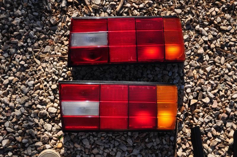

    Polished the crap out of the car, there are still quite a few imperfections but it looks fantastic compared to what it was! Check out the reflections:
    Now that it's clean I can start putting it all back together, the Meguiars trim polish does a great job of of restoring all the black stuff and a bit of paint polish shines up the lenses pretty well.

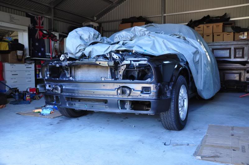

      I've been doing as much work on the car as possible lately however it's been ridiculously hot here in Adelaide, hitting 46 degrees celsius (115 fahrenheit) last week. Those kinds of temperatures sort of sap my will to do too much. I have been primarily focusing on getting the painting and exterior done and it's slowly getting there!

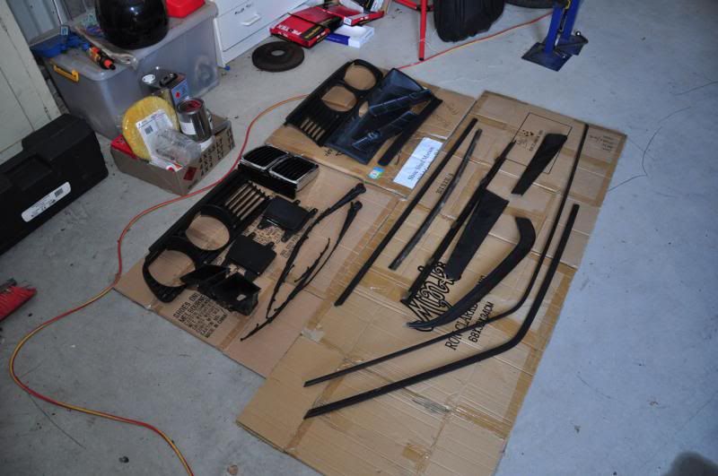

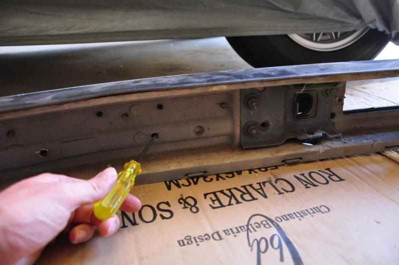

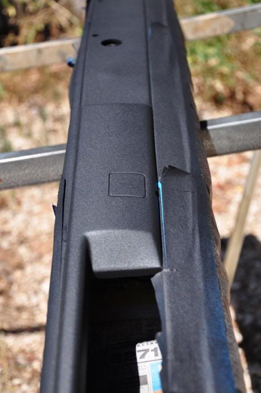

      I wanted to paint all of the exterior trim black again so I started pulling all of the plastic components off. The bumper trim is meant to pop off by accessing the clips through these holes in the back however I couldn't get them all to comply and risked damaging it. Instead I decided to mask it off and paint it still attached.

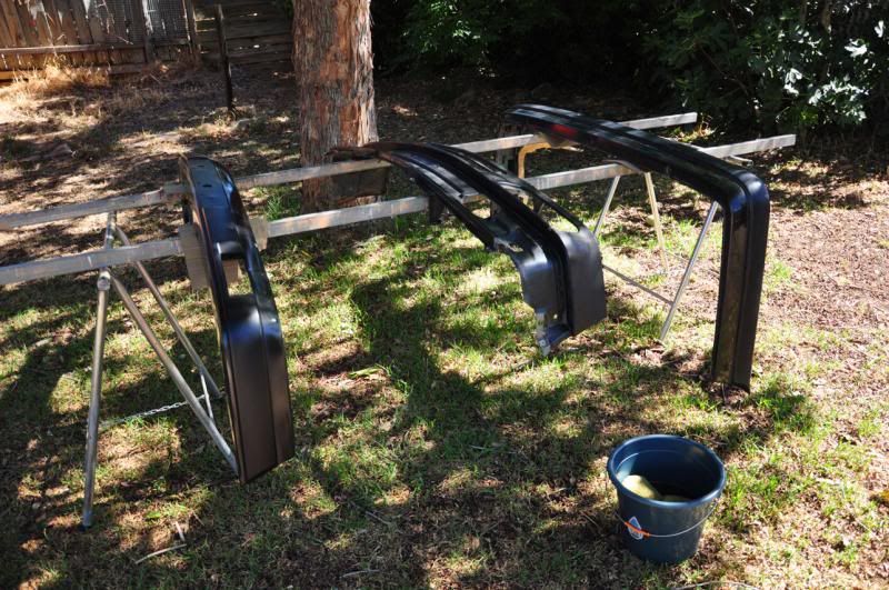

      Getting the bumpers ready

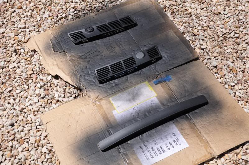

      Bits and pieces ready for paint

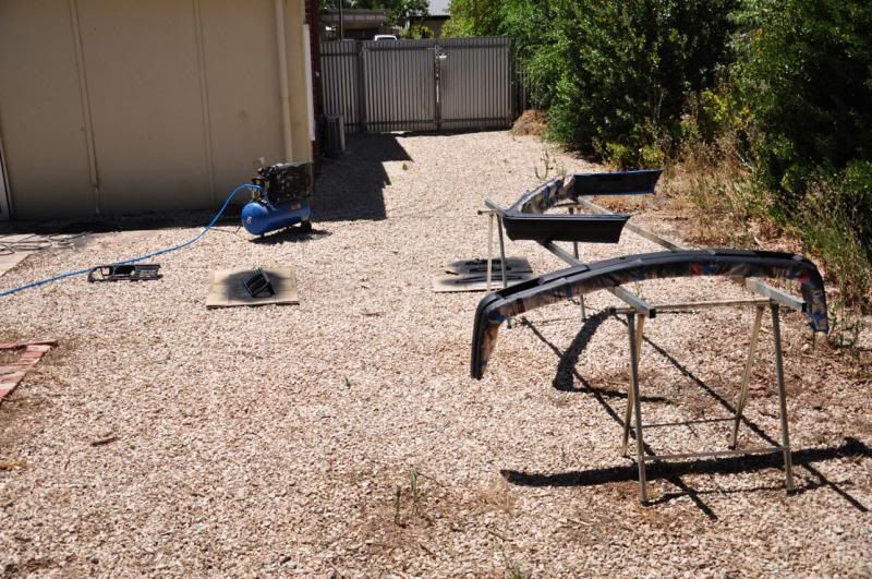

      I borrow my friends compressor and used the new spray gun that I bought. It started out a bit rough but ended up getting a pretty nice finish on the window trim. With a bit more practice I'm sure I can get it nice and smooth.
      Textured finish on the bumpers

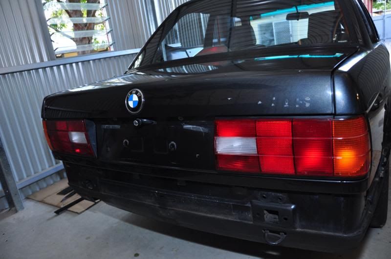

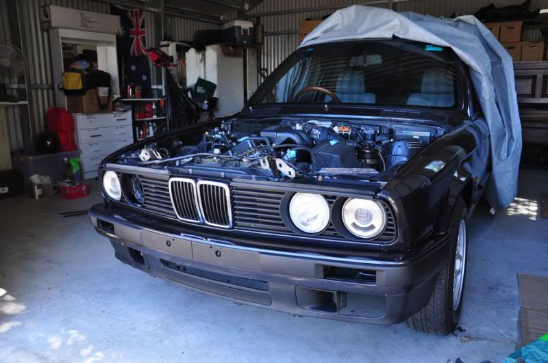

      I also took the opportunity to polish up the brake lights and started putting the back end on
      And then the front
      I'm still missing a high beam and the front bar seems to be a little bit misshapen around the passenger fog light area so the plastics didn't clip in properly but I'm sure I'll be able to get it all sorted out!

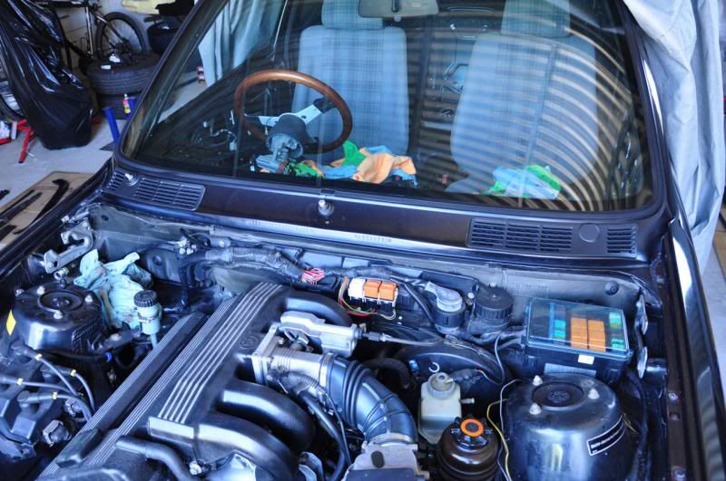

        Whilst the exterior has been going really well I have been having issues with the ignition since I removed the push button start (presumably the PO put it in to circumnavigate the issue). At first I thought it was the ignition barrel but a new one didn't help. Then the ignition switch, a quick trip to the wreckers later but still no luck. I have also put in a new battery because the old one was stuffed. Basically when I turn the key nothing happens at all, it doesn't try to start, no relay clicks - nothing. Has anyone else had a similar issue or know what might be the issue?? It's driving me insane because I just want it to start again!

              I did end up getting the ignition fixed and put the car back together but had to sell it because I moved to Melbourne and couldn't take it with me. I'm in an apartment now too and unfortunately don't have the room for such a big project. I toyed with the idea of buying a really good condition 325is but have had to delay it for a bit.
