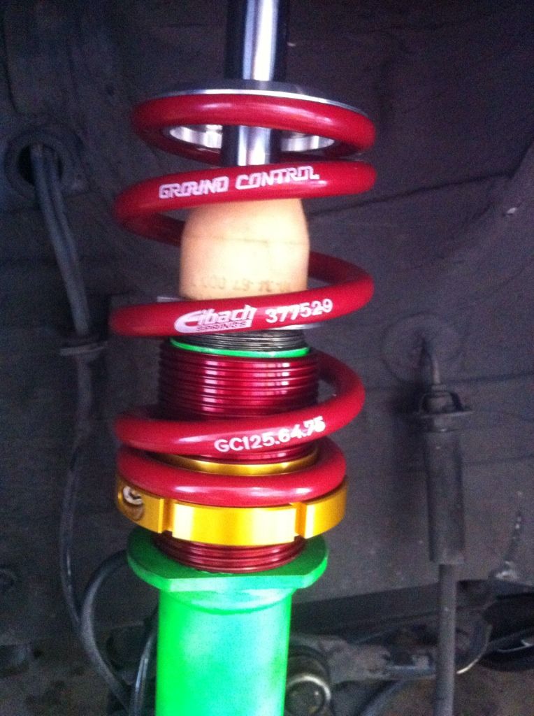

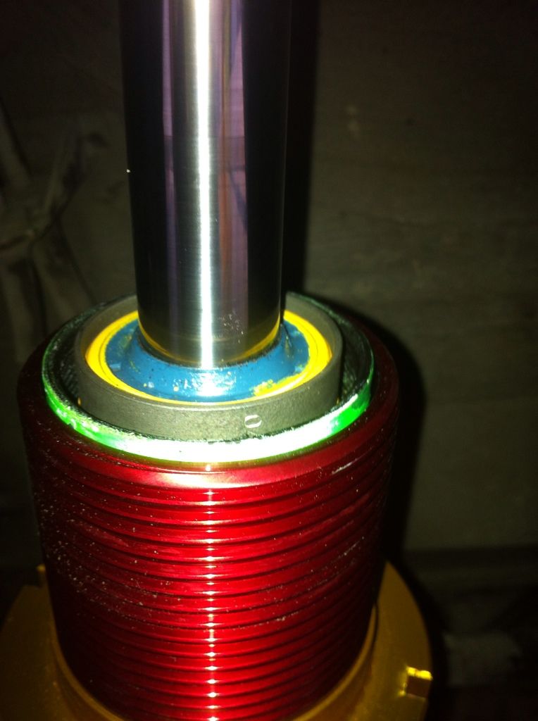

    Well damn, there seems to be no easy way to get those on. I won't drive the car tomorrow and I'll call you in the afternoon to clear some things up.
    Does anyone have any tips on how to get those on? All I need to do is take the top hat/black strut mount off. I don't really want to have to drop the entire housing for this because well...it's a major fucking pain to do.

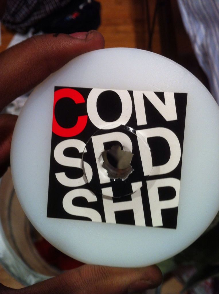

      Well...I didn't install either of them. They fit fine without the metal ring, and the white plastic piece fit really crappily around the strut insert so I didn't put it on. It would be pretty easy to put it on later if someone confirms that it's important.
      No pics yet (too lazy right now) but I got the coilovers on front and rear, put on AKG CABs, and an eknight cross brace. I have to say that I literally noticed zero extra vibration or harshness in the steering wheel or otherwise after installing race hardness control arm bushings. I need to upgrade my sway bar end links, I haven't decided whether to go with dodge stratus ones (bolts the sway bar down right by the control arm) or IE adjustable ones. I think the dodge ones may be a bit more effective, but may not allow for enough body roll, which could lead to understeer. Is that logic correct?

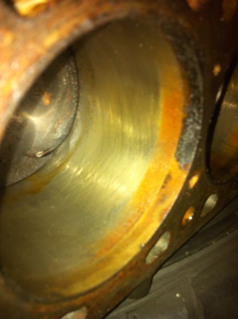

                    m50:
                    Cylinders look good:

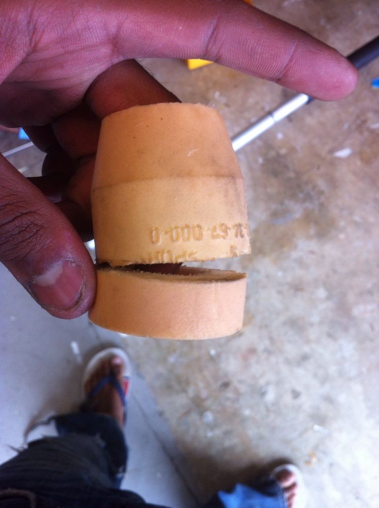

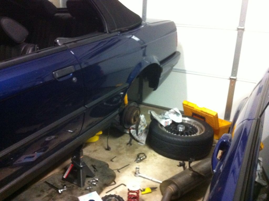

                    Installed these rings, bump stops, and the bump stop vents in the last hour:

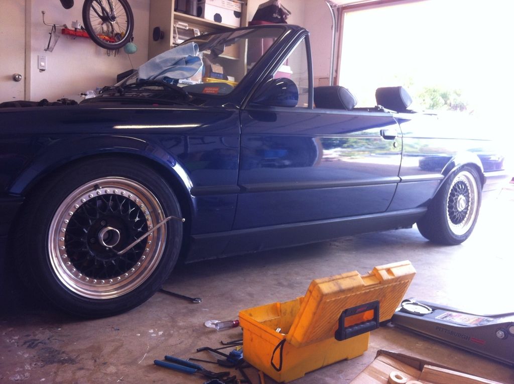

                    Ride height until I get new wheels and tires. Rears are all the way down, fronts are about as low as I can go and still have travel. I need camber plates :(
                    And to expel any thoughts of reverse rake:
                    Front:
                    Rear:

                      You shoulda saved up for two more weeks and had your housings shortened.
                      • lambo
                        Captain Scene Points
                        • 10953
                        #416
                        Yeah....that's like the same height I'm at and I'm spun all the way up...
                        • Vivek
                          attention whore/retard/bitch
                          • Oct 2011
                          • 6167
                          #417
                          It's not simply shortened housings, I'd also need shortened Konis which are also more expensive. With 17x7.5 et-2 I doubt I'll be able to run any lower any way. And camber plates will be about another inch less stack height, and I'll probably get them eventually.

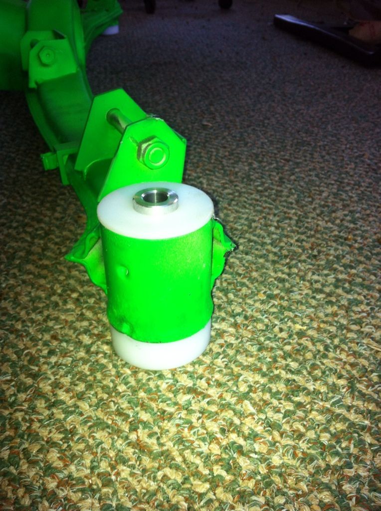

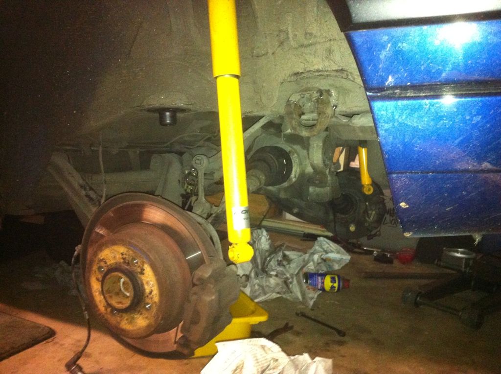

                              Installing today/tomorrow: IE TABs, Condor solid Subframe mounts and Diff mount.
                              Doesn't look like much was done, but all that's holding the subframe/diff/TA's on now is the diff mount and the two nuts on the subframe, that I already broke free so they're ready to come off. I just didn't want to do it today because it'd be sitting on a jack and I wouldn't be able to close the garage door.

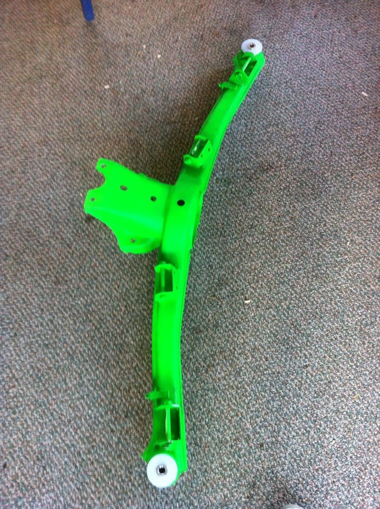

                                #420
                                Got the TAB's pulled out, just need to put the new ones in. New subframe is ready to go in. If all goes well, it should be good to go by tomorrow afternoon.
