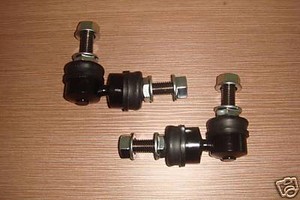

      No pics yet (too lazy right now) but I got the coilovers on front and rear, put on AKG CABs, and an eknight cross brace. I have to say that I literally noticed zero extra vibration or harshness in the steering wheel or otherwise after installing race hardness control arm bushings. I need to upgrade my sway bar end links, I haven't decided whether to go with dodge stratus ones (bolts the sway bar down right by the control arm) or IE adjustable ones. I think the dodge ones may be a bit more effective, but may not allow for enough body roll, which could lead to understeer. Is that logic correct?

        #393
        What do you mean may not allow for enough body roll? Are you saying that since the links are soo short it will not allow the swaybar to move as needed? Id say try the dodge ones, it will position the sway bar better than the stock ones. Once an e30 is lowered the link push the sways into an improper position.

          #394
          I thought it may cause too much understeer in corners since the front may be too tight. Does that even make sense, or am I misunderstanding it? It seems like the dodge ones could make the front sway MUCH more effective by pulling it down nearly 4 inches.

            #395
            Pulling it down 4 inches will make the sway bar more parallel to the ground, therefore putting it into a better position than with the stock links. As far as making the car under steer because it’s too "tight", I don’t think that will be an issue. Seeing as the stock sways are non adjustable. When running aftermarket adjustable sways you can adjust to make the bar tighter or looser, effectively changing how the car handles. Dropping the front sway bar down from its current height has to be beneficial as long as it allows the stock sway bar to move and isn’t solid.
            Please post pics if you decide to go with the dodge links. I’m really interested seeing as my front sway bar is also in the same predicament as yours.

              #396
              Would it be possible to pull it down too much? My front isn't low at all, so I don't wanna have any adverse effects. I'll have to look at how the sway sits right now and see if pulling it down that much would make it leaned forward instead of parallel to the ground

                  #398
                  Just put the Dodge end links on !!! It's working great... and you dont will notice any difference.
