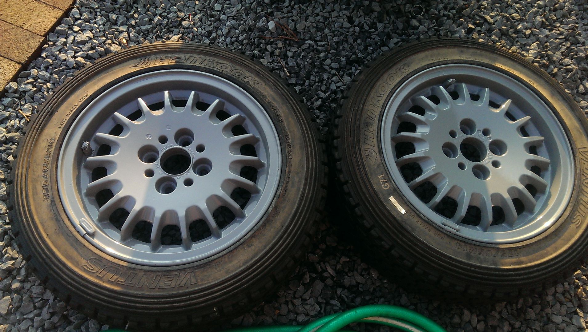

Finally snagged some wheel studs form Motorsports Hardware, since I will now be swapping wheels at the track as opposed to towing there on the wheels that I will be running. I have not had a chance to install them but I hope to do so before this weekend's event.
Unfortunately I have accomplished nearly nothing on the car over the summer. I was hoping to get the shifter assembly swapped out this summer but other projects and obligations have really hampered my progress. I also spent a considerable amount of time working on cars for friends and family, which has cut into time for the e30.
I did manage to get some things done on my truck and on the WRX, but at the expense of the e30.
Oh well...maybe someday I will get these parts installed.
