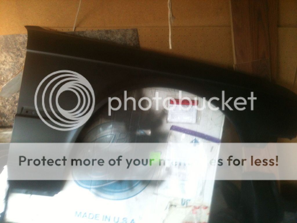

    Here is my car, there is rust on the rear arches which i'm going to fix soon, and i have two clean fenders and am just looking for a valance. Its going to be painted eventually but i think i may just sand down the current paint and spray paint it because i have a lot of little surface rust sports i don't want getting worse, and then it will match more.

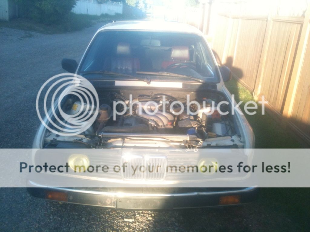

    Here it is
    Over 330000km on the body and current m20 but it still runs like a champ
    Also sorry for crappy iphone pictures but its all i Have

    One of the clean fenders

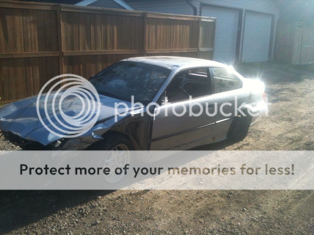

    So i bought a 1997 328i with front end damage for my swap. I am going to us the ZF transmission along with the drive shaft.
    here is the car after i was done with it.
