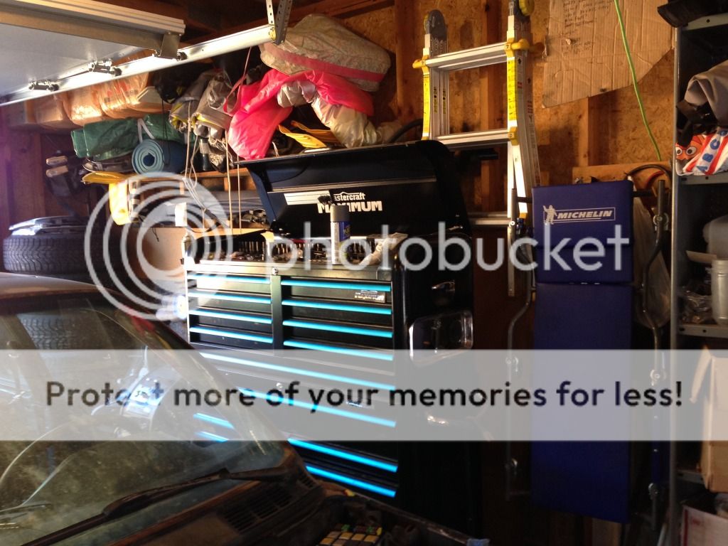

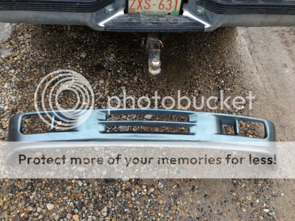

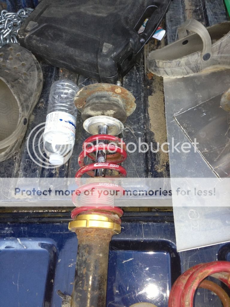

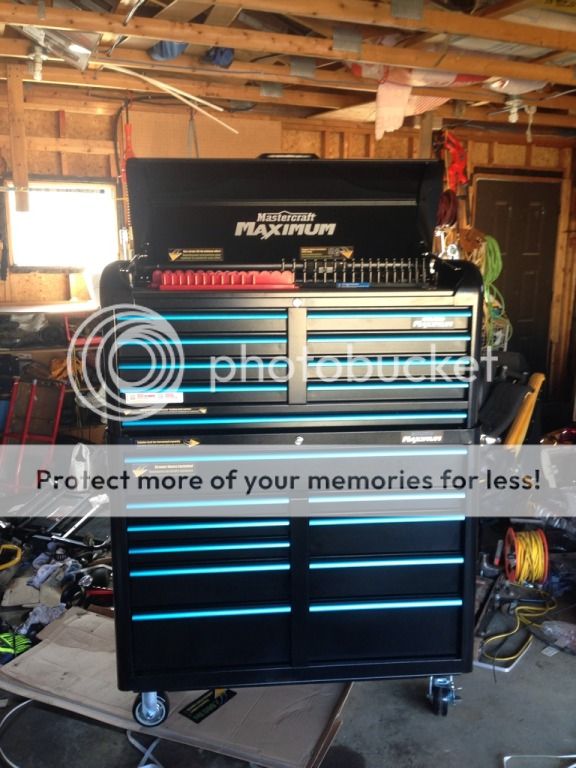

        Thanks! Unfortunately not much to update. I have been working a lot, and just organizing my garage before I bring the next car in. I have purchased front and rear plastic bumpers and I'm going to get the front and rear valance to put on, and an m tech 2 valance. I also got a sweet deal on bilsteins and vogtland springs. But here are some pictures of my new stuff, this is the tool box,
        The springs and shocks
        And the bumpers

            Nice, Im doing a similar swap into my 84. Mine already has the plastic bumpers. Front is super easy, but the rear will need to get trimmed. The tech section of R3V shows how to chop it up. Looks good after but the late model rear valence will make the car look amazing. The motor in the lightweight body will be a ton of fun.

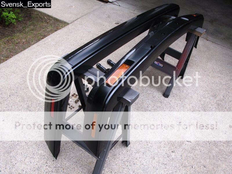

                and my rear valance
                And my mtech 2 valance, Its in great shape just a thick coat of crappy paint

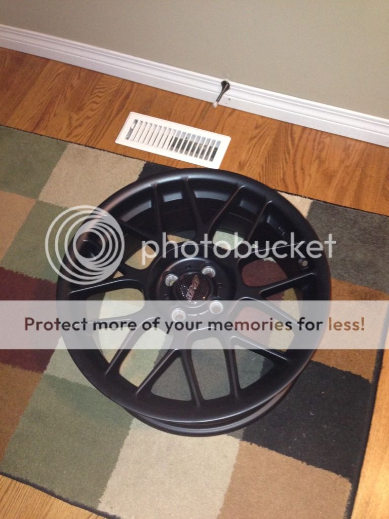

                  Apex Arc-8 17x8 satin black wheels

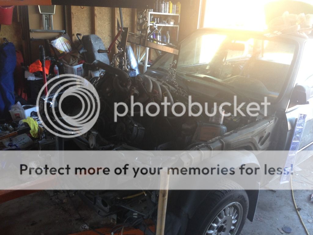

                    So i got the engine pulled today, it defiantly gets easier after a couple pulls. I had it out in about an hour.
                    Tomorrow im going to try and get the front core support removed, and clean up the engine bay.

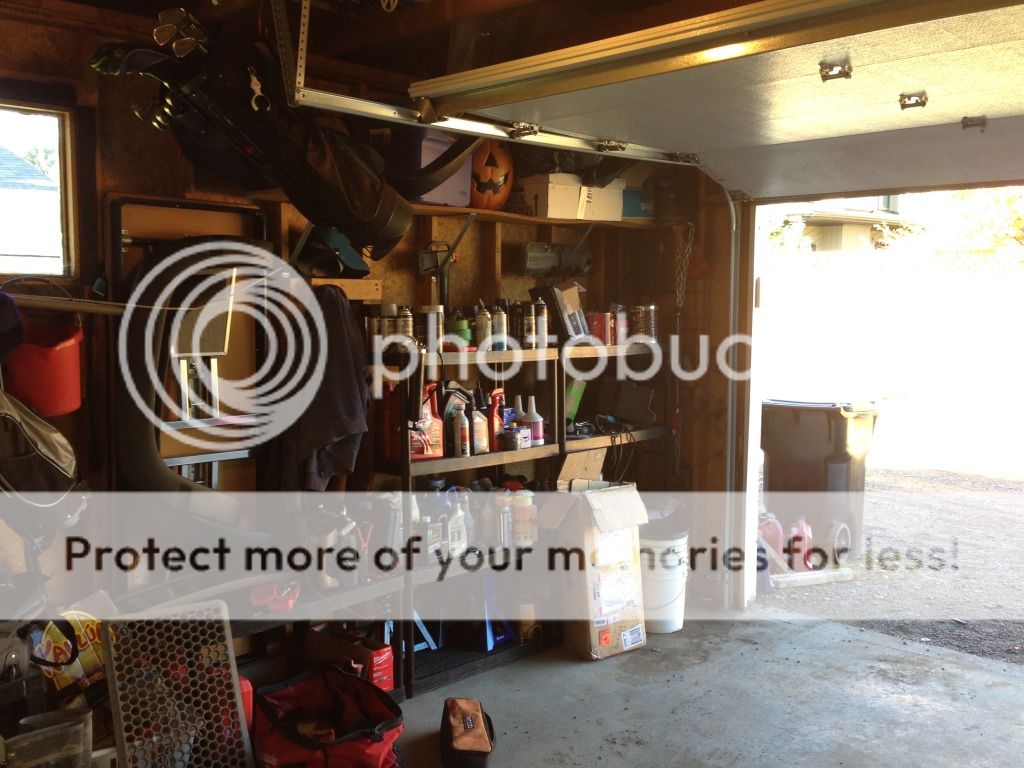

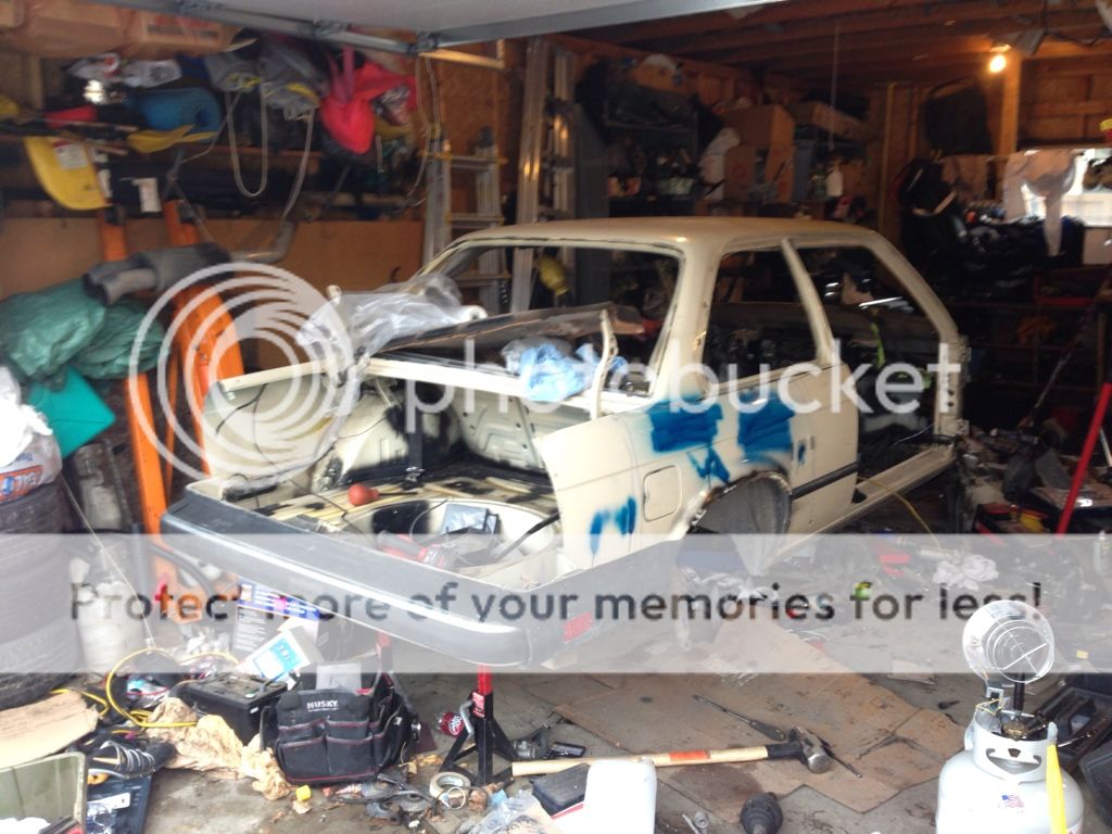

                      Well I did a huge clean up and organization project on my garage, now that its done i can actually work. Here is the garage now, still full but everything has its place.
                      So today i got the front core support removed, it has a couple extra bullet holes from the spot weld cutter, but it was my first time. I also cut out some of the brackets i wont be using. I also started removing the rotted sound deading on the firewall.

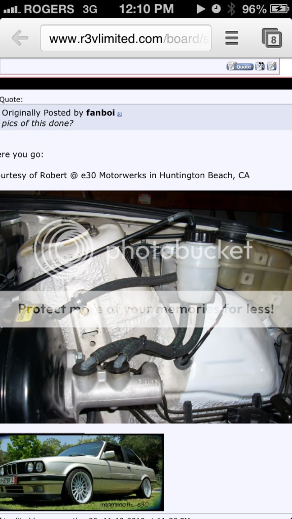

                        what are you doing for the brake booster/ master setup? I went with the iX setup for mine, but since I dont have ABS it created a small headache. Id recommend slotting the stock one over even though I still hate that approach

                          I am going with the e32 735i booster and master, with the 2002 remote reservoir. Like this
                          (not my picture but exactly what i want to do)
                          From what i have read everyone has been happy with this set up, and i lucked out and got the booster and master from my local junk yard to it was pretty cheap to get the rest of the parts.

                            do you have ABS? if not, you will run into the same problem as me. Non-ABS cars have 3 brakes lines going into the master, the ABS cars only accept two brake lines. We bought a factory E30 "T" splitter and had the two front lines run into the "T" then bend a new line from that, into the Master. The factory splitter is under the car in the back

                              No i dont. I see what you are saying, after you added in the splitter you still had good brake pressure? (you could still stop well). do you have any pictures of your set up?

                                I dont have any pics yet, but done right the brake pedal will feel the same as factory
