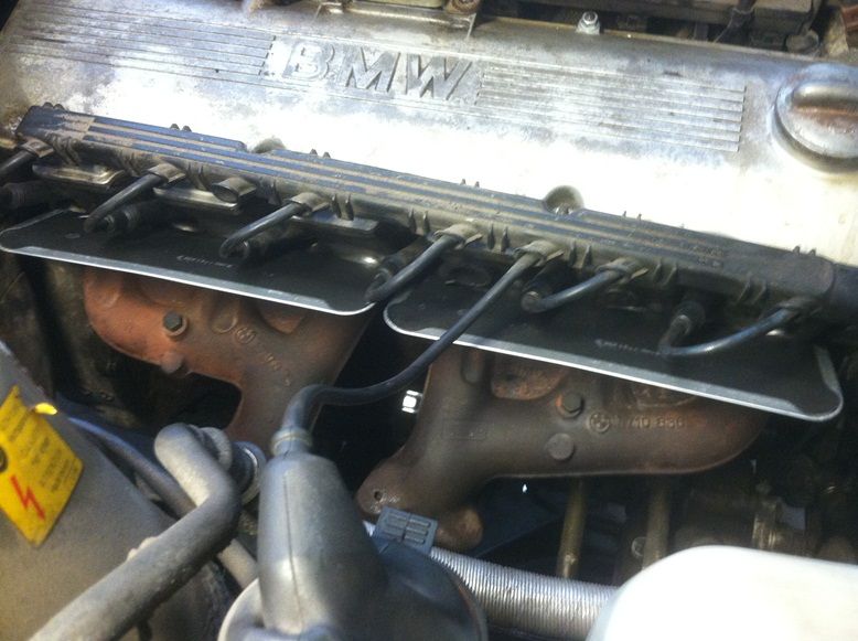

    First thing replaced is the old intake boot with silicon dabbed all over it.
    Next is the air filter. I was really curious when was the last time it was cha....holy shit
    New filter installed
    And everything back in
    Next up, the valve cover.
    Floor mat being used for a good purpose
    And the finished product! Coat seems to have pealed off, but looks much better than before.

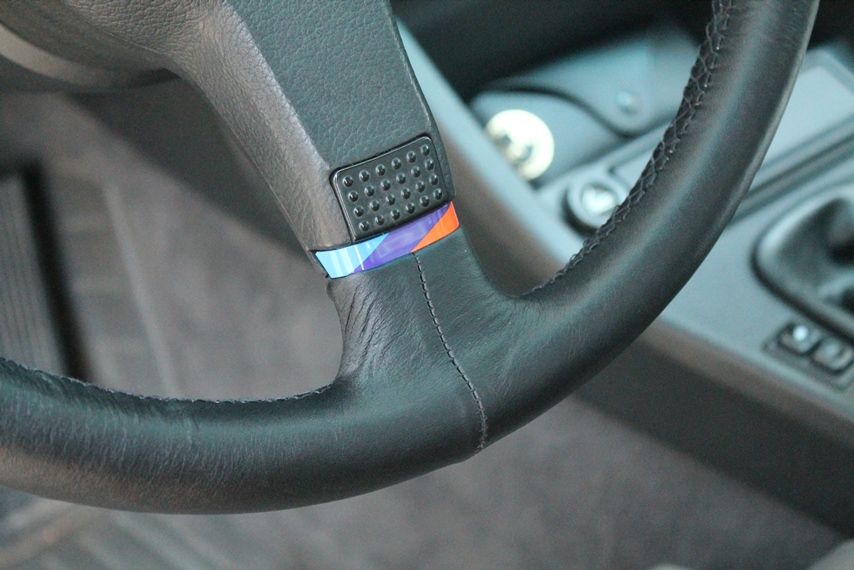

                  After a long contemplation, Ive finally decided to re-wrap the m-tech1 steering wheel. I love the design of this 3 spoke wheel, but leather was in awful condition. PO mustve never cleaned/conditioned the leather.
                  This definitely wasn't a quick and easy job. it took a lot of time and effort to make it look as close to OEM. As you will see in the pictures, re-wrapped leather has 3 stitched places on the leather unlike the original one stitch at 6 o'clock. This is because the leather hide I was working with wasn't long enough to wrap the wheel in one piece. I don't mind the look as this is how it looks on the newer model steering wheels with additional stitch marks at 10 o'clock and 2 o'clock.
                  Here are some blurry iphone pictures taken for before. Final photos look a lot beter :)
                  BEFORE:
                  Left side worn down to suede
                  Cutting the new leather
                  New vs. Old
                  Looks good!
                  AFTER
                  M-tech badge placed
