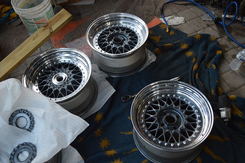

                              Finally found a set of red/gold BBS centers for a reasonably price and put them on today. Also since the last set of pictures I've got the trim around the windows back on and real plates.
                              DSC_0001 by yahh-, on Flickr
                              DSC_0002 by yahh-, on Flickr
                              DSC_0003 by yahh-, on Flickr
                              New BBS Caps 4 by yahh-, on Flickr
                              New BBS Caps 2 by yahh-, on Flickr
                              New BBS Caps 3 by yahh-, on Flickr
                              Think i'm going to swing by the yard one of these days and grab a set of focus skirts and a late model rear apron.
