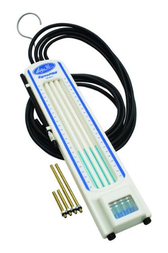

                    Guess Kameron has also faced this issue with RHD ITBs.. time to get a carb sync tool.
                    just ordered the same sync tool he used
                    https://www.amazon.com/Motion-Pro-08-0411-Syncpro-Carburetor/dp/B000K7JHWA

                                #330
                                ITBs are sync'd!
                                Here's what I was dealing with before syncing the ITBs
                                Here's where I ended up after fiddling with adjustments for 30 minutes. Both the adjustment screws and the throttle linkage needed adjustment to get things balanced. What worked best for me was to just disconnect the linkage from the ITBs first, then fit the linkage on.
                                It wasn't as simple as syncing at idle, as they tended to go out of sync under throttle. So I spent another 30 minutes or so trying to balance everything out. Best part throttle balance required the rear ITBs to run at a lower vacuum level at idle.
                                Now my idle is at 1400 again.. need to make sure my ICV isn't sticking..
                                Also unfortunately weather sucks so a long drive will have to wait. After that drive in I'll look at adjusting again to get the idle back down where it should be.
