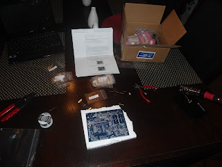

      I think I may have taken more then I can chew with assembling the DIYPNP MS box from scratch as a kit.... :? confused as hell!!
      stay tuned...

                        started soldering my cars new brain... should be done soon...

                          #42
                          Almost done...

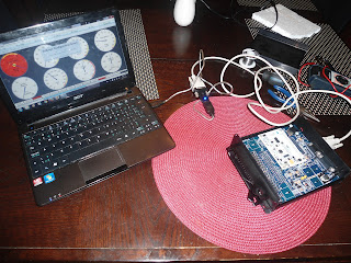

                            After much time spent building the MS box.... I ran into an issue where it would not connect to the PC com port...with a LOT of help from Keith "whodwho" on R3vlimited.com this guy knows his stuff. I finally found the problem ..corrected the backword diode and voila !! ready to go!
                            Next is install the IAT into the intake, install new vaccum line to MAP sensor and start tuning!!
                            the tunerstudio software is AMAZING!! wow finally I can tune my car fully!!

                              I was amazed and how intuitive tunerstudio is the first time I fired it up. Glad to see it went together fairly painlessly.
