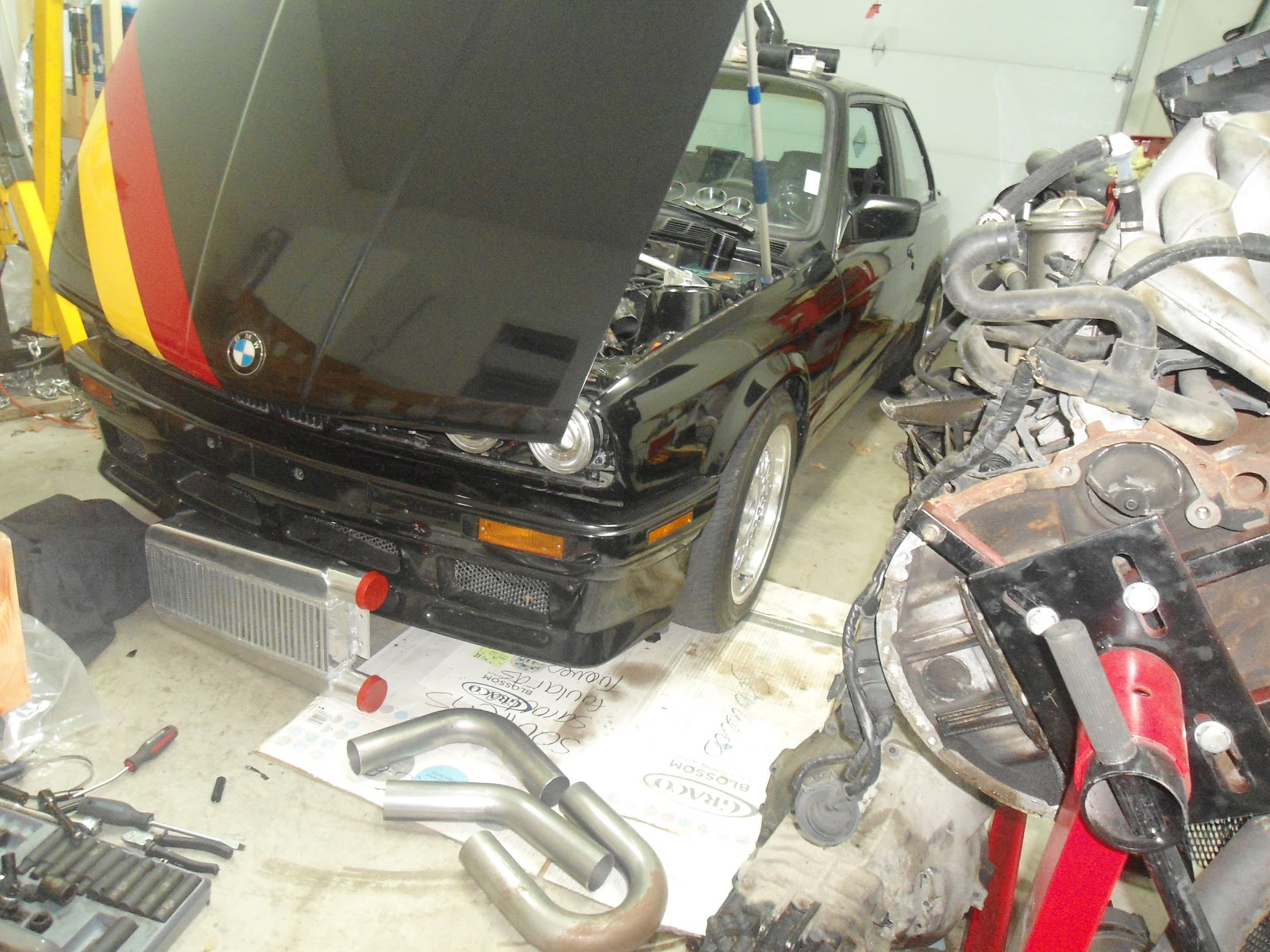

      Part are starting to arrive... Got the new SuperCharger intercooler and some mild steel 2.5" bends. According to Corky Bell in the book "supercharged!" the best intercooler setup is like this one. The best way to cool air is by having more channels then long channels which makes total sense.
      So the small original Audi intercooler I used before will be moved to the turbo side to cool the turbo air before it enters the Supercharger. It looks like a dirty mess right now but everything will be removed cleaned and re-painted wrinkle black.
      So right now am waiting for my ARP head studs, 60# siemens injectors and yes believe it or not ALL the turbo components are ordered including exhaust. So it will be out with the Headers soon (for sale) and full exhaust (for sale) as I have a 3" full cat back on the way too..
      Stay tuned it wont be long before i have the first Twincharged M20 started :)

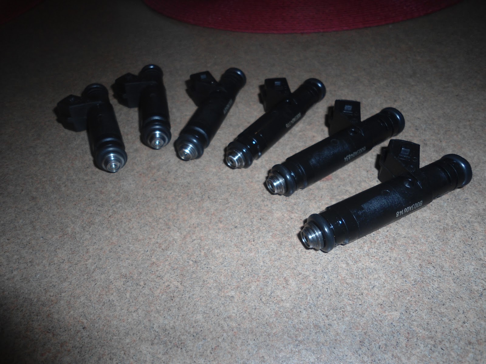

                60lbs DEKA Injectors are in....these should be good for 450-500HP (out with the 30lbs for sale)....
                Features:
                Genuine, reliable Siemens Injectors
                Excellent response characteristics
                High Impedance
                Low Impedance performance characteristics with High Impedance Compatibility
                Specifications:
                Coil Resistance: 12.5 Ohms / High Impedance / High-Z (No ECM driver modifications required)
                Static Flow Rate @ 43.5PSI ( 300kPa ) w/Gas: 60 lb/hr = 630 cc/min = 453 g/min
                Static Flow Rate @ 87PSI ( 600kPa ) w/Gas: 85.7 lb/hr = 900 cc/min = 648 g/min
                Gain: 0.11ms/mg
                Offset: 0.055ms
                Turn on time @ 14VDC: 1.14ms
                Turn off time: 0.85ms @ 600KPa
                Connector: Bosch EV1
                Series: DEKA 4 ( DEKA IV )
                Orifice Type: Multi-orifice
                Spray Pattern: 30 Degree Spray Cone
                Factory fitted with Viton upper and lower o-rings
                Denny

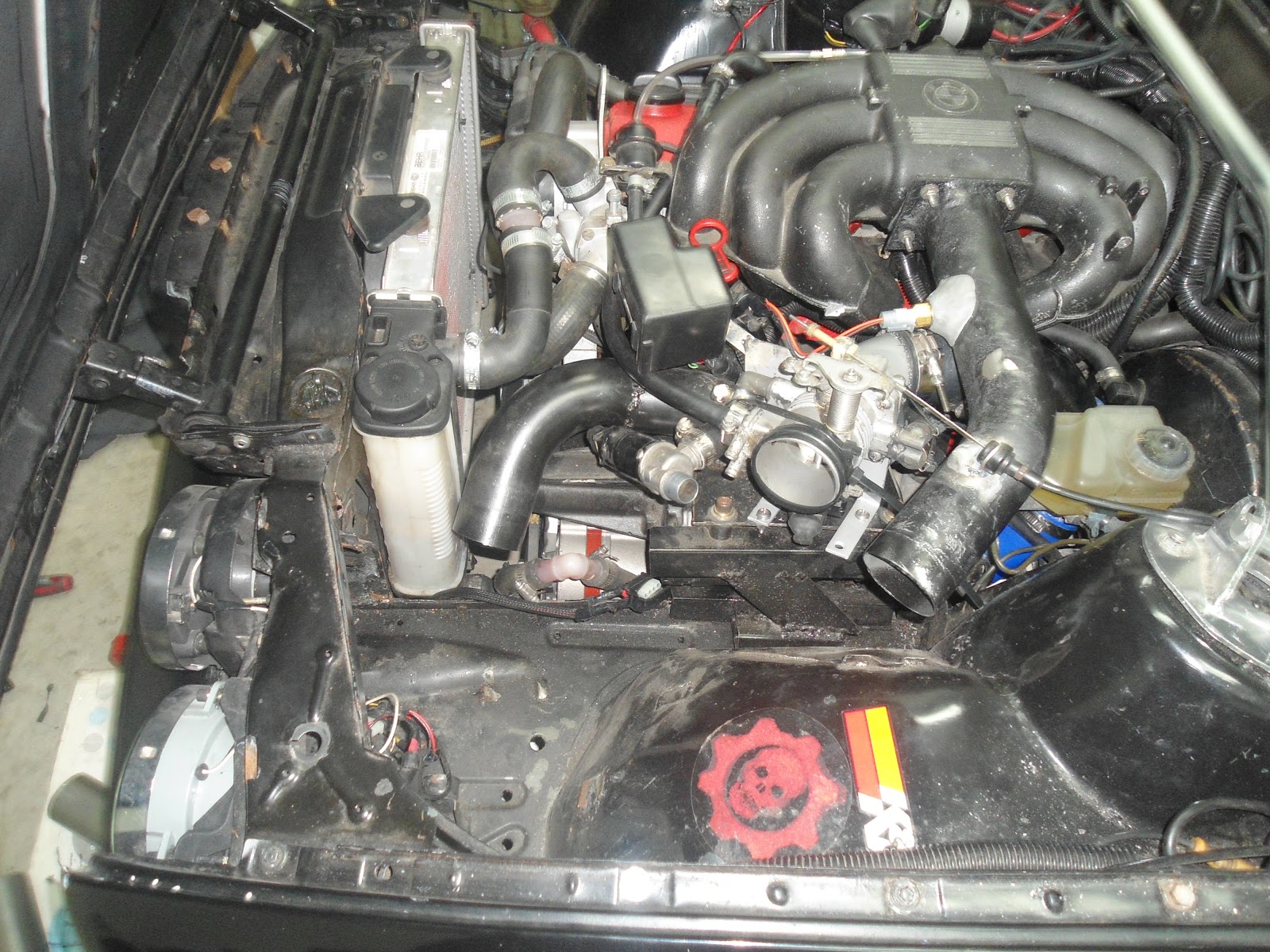

                    Does your AIT get a good reading mounted like that on your intake pipe?
                    Project log -- DIRTY 30
                    2.7i * Megasquirt tuned * E85 powered
                    • kamotors
                      • Nov 2007
                      • 7102
                      #85
                      also just noticed your IAT sensor seems to be JB welded on. Boost and heat will peel that off like a scab. that's what happened to my methanol port on my first setup and also on my oil pan fitting after 6 months of use.
                      7speedshop.com
                      • Denny
                        • Jan 2010
                        • 822
                        #86
                        Originally posted by kamotors
                        at first I had a hard time getting the car to rev smoothly with the 60lbers. I had to change the deadtime to get a proper idle. I believe they include a little spec sheet that use can use.
                        I was going to ask you if you could show me you injector settings on tuner studio?
                        yeap it does. Its quite deep in the pipe and as close to the intake as possible...just the angle on the pictures.
                        Actually its MIG welded on I just decided to use the remaining HIGH temp JB weld I had to cover any pin holes. I would never just JB weld anything trust me I learned that lesson a lonnnng time ago but thanks for bringing it :) what I will do is grind it all smooth and paint it properly.
                        Denny
