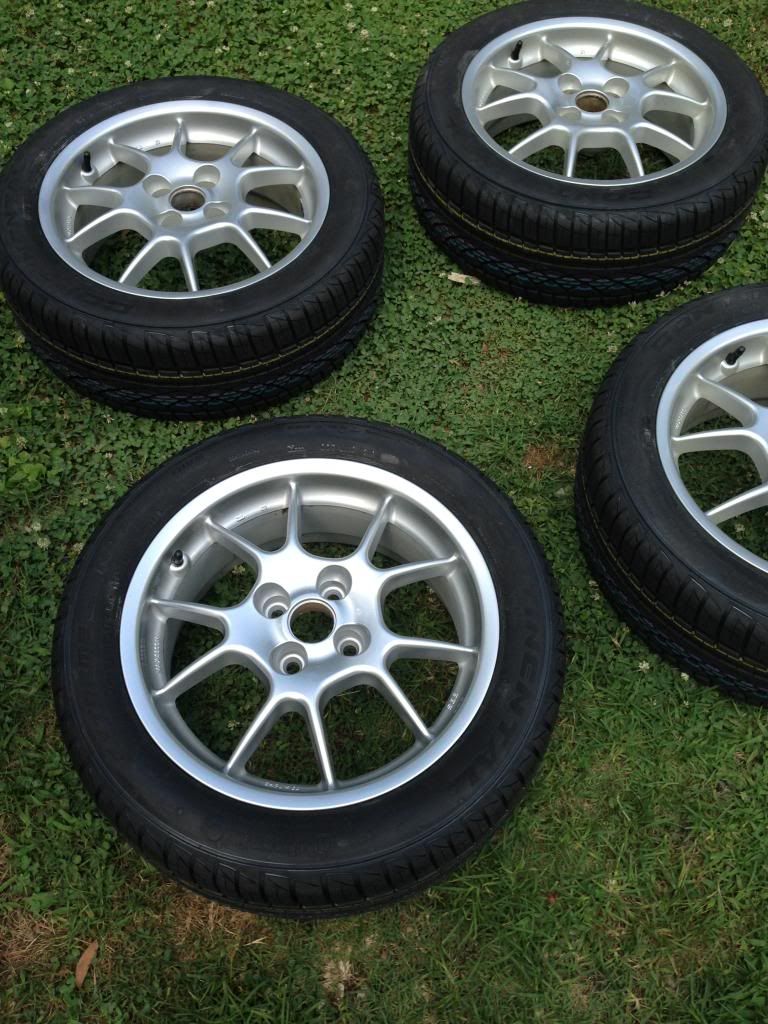

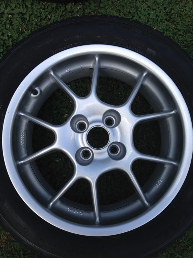

                    The car has been up on blocks for about a week now as I slug my way through the rear subframe (more on that later). Some of you may have read my thread about the challenge of getting the bushings to drop so I wont repeat that here,but for the moment Ill share what just got delivered...the 16" RKs that I bought new 12 years ago. They are freshly shod with Conti Extremes DWS and were just refinished.
                    Im still thinking red/gold centre caps :)
