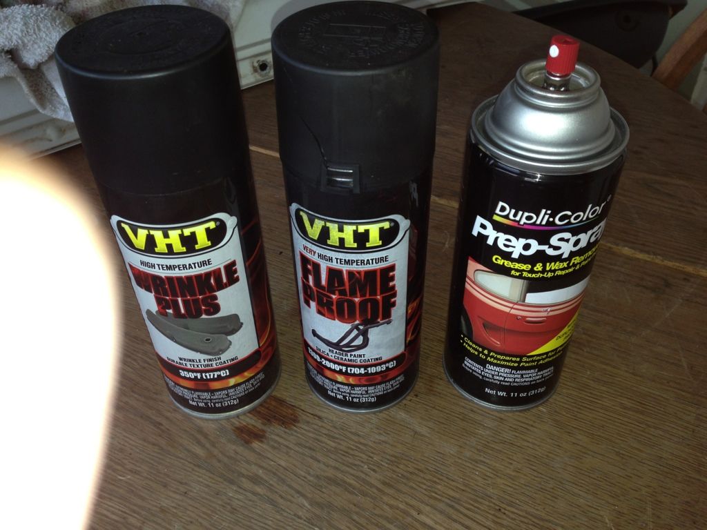

        Besides the injectors I actually managed a couple of other improvements that I've again long thought about, but never done. Who loves cosmoline ?...I figured as much so how about this:
        The pic above are after some healthy scrubbing with degreaser, Simple Green & a surface prep followed by high temp primer.
        There was no way I was going to tape off all the highlights prior to the final coat so I applied the wrinkle coats, baked it as directed (which went over big in the house as you can imagine) and THEN took 220 grit to the highlights to arrive at the finished manifold.
        Then the valve cover...1st primer coat
        2nd primer coat
        and the final baked Wrinkle coat with the bright silver features AND mocked up with the stainless acorn nuts and copper washers
        This is the stuff I used for the intake and valve cover
