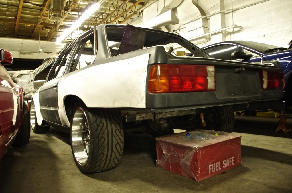

          Okay here we go. Sorry for the lack of updates, working 50 hours a week with school and this car doesn't leave much time for things like this but I have eyecandy for everyone.
          The front and rear end has been chopped off and is ready to get its tubes. The fuel cell will also go in, and a 3L sump with dual bosch 044 pumps is on its way from Aftermarket Industries.

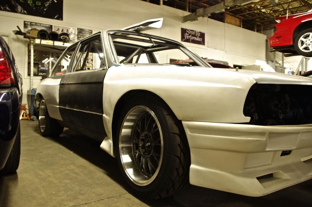

          Huge thanks to DTMFiberwerkz for collabing with us and getting an evo wide body for the car. The kit looks amazing and its really going to let us have lots of variability for running wider wheels and tires. We need to play around with spacers to get solid fitment all around. For rubber we are running Achilles 123s 235/45/17 in the front and 255/35/17 in the rear. Big thanks to them as well for their support.

                  The rear end is nearing completion, just waiting on the fuel sump kit from Aftermarket Industries

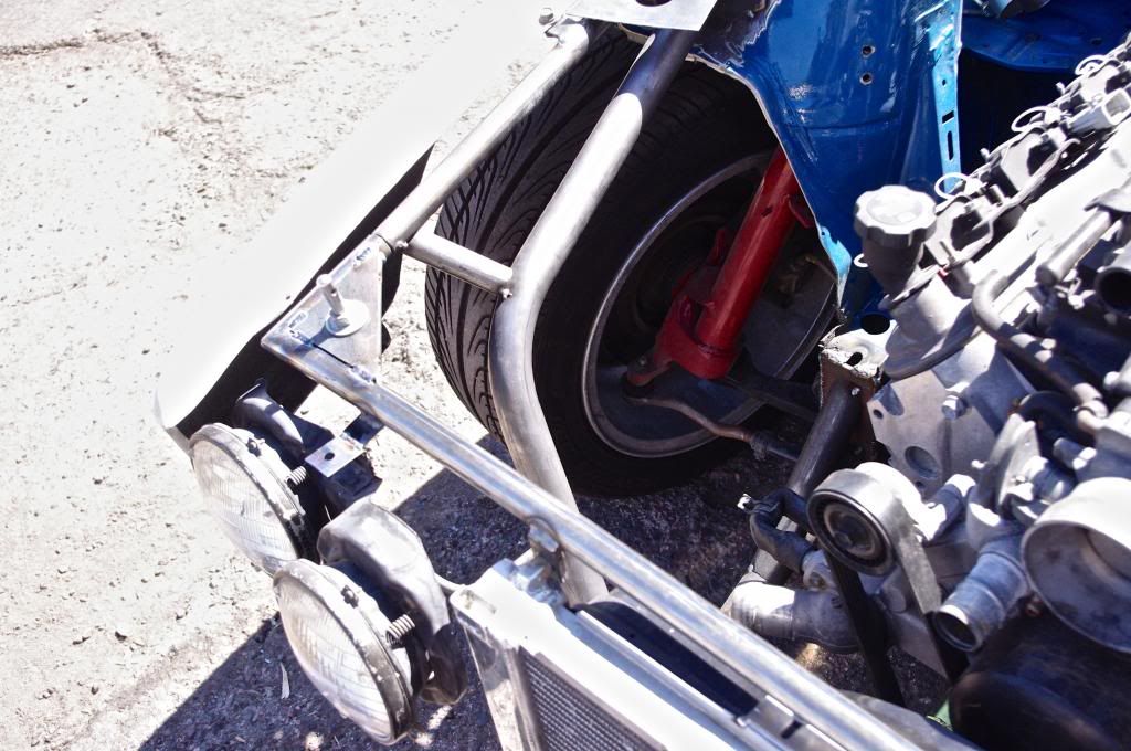

                    Mocking up the front end, bash bar is next. The top support will be pinned in and will be able to slide completely off to make pulling the motor/trans a breeze.

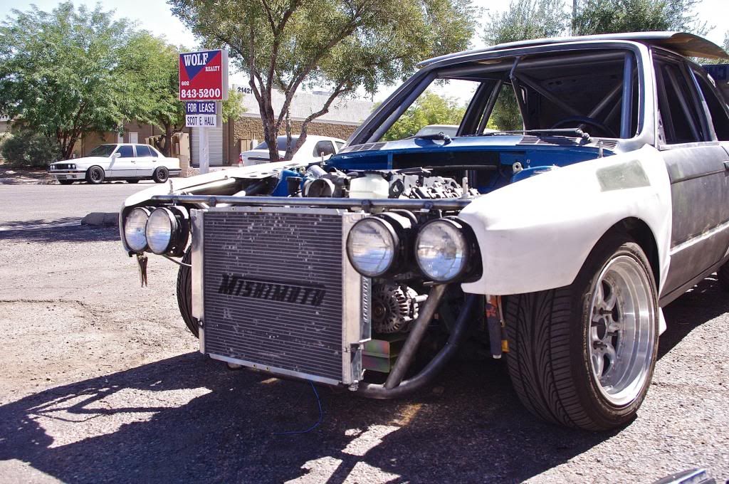

                            Moroso front sump pan, and we'll be running manual brakes with a wilwood pedal box

                              Looks like the pan has good clearance! Any plans to run an accusump?

                                Yes clearance is very good, no plans for accusump right now but the build is endless honestly so in due time.
