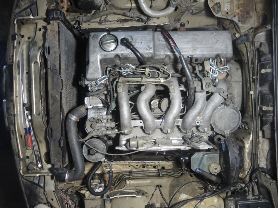

                2.5 liter 5 cylinder with a 5 speed, no turbo.
                It is what it is. Learning about drive-shaft angle now. Shooting for 40 M.P.G.. I beat the shit out of the passenger footwell with a bunch of hammers, for the exhaust. It looks good...trust me.

                  Nice progress! BMW doesn't use a driveline angle, the centerline of the crank points directly at the center of the input flange of the diff giving a straight driveshaft. The input of the diff is slightly off center so the straight driveshaft hits the diff at a very slight angle.
                  If your driveshaft is going to have a u-joint in the front and rear you could straighten the engine in the chassis and run equal and opposed driveshaft angles in a horizontal plane. If you do this, try to keep the angles in one plane only and have at least 1 degree of angle on each end so the u-joints will rotate and not wear out too quickly.
                  Lorin
                  The M30 is God's engine.

                    I'm going to try and use a laser pointer from the output shaft of the transmission, to line up the engine and transmission with the rear axle flange.
