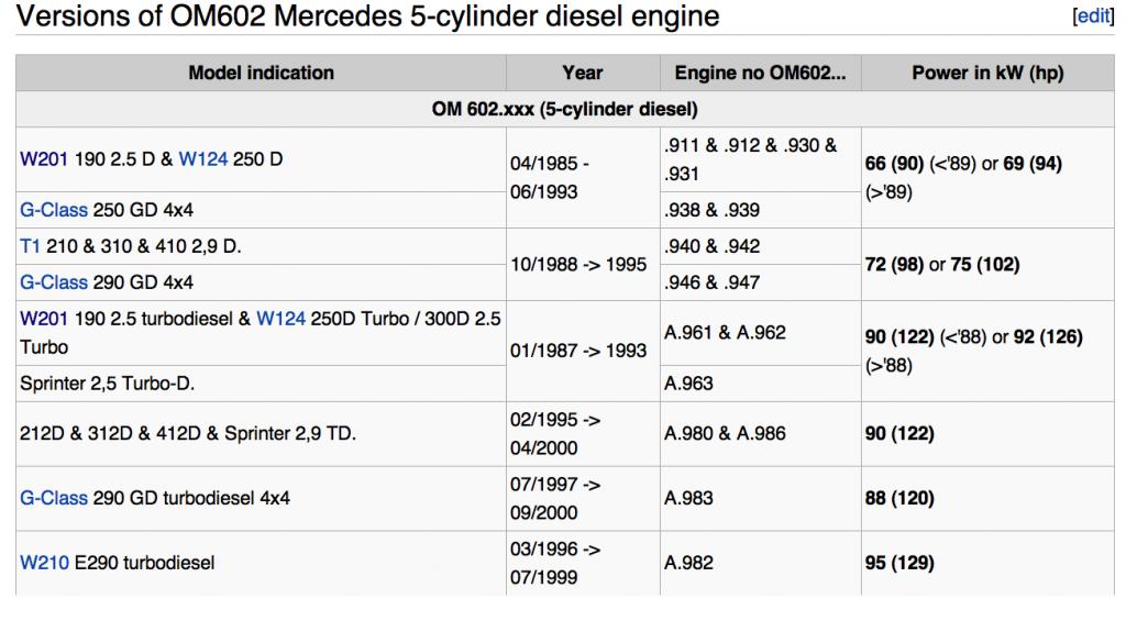

    om602 Mercedes 2.5l turbo mated to a 5 speed. 38ish MPG Supposedly very reliable.I'm leaning toward this mess, right now. I can have a star on my hood.

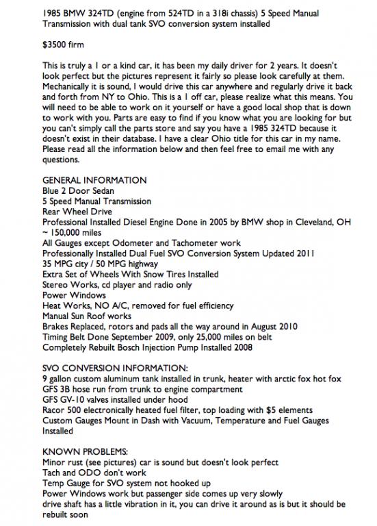

          The E30 came with the 524TD's engine in europe. Its been done many times. I think the 260 will bolt right up.
          Next winter im seriously considering assembling a beater E30 eith the M21 turbo Diesel. 40 MPG Diesel goodness.
          There was one being sold in the Albany area just about two weeks ago.

                      Person from the advertisement says, "35 MPG city, 50 MPG highway". "Woop, woop!
                      Pretty cool. Thanks for the link. M21's are full of fail, in my book. Unless, they are updated. Cam, MLS head-gasket, 12mm head studs, re-weld cracked head, injection pump plate, etc. I don't want to "build" an engine.

                        I say M57TU2D30.
