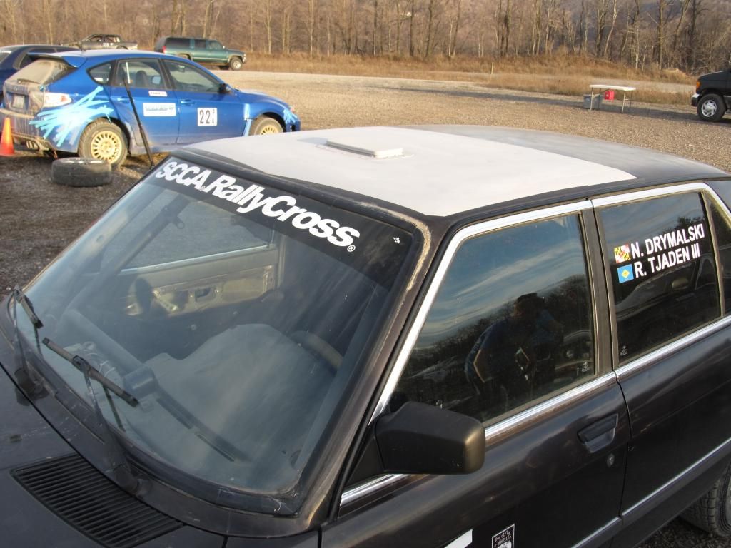

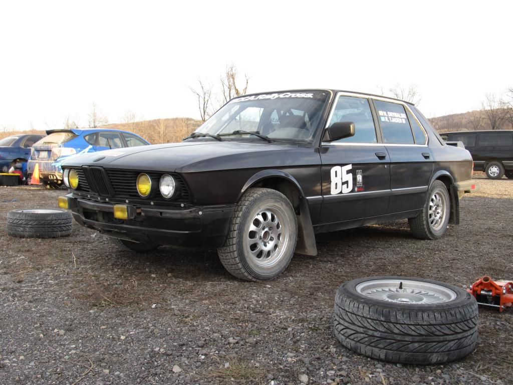

    So I finally put on the proper windshield banner...

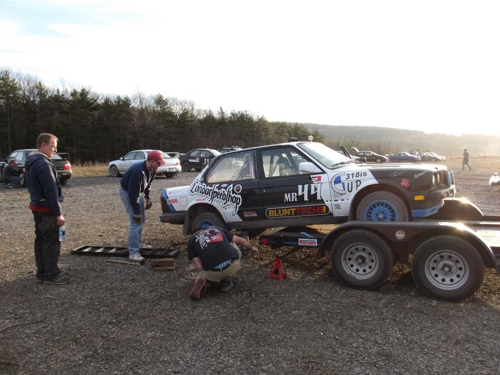

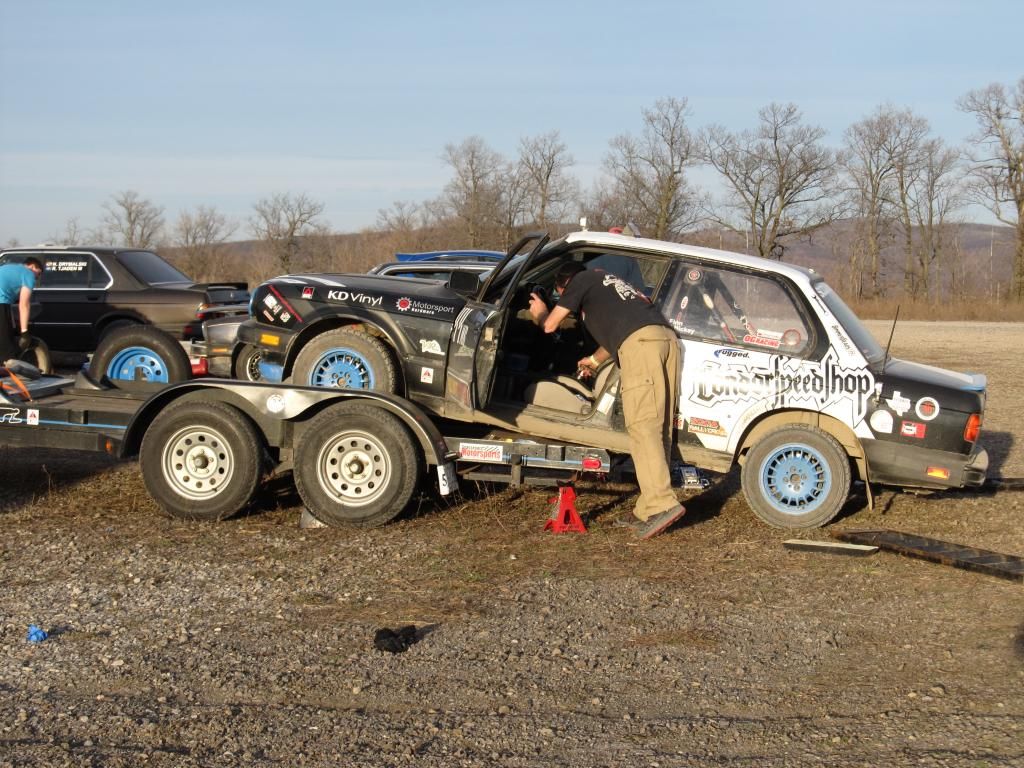

    Oh, and to make the weekend even worse for Josh, his ramps decided to slip off when he was putting his car on his fancy rich-boy trailer. Naturally, I declined to help and instead took pictures while pointing and laughing.

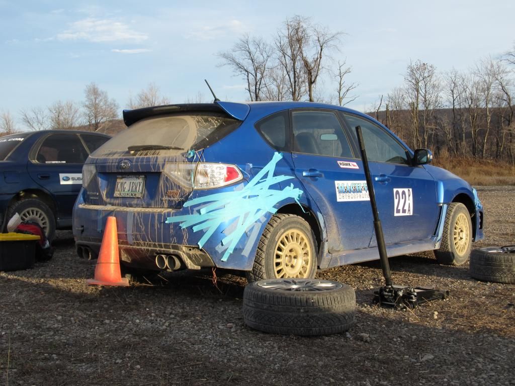

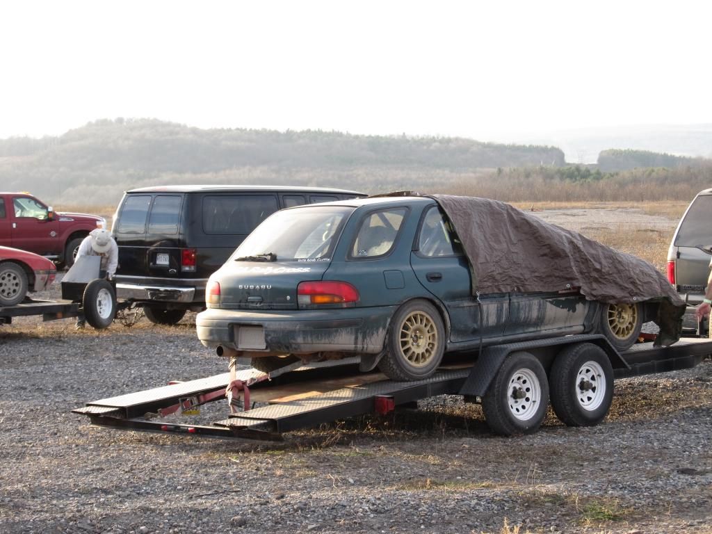

    Here's a pic of Jeremy's STi, aka the cone killer. And bumper killer. This was the first event where he didn't rip it off at some point. I think some sort of bet was involved.

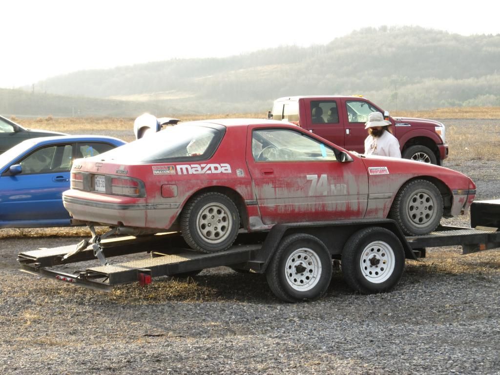

    Here's a pic of the previously mentioned FC RX7 driven by Shawn and Katie. It's pretty much stock, but damn does it seem to effortlessly connect corners and drift like it's a job. It's a complete POS (it requires bump start to start and can't hold an idle without a foot on the gas), but it's totally awesome and embodies rally-x spirit.

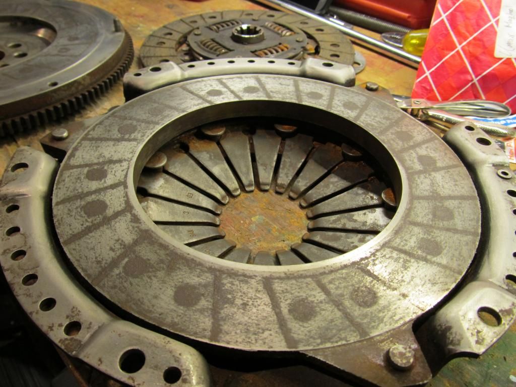

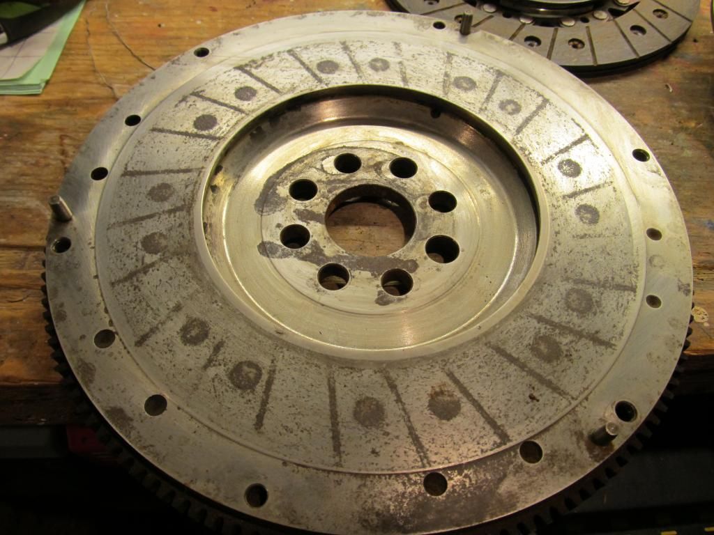

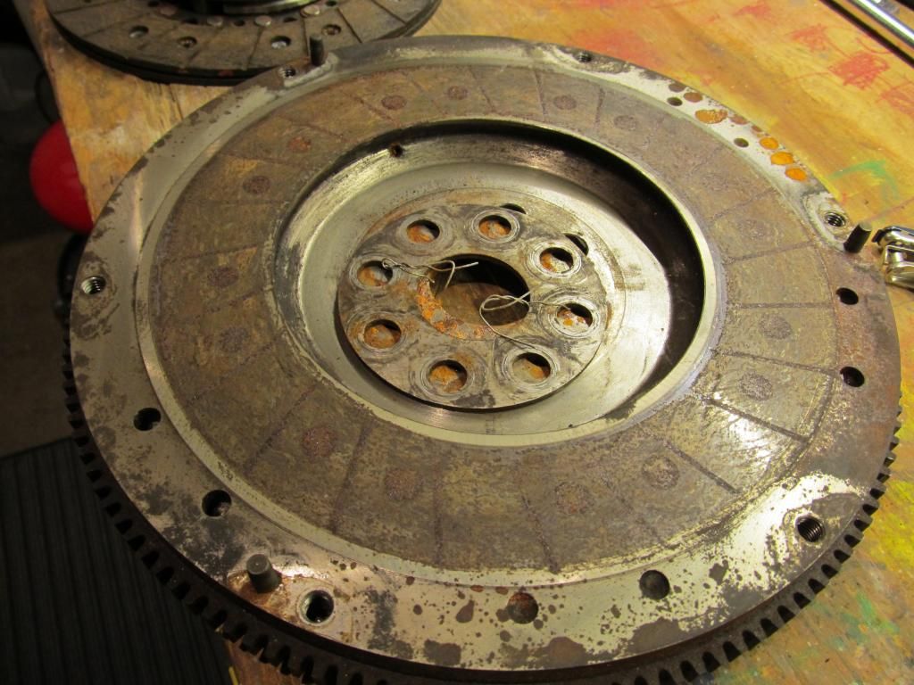

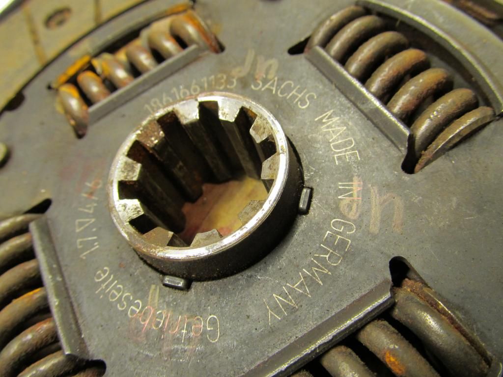

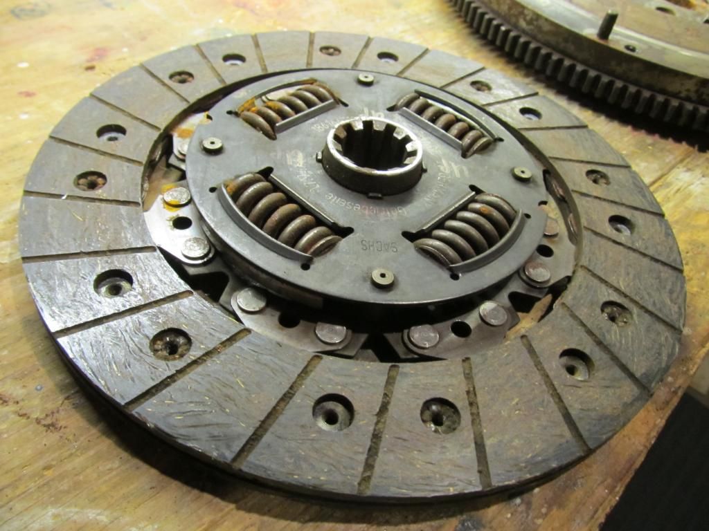

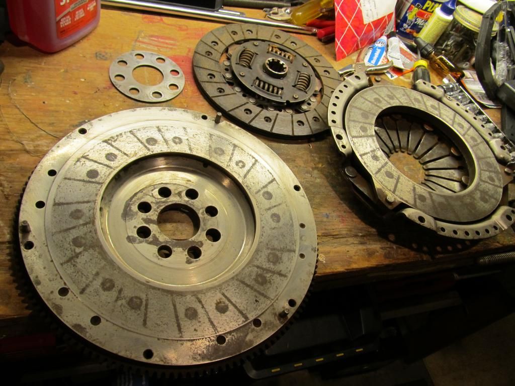

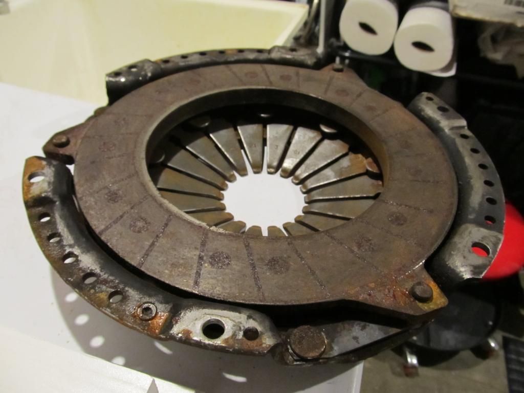

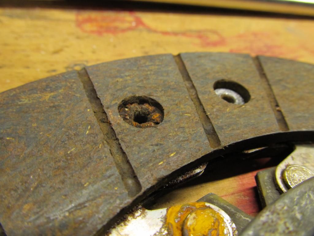

                        With the 2015 season right around the corner, it's time to start furiously looking for parts to freshen this thing up and get it ready. The first thing to arrive was a used single mass M20B25 flywheel and clutch. There's no way we were going to spend $800+ on a lightweight aluminum flywheel/clutch combo, but with a 27.5 pound flywheel, something had to be done. After seeing rather high prices on the forums, I spent some time searching on car-parts.com and found one hell of a sweet deal. I found a junkyard that had pulled them out of a car and I was able to get them for only $85 (shipped)! From what I've seen, the "i" flywheel weighs about 18 pounds, which is rather substantial reduction from the stock dual mass unit.
                        It looks like it had been sitting around for a while, and there was some surface rust buildup on the flywheel and pressure plate. I cleaned them up a bit with a scotch brite pad, and I'm thinking they look good enough to throw in the car, but I'm no expert. Does anyone think I need to get the flywheel resurfaced, or need a new disk? Since it all came out of the same car, I figure there's no reason why I can't just slap it in mine and go. There appears to be enough material left on the disk. Let me know if you think otherwise!
                        Clutch disk:
                        Close-up of depth:
                        At least it's a Sachs!
                        Flywheel before:
                        And after:
                        Pressure plate before:
                        And after:
                        A big happy family
                        Obviously, I'm going to have to spend a fair amount of money on the little things:
                        -Throw out bearing
                        -"i" flywheel bolts
                        -Pilot bearing
                        -Brass pivot pin
                        -Clutch fork, spring
                        -Amsoil fluid
                        -Seals, Etc
                        I can reuse the bolts holding the pressure plate to the flywheel, right?
                        But even so, I'm hoping to get this installed for less than $200. I'm really hoping that shaving 10 pounds of rotating mass from the motor will really wake this thing up, but who knows.
                        More coming soon!

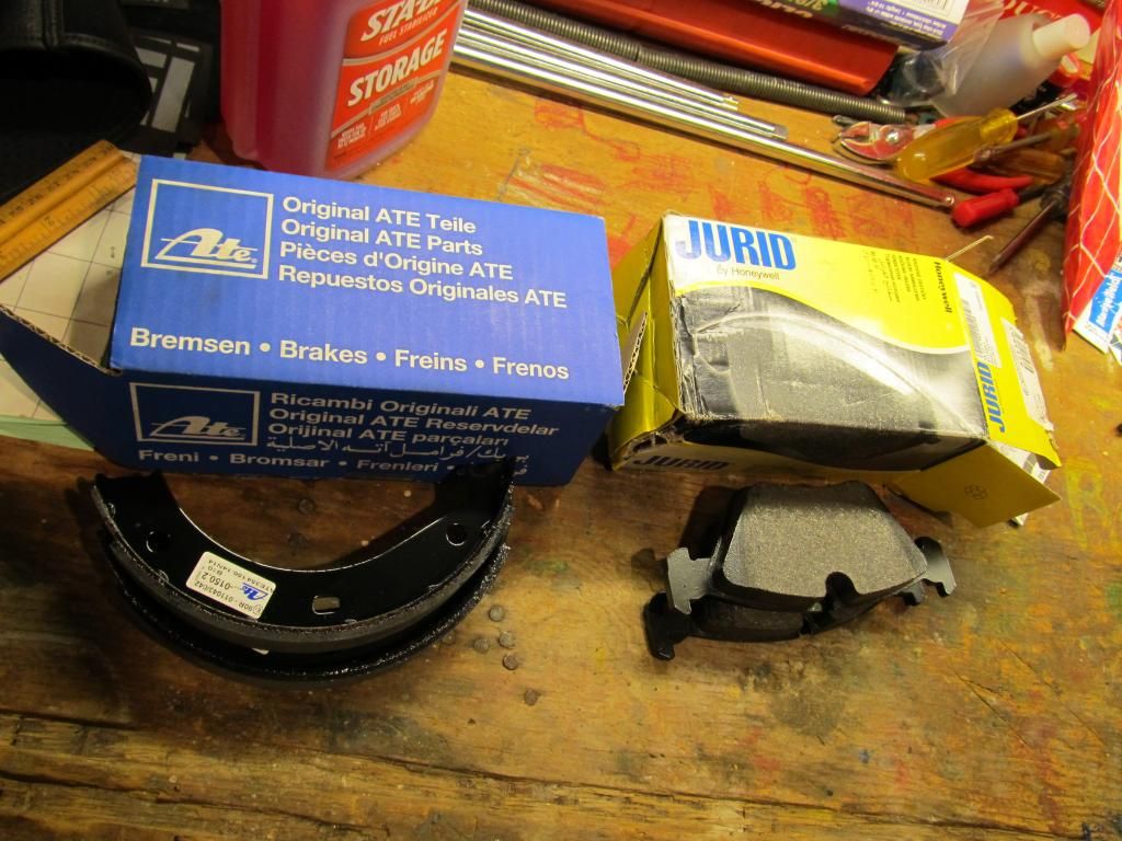

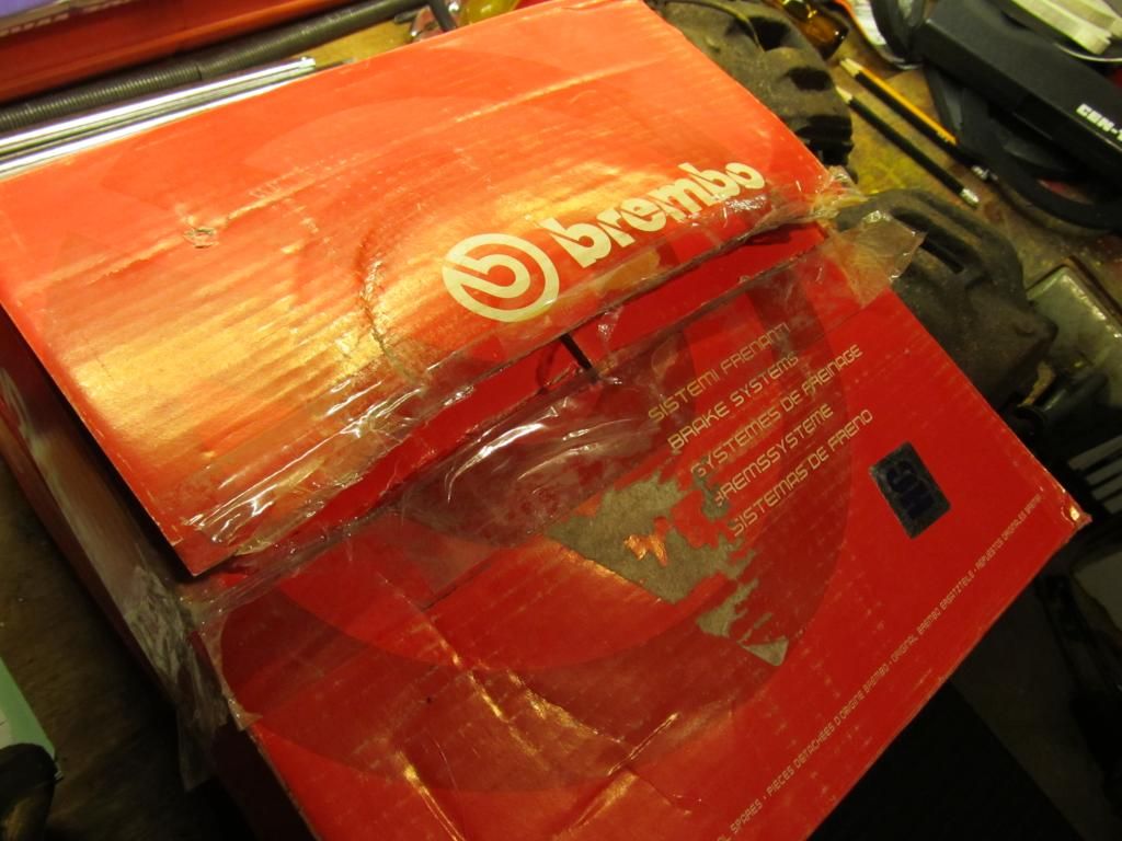

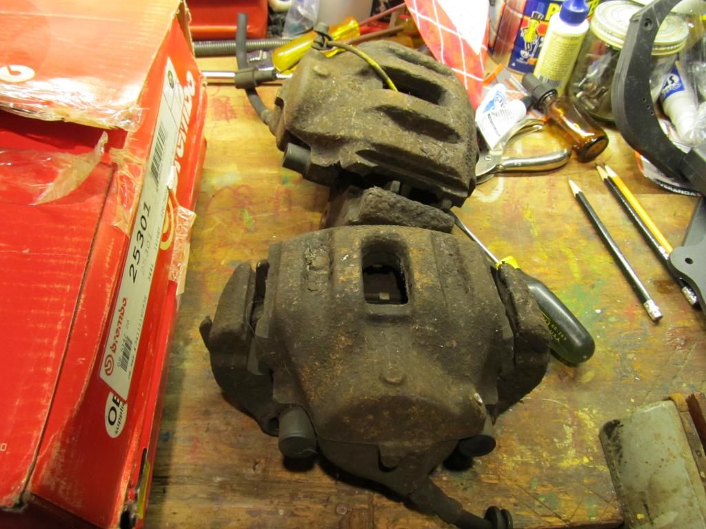

                          I've always been rather disappointed with the brakes on this car. Driving Josh's 318 really drove the point home, as his car seems to stop in about half the distance my car does, and without ABS. Granted, his car weighs 500+ pounds less than mine, but still, my brakes suck. But hey, the E28 was build with 14" wheels stock, so there isn't a ton of room in there for decent sized brakes. Well, the smallest wheels we have are 15s, which meant we could run the E34 brakes without a problem. I picked up a set of used calipers for $50, a pair of Brembo rotors for $50, and OEM Jurid pads for $50. So for about $150, I'm anticipating much improved braking! I went with the OEM pads because my requirements are to get maximum cold braking bite, with no regard for fade or dust. It sounds like the Hawk HPS that I think are on there now need a tad more heat in them before they bite, and we never build up any heat in the rotors during a run, so I figured OEM pads would be a good choice, but we shall see.
                          Oh, and I got new shoes for the e-brake to qualify for free shipping since I'm pretty sure mine are shot.
                          Obligatory pics:
