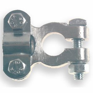

First up was the cutting off issue. Turns out the little black plastic box the wire went into was part of the factory alarm system, and the loose wire triggered the immobilizer. We had trouble replicating the problem, but eventually were pretty sure that forum lore was correct after checking the wiring diagram for the system. The solution was as simple as splicing two wires together. Thanks M52Josh!

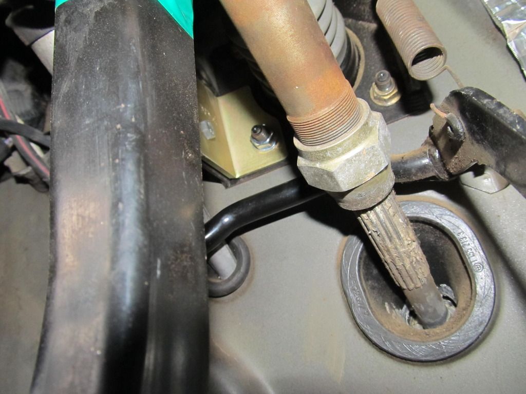

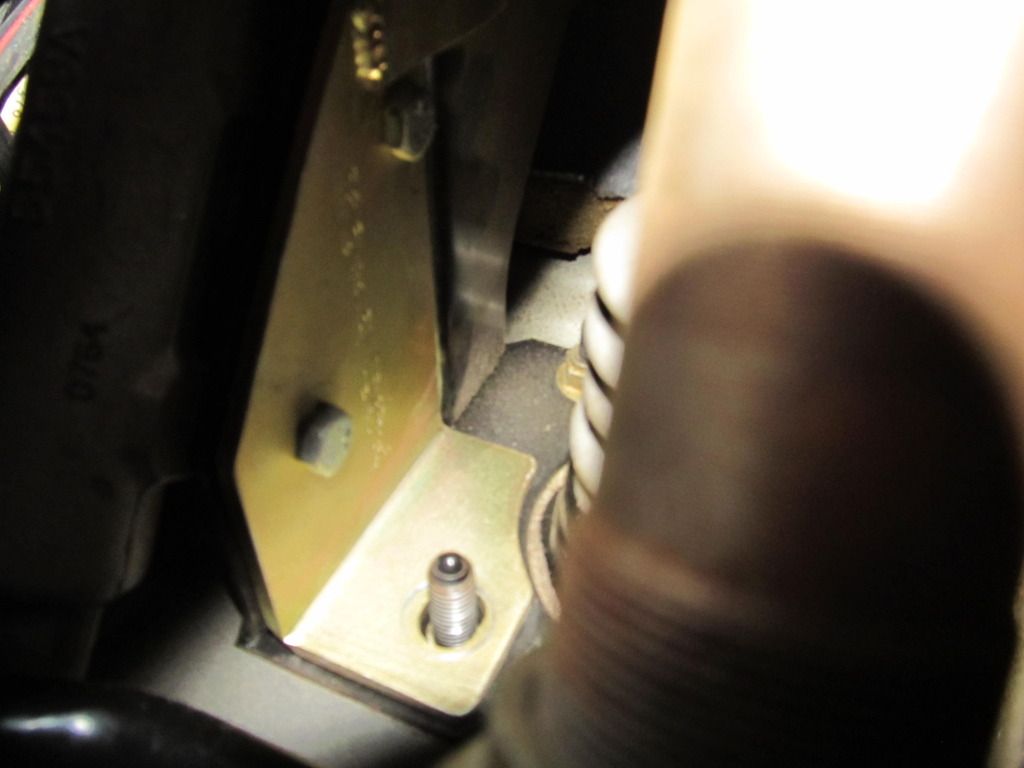

Next up were the taillights that (partially) lit up when you didn't want and didn't when you did. Turns out it was a combination of an out of adjustment plunger on the brake pedal that triggers the brake lights, switching bulbs side to side, and removing some dielectric grease. We "solved" the plunger issue by putting a small spacer on the brake pedal. Wow, we actually have working taillights!

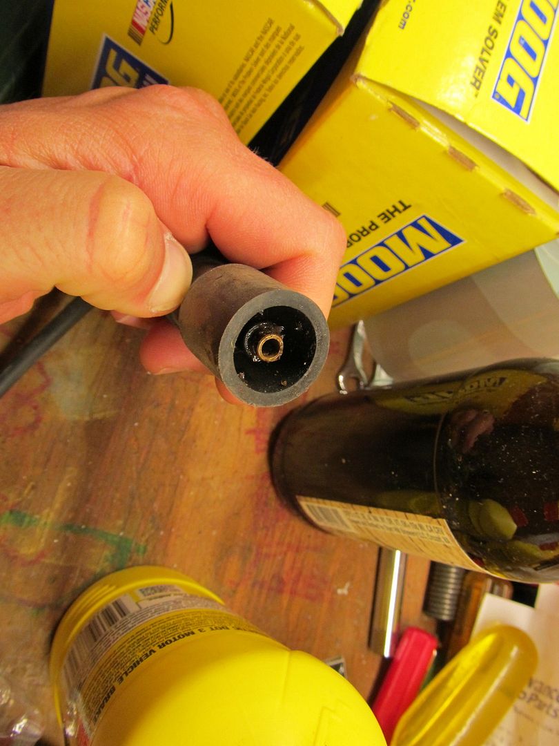

We turned on the car and it started right up, but we noticed it was running rough. Josh inspected some things and came across a spark plug wire that was not only filled with black sludge, but was missing the little spring that held it in place on the cap, so it never made proper connection. Thankfully, he had a spare set and would bring a replacement with him when we went up to the STPR rally.

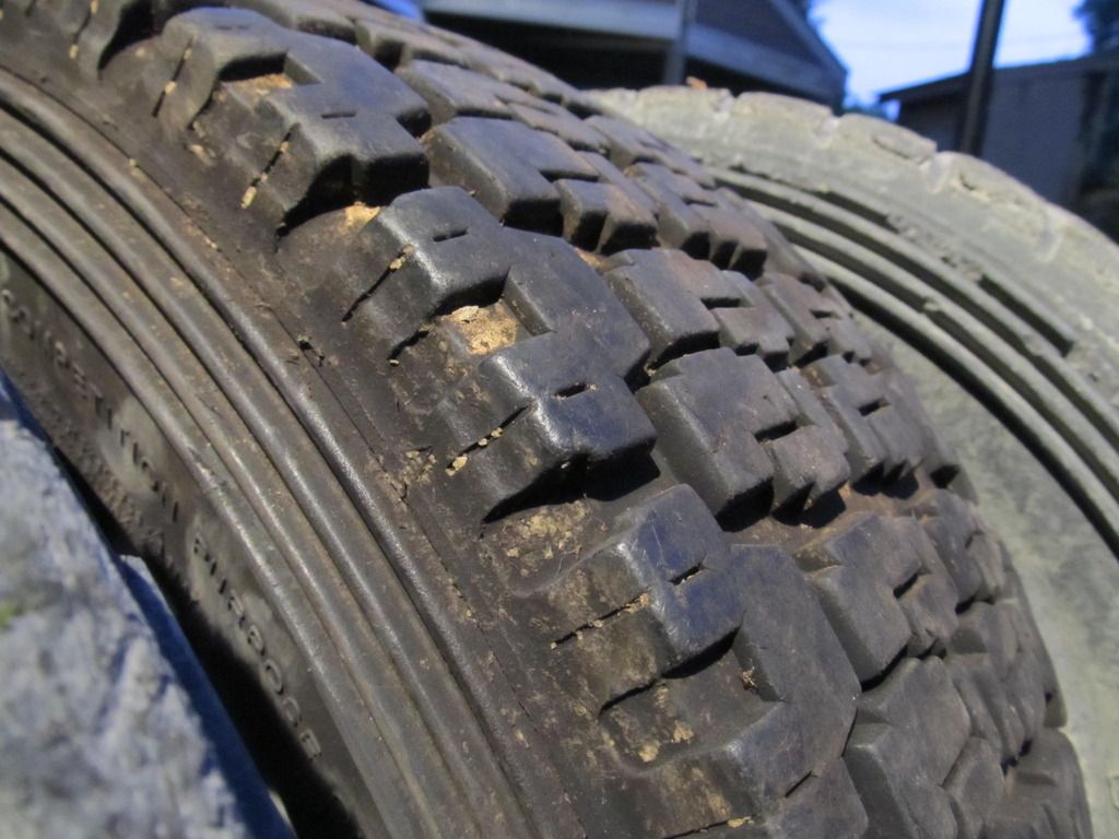

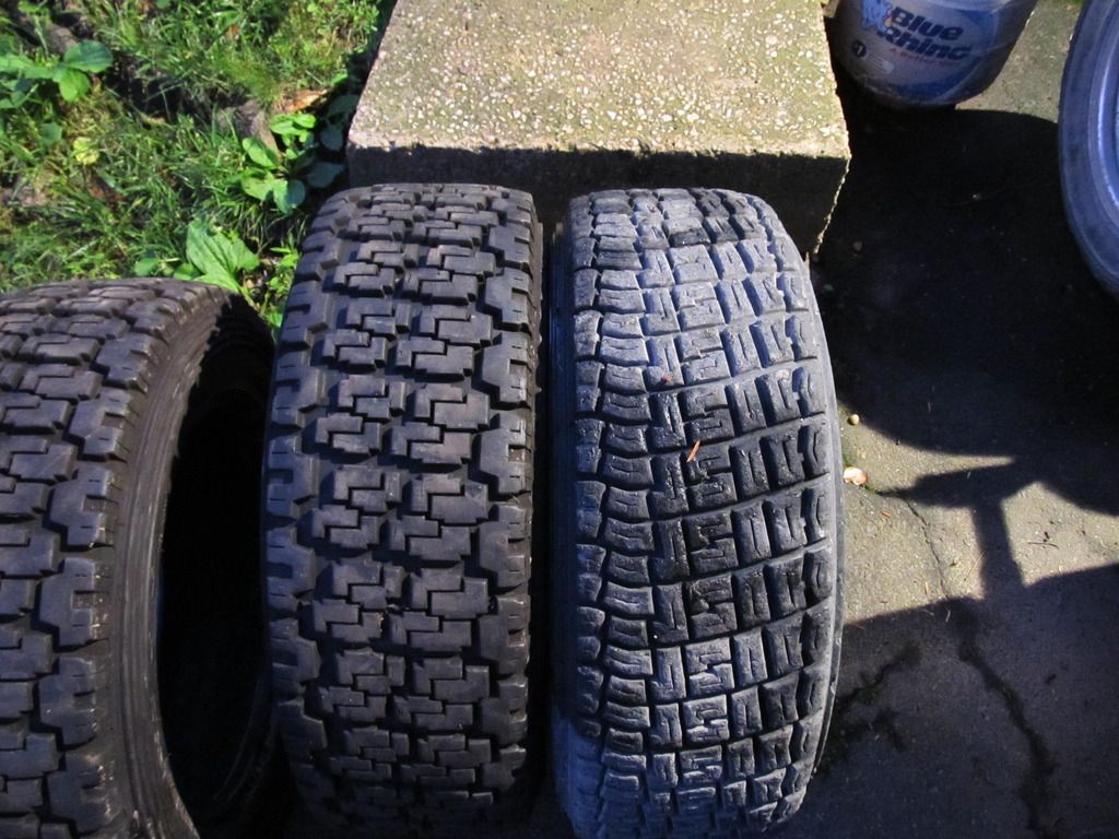

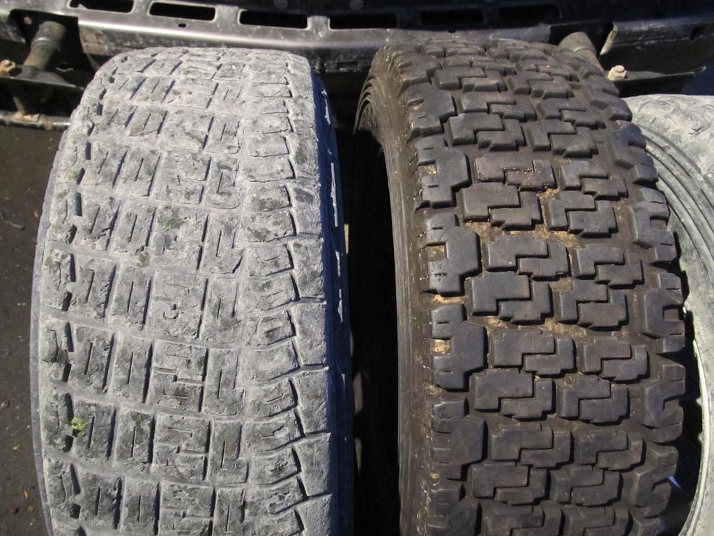

I also picked up the new tires from Chris' house, who was nice enough to bring them back to the DC area for me, as I can't fit 8 wheel/tires in the E28! I decided to just replace the rear two tires, since the fronts had quite a bit of life left. The new tires are Kumho R700s and have a hard compound. The tread blocks are very different than the old ones. I will be putting the old tires on the back of the car and putting the new ones on the front. Here are my current rear tires and the obviously new fronts:

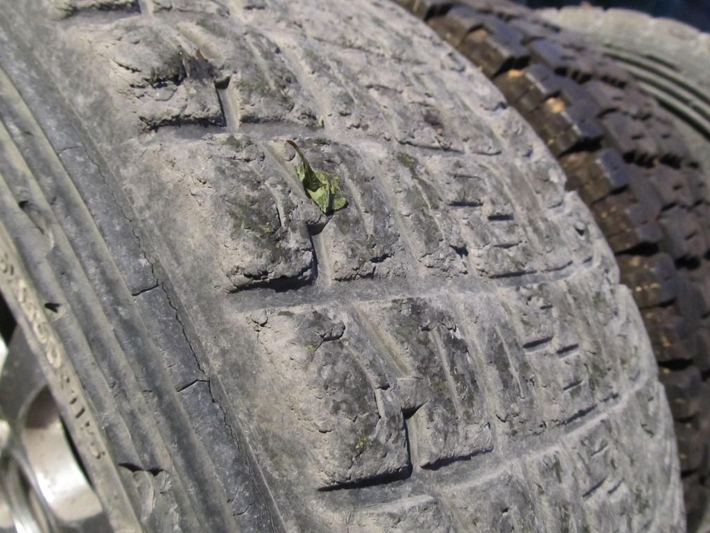

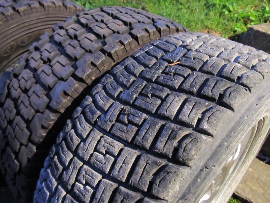

And here are my old rear tires compared with new:
