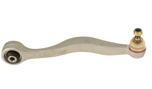

    Would you be interested in e28 front Control Arm bushings? PM me for details.
    For the lower or upper arm? I've already got some Moosehead Engineering UCABs waiting to be installed, but I would be interested in some spherical lower control arms, like those on the E31, just not in aluminum.
    Here are the Moosehead units:
    And E31 LCAs
    If you could come up with a press in solution to stock E28 arms, count me in!

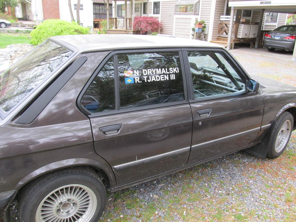

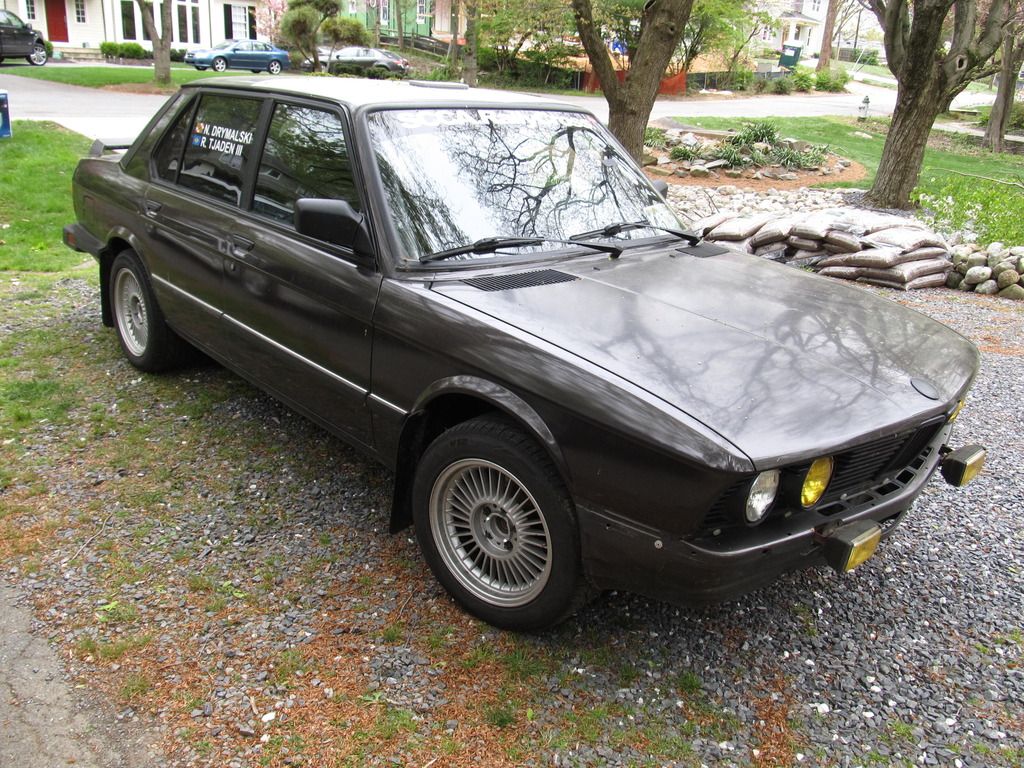

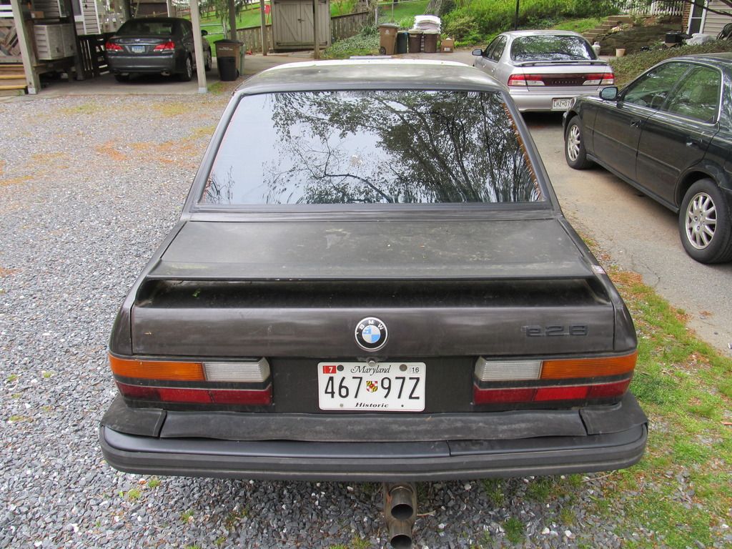

                      Last weekend Bobby finally came over and we did a couple small things that I've been meaning to do for quite some time. First up was replacing the throttle cable. Even with it fully tightened/adjusted, there was still a fair amount of slack in the cable, so I wanted something new. I figured it got stretched or something when the motor mounts failed a year ago. I picked up a new one for like $25 and got to work. Turns out it wasn't necessarily stretched, but rather a little oval metal piece was missing, and it was installed on the wrong bracket for the TB. We moved it to the upper mount location, and viola! A nice tight throttle cable.
                      We spent the rest of the day doing dumb stuff, like blacking out most of the chrome trim on the car and painting the rear bumper black. It looks good enough from 10', which is all I care about. In fact, I think it all looks fantastic now!
                      Ahh yes, that's the stuff.

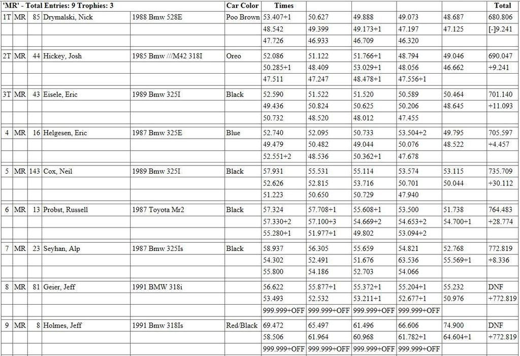

                              Rally-x Event #2 5/3/15
                              With all the recent work done to the car, I was eager to get it back to its natural habitat and see what it could do in the dirt. Thankfully, my impressions of the car from the last auto-x didn't lie; the car was excellent!
                              To recap, I "secured" the battery, added more power steering fluid, increased the stiffness of the FSB from medium to full stiff, cut a coil from the rear springs, and swapped in a rebuilt 3.73 LSD diff. Upon loading up the car, I noticed how the rear rally tires are almost bald, but I have some spares that are slightly less bald.
                              Either way, the car felt PERFECT straight out the gate. Everything is doing exactly what I want it to do, and it's just glorious. Sure, the car could use more power (what car couldn't?), but really, the car is just about perfect. I bet lowering the front an inch or so would make it even better, but I really had zero complaints about the car's behavior.
                              I started out the AM runs by hitting a cone, but by the third run I had pulled ahead of Josh and I stayed there the rest of the day. The course was pretty wide open with no super tight sections, which certainly is to my advantage. By the end of the AM session I had a 3 second lead and the fastest individual run by about 0.3 second in the MR run group. As the PM session wore on, I slowly put more time between Josh and myself. I hit one more cone, for a total of two, but Josh hit five for the day. Again, I put down the fastest clean time in the MR group in the PM session by about 0.3 second, and ended up about 9 seconds ahead of Josh. I even beat the stock AWD champ by about 4 seconds! Here's a shot of the results for my class:

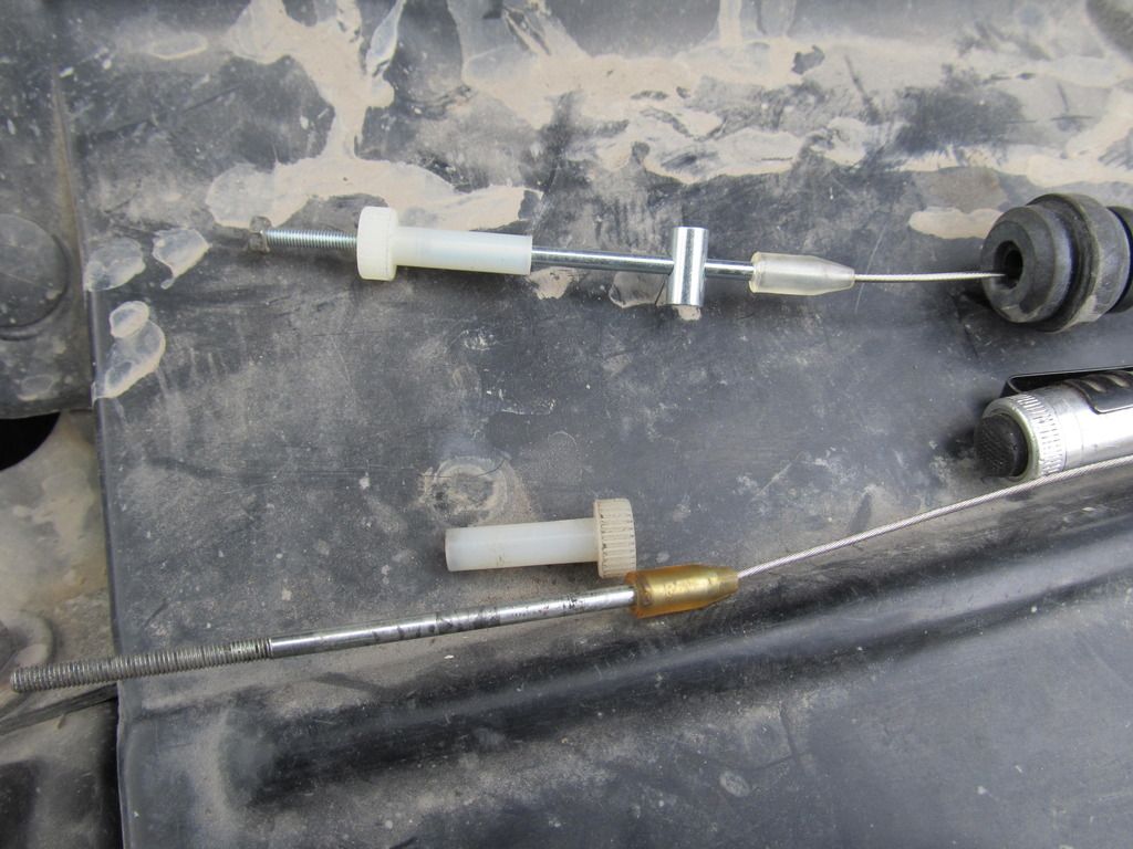

                                Unfortunately, when I went to start the car for the drive through, it wouldn't start! I naturally checked the battery connectors, as the battery had a tendency to move around quite a bit due to a lack of tie down in the battery box, and the terminals would pop off. It even happened on the drive to the event! Somehow the positive wire worked its way loose, and when I turned on the headlights as we were going up a super steep hill, the car bucked and tried to stall, so I turned them back off real quick and pulled into our normal rest stop location.
                                Back to the race. We checked a bunch of things but couldn't find the problem. After letting it sit for a while, it started up, hooray! But as I pulled up to the line, the car cut off. It restarted easily, but I knew something was wrong. On my second run, I got about 80% of the way through the course when the car died on course. Apparently it took me about 40 seconds to get moving again, by which point I had basically lost the race for the day, cause there ain't no coming back 40 seconds. Fuck. Thankfully Josh is a good sport and let me co-drive his car AGAIN! I hopped in his car having not driven it since he put on coilovers and disconnected the RSB, and immediately beat his fastest time by half a second, and ended up with the fastest clean time in the morning.
                                After much poking around in the area where the dash should be, Mike (2.5 RS, crazy FC RX7) found a wire that appeared to be the culprit. By jiggling the wire, he could make the car cut off. I proceeded to wrap the plastic box the wire went into with about half a roll of electrical tape to ensure the bog didn't jiggle around and the wire couldn't move out of place. Half way through the afternoon session I got it running and did the last few races in it. If I hadn't hit a cone on the first run I would have had the fastest time, but Josh's cleanest run was a tenth faster than mine. Josh of course won the event handily, some 34 seconds ahead of me, back in 5th place. That gives Josh two wins to my one. I had some work to do.....
