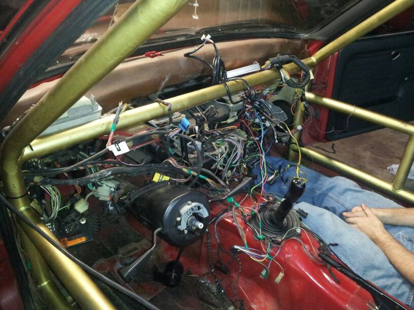

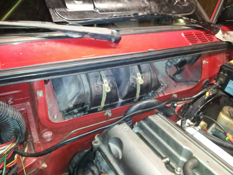

Lots of stuff going on. Pretty much decided to tear the car completely apart and rebuild the entire cars harness from engine, to chassis, to interior. Also rebuilding the subframe with Condor subframe bushings with risers, diff mount, and trailing arm bushings, ECS tuning SS brake lines, and Xcessive solid trans mount. Removed hvac, installing carpet, deck lid, shifter boot, panels, etc. New digital tach, new ebc, installing haltech IACV, new catch can setup with dual -10AN lines, coilpack relocation, coolant hose relocation, vacuum line relocation, fmic relocation, new vbands, fixing oil and coolant leaks, etc etc. Probably forgot a lot of stuff but that's the jist of it.
What a mess this is...
Soon it will all be pretty and organized.

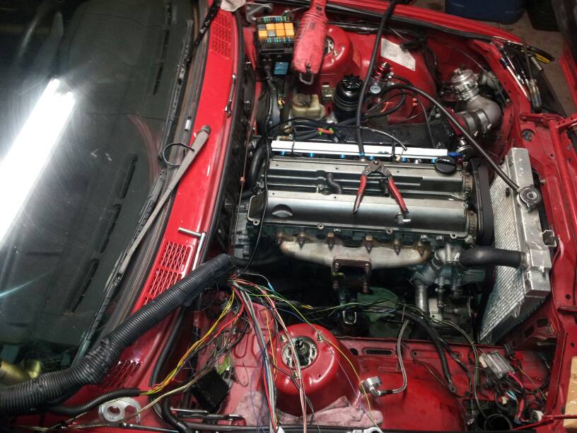

Originally posted by dmoney(AB) View PostWow
So much room without the twins!
