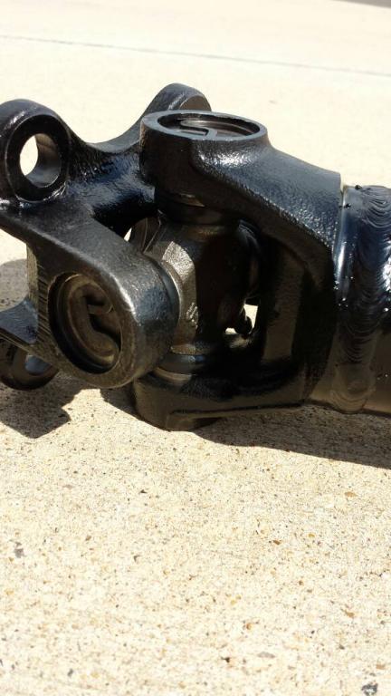

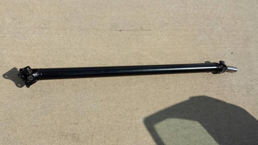

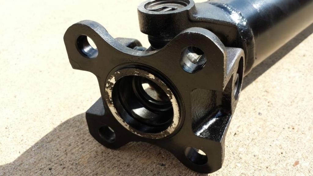

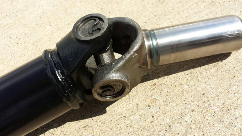

      Got a new 1 piece driveshaft made. 1310 ujoints, steel shaft, custom flange.

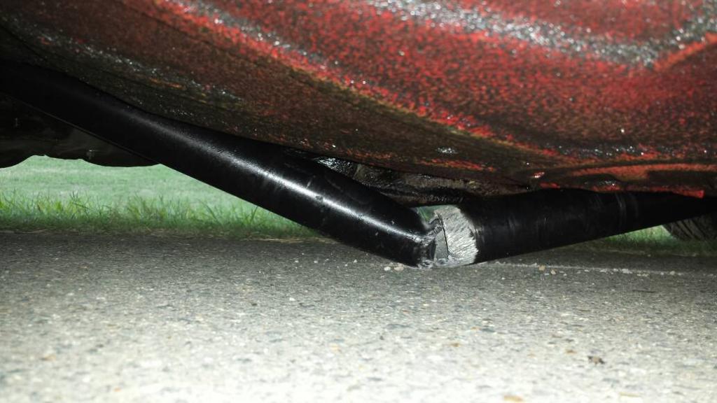

        I snapped it in 20 minutes while testing it...back to the drawing board...

            WTF? How did you manage that? What kind of steel did you use for the main shaft?

              That's a one piece. Its seamed 2.5" 0.083 steel. Upgrading to a seamless 3" 0.083.

                  3" is what my driveshaft shop used for mine... granted though, you've got at least 200whp on me. Regardless, the guys at the shop said that the tubing they used is good for about 1k wheel but the u-joints were only good for 6-700 or so.
