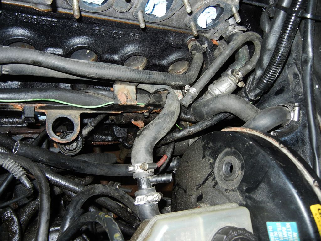

          I know it's been a while since I've posted any updates, that's because there hasn't been many...
          I was able to squeeze a hose behind the booster, it involved cutting the hard line from the heatercore back a bit. There's not much for the hose clamp to squeeze on, but it hasn't been leaking so it should be good...

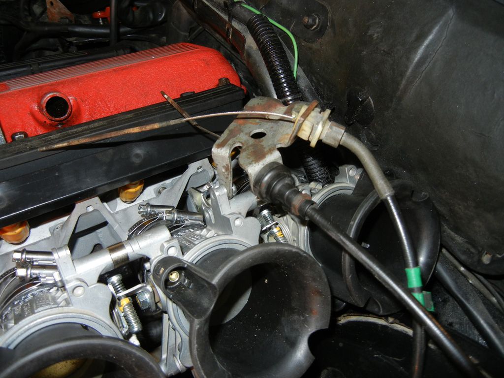

          I also figured out that the throttle cables will roughly reach where the bracket for the throttle body cable screws on, so I'll be able to modify that bracket to hold onto the throttle and cruise cables....
          I'm still in the process of designing the mechanism I'm going to use to join the cables.
