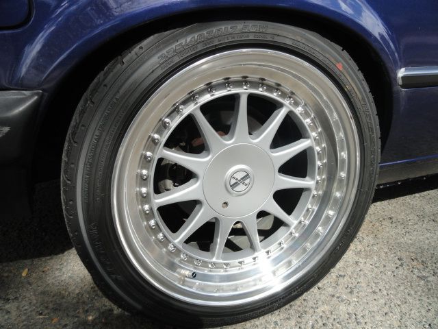

    #241
    [QUOTE=411;4021310][I]...
    ...............interesting.....yours in the pic have OZ markings under the cap?......whats the offset?
    Yes to OZ - et 24

      funny how the valves are mounted in the wheels

        Hi Jack. Can you post some pics of your 16" wheels? The ones that Barron posted on the first pic are the same as my Hartge 16" wheels. They have 2 step on the lips. In my opinion the centers were designed as 15" centers. With a 15" center deign oz can make a 1 step 15' lip or 2 step 16''.
        Hell Nico.
        Do you have pic of it? I see that you posted one in the rare parts section.

            In Japan I think they do not allow 3pc wheels. That is why the lip and barrel are welded together. For the valve stem not sure why they do that.

              ..... 15" has 149mm centercap..........3pc has 157mm....but yes they look the same........and you can put 15" lips and barrels on the on the model I posted, just like on a bbs 30 holer', however the inner diameter of OZ lips [although the holes line up] are slightly different

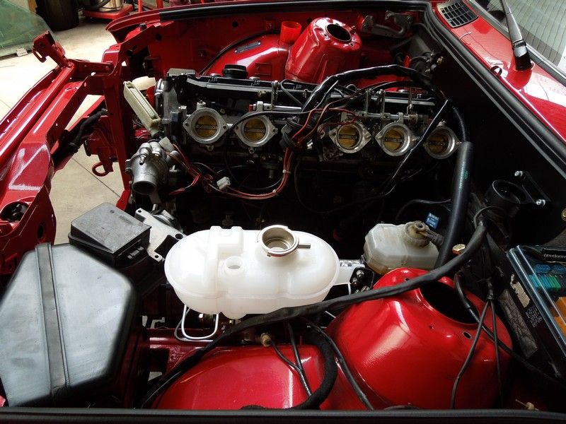

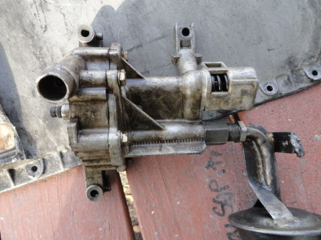

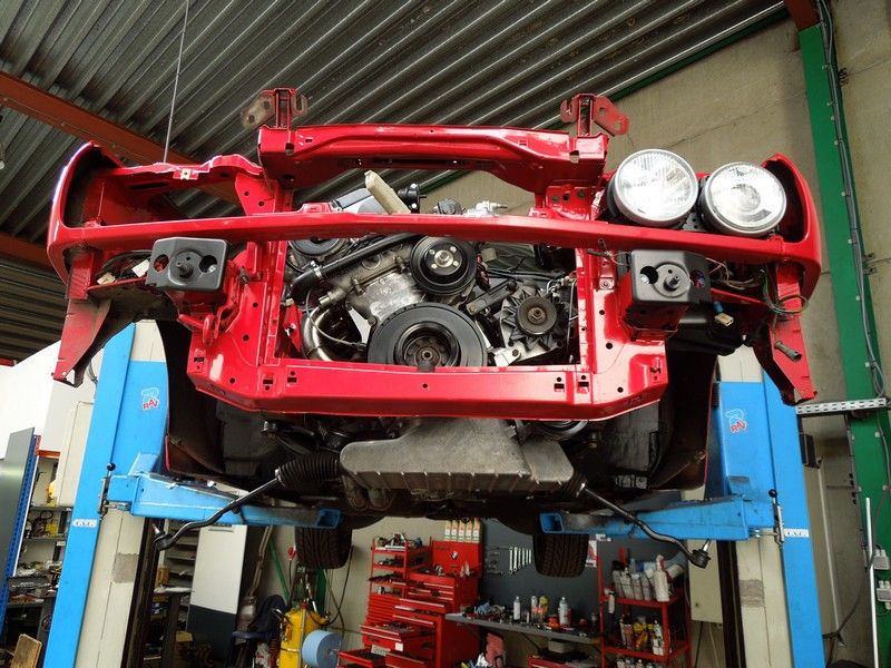

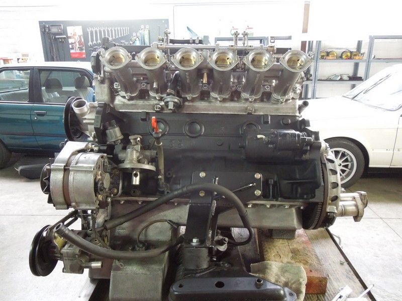

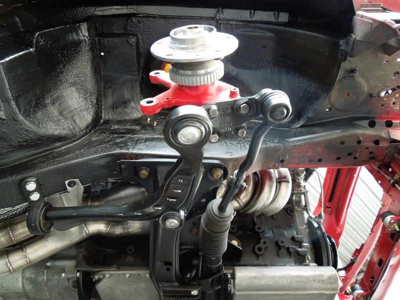

                    Here are some up dates on parts I been collecting for years.
                    On ebay in Germany there was a Hartge H35-24 or H35 9 quart oil pan. It sold for over 3,110.00 euros = over $4,219.00. I did bid on it and contact the owner to buy it now. He responded just bid. 24 hour to end on ebay he canceled the ebay auction. I emailed him amd responded sold. Somebody paid a lot of money for it. I think A Hartge H35-24 s38 owner bought it. It is very important for a s38 Hartge car because the oil pan allows the engine to sit further back than position 3, the Hartge pan allow the s38 engine to sit further down (almost 2") than e32 or e34 m30 oil pan. It can hold 9 quarts oil. For better cooling. Hartge modified oil pump. The price for it in the day was around $1,000. Hartge never spaced the sub frame from the body.
                    Here is a link in the rare section for better pic.
                    I have a H35-24 oil pan that is broken. I found a guy that he bring it back to its glory days.
                    E32 oil pan and e12 oil pan.
                    DSC03484 by m3raul, on Flickr
                    E12 oil pan
                    DSC03483 by m3raul, on Flickr
                    E32 and Hartge H35-24 oil pan
                    DSC03471 by m3raul, on Flickr
                    Hartge oil pan
                    DSC03470 by m3raul, on Flickr
                    DSC03473 by m3raul, on Flickr
                    DSC03494 by m3raul, on Flickr
                    DSC03495 by m3raul, on Flickr
                    DSC03475 by m3raul, on Flickr

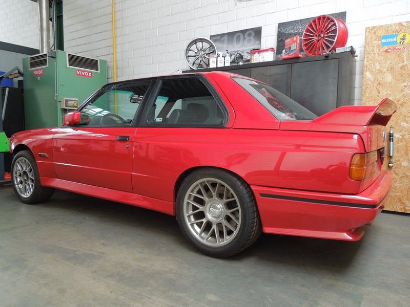

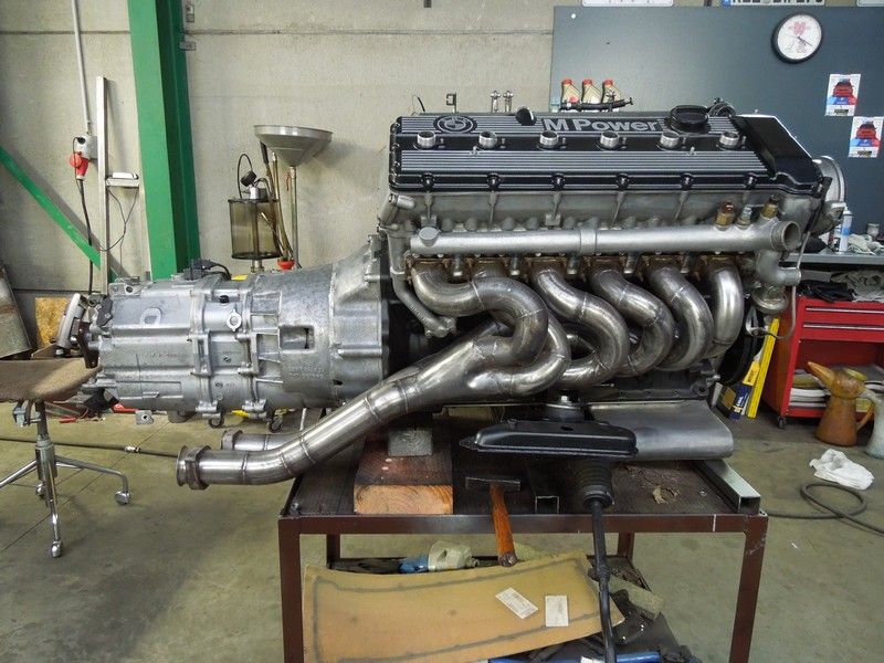

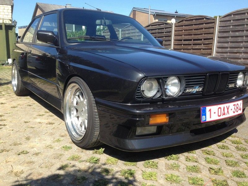

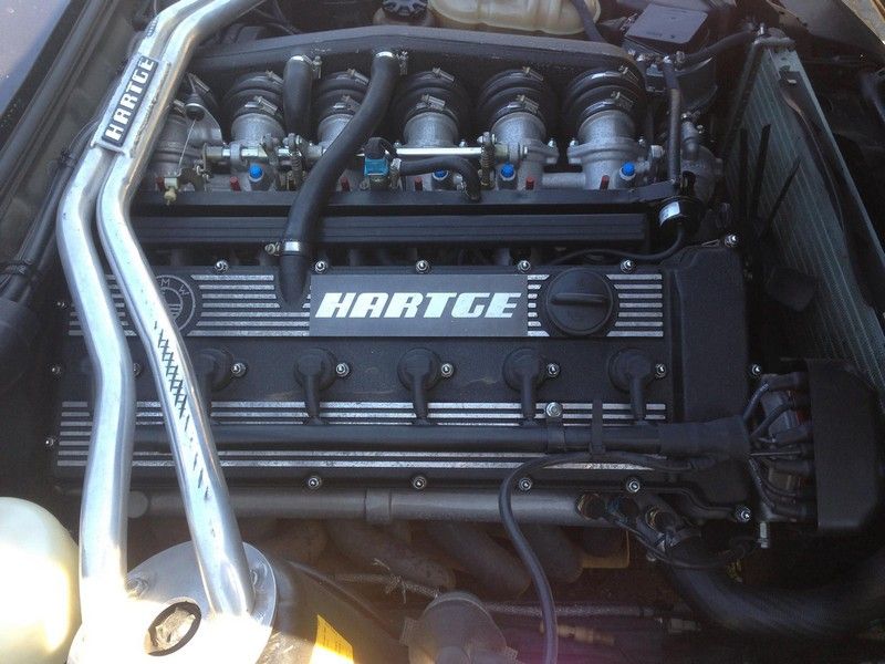

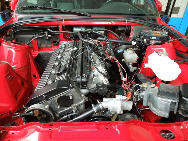

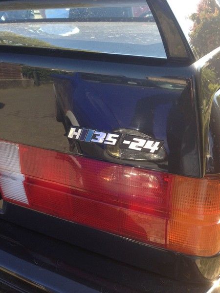

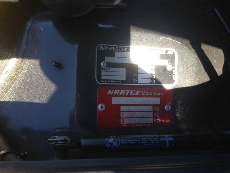

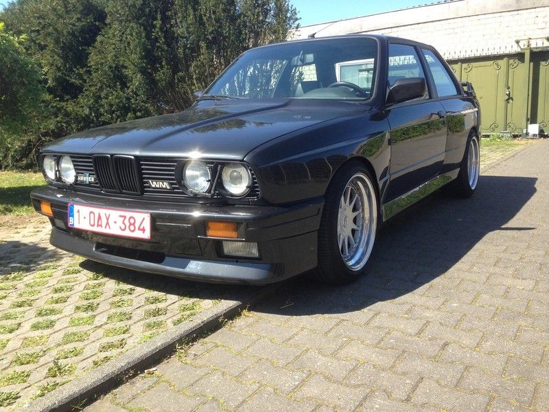

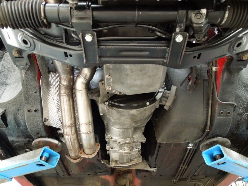

                    Here some pics of real Hartge H35-24 m3 and Hartge oil pan.
                    Here is a link to the H bomb!!!!!

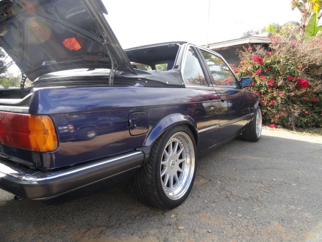

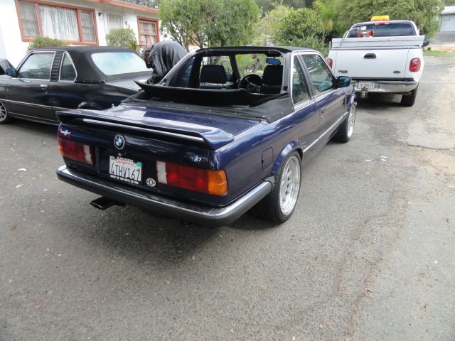

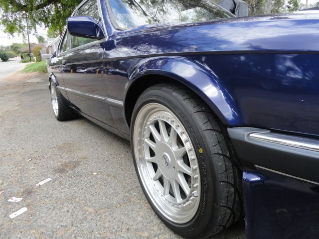

                      Here some pics my buddy Frank found in my 1985 Hartge catalog. Hartge H35 kit with Hartge oil pan. Here are some pic of Hartge H27 clone and my old Hartge 17x7.5 17x8.5 3pc 4x100 wheels. I sold Hartge wheels to him 17 years ago. I regret it.
                      DSC03506 by m3raul, on Flickr
                      DSC03508 by m3raul, on Flickr
                      DSC03511 by m3raul, on Flickr

                                Yes 6 were made by Hartge factory. Birds Hartge and Hartge Japan built Hartge cars. not sure if they built a e30 m3 H35-24.
                                Here where they are located.
                                1) silver e30 m3 H35-24 in Germany.
                                2) red e30 m3 H35-24 in Belgium.
                                3) diamond blk e30 m3 H35-24 in Belgium.
                                4) red e30 m3 H35-24 in Switzerland.
                                5) white e30 m3 H35-24 in United Kingdom.
                                6) red e30 m3 H35_24 in United Kingdom.

                                The Hartge H35 oil pan allow the s38 b35 motor sit closer to the sub frame with out using 20mm spacer between the body and sub frame. Hartge oil pan allow the motor sit a full 1" back more than a e34 or e32 oil pan.
