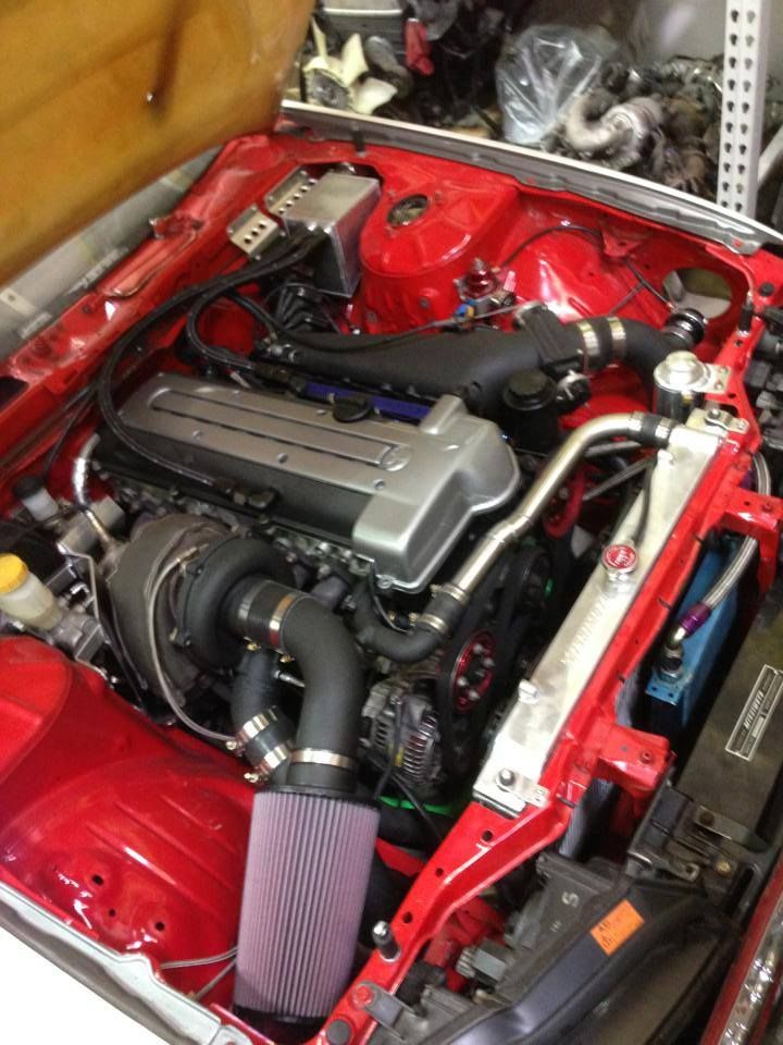

UPDATE! (10/15/2013)
So the engine is in, heheheh. Just makes me want to cry. Looking good too if I must say myself, but it looks like I might have to move the brake booster, feel like it will get in the way.
UPDATE! (10/16/2013)
A lot of updates these past few days! The firewall had to be stripped and pushed in a bit to make room for the rest of the engine and heater hoses.
And had to cut out the shifter hole to fit the r154 shifter.
