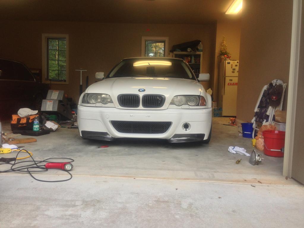

          Off topic but here is a few pictures of my 330 I just got back from the shop. Got a CSL front installed, looks a whole lot better than the original.

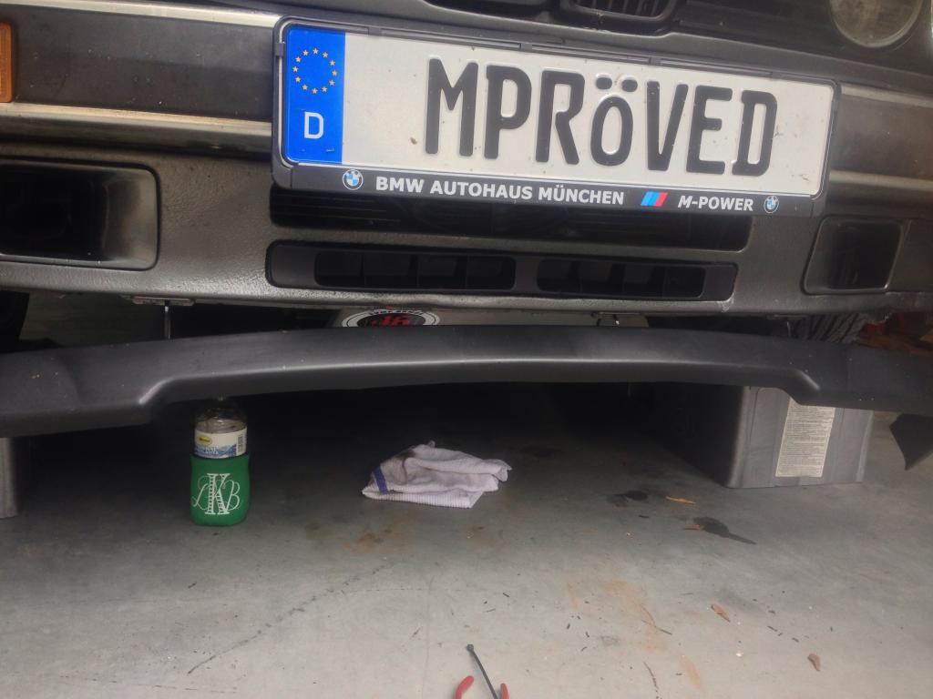

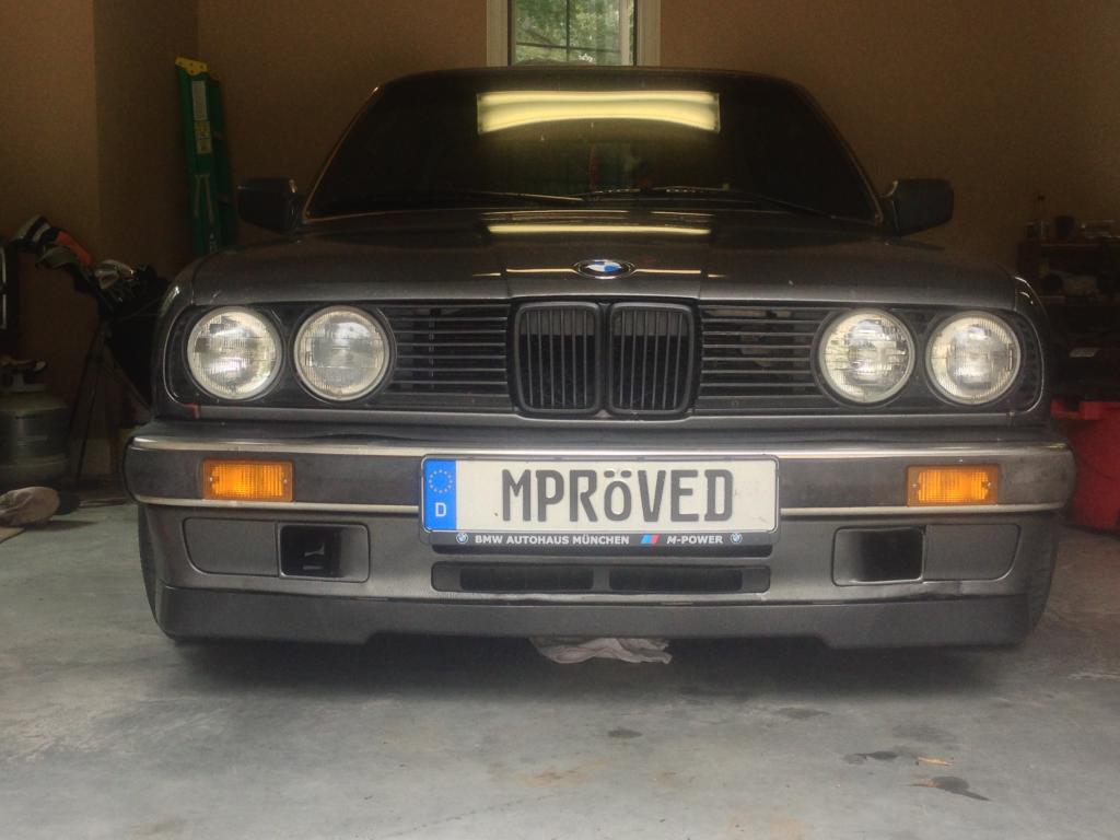

                    Painted my fog light covers and resprayed the air ducts, also got the lip installed and the black kidney grills. (Thinking of color matching the lip.. What do you guys think?)

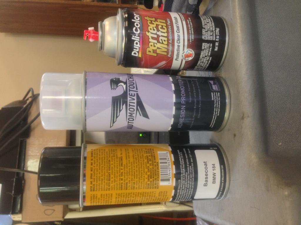

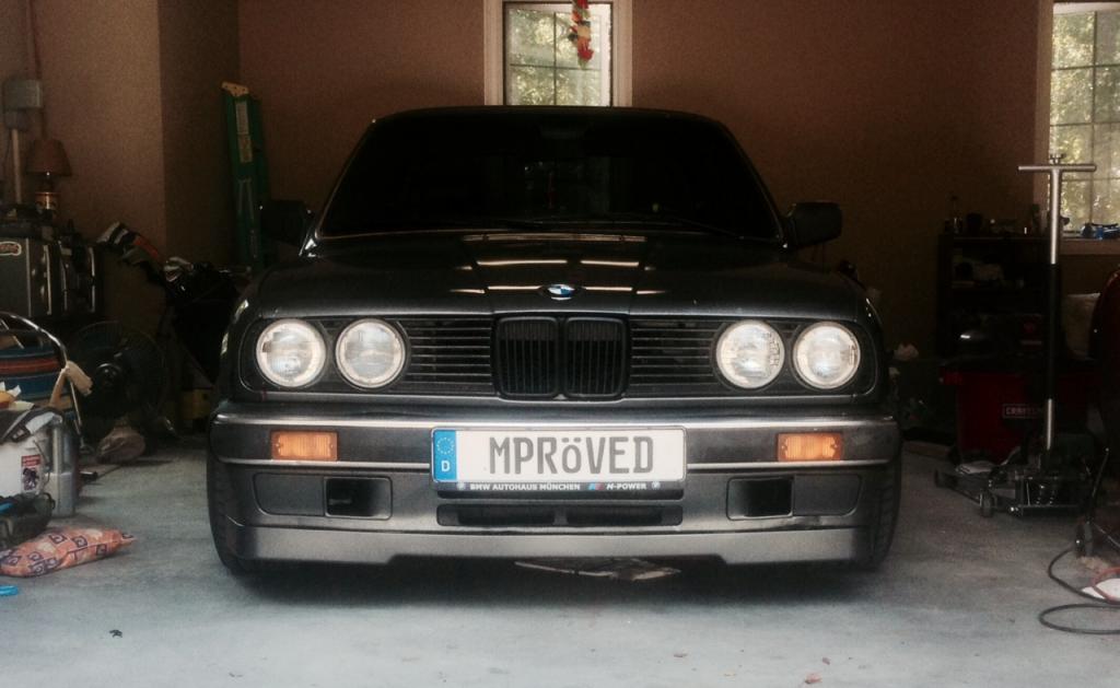

                          Alright so I painted the Lip to match everything else. It does look better, thanks for the persuasion lol

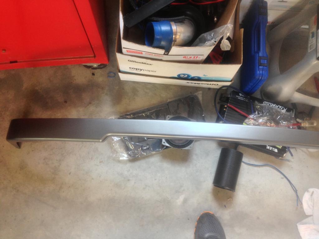

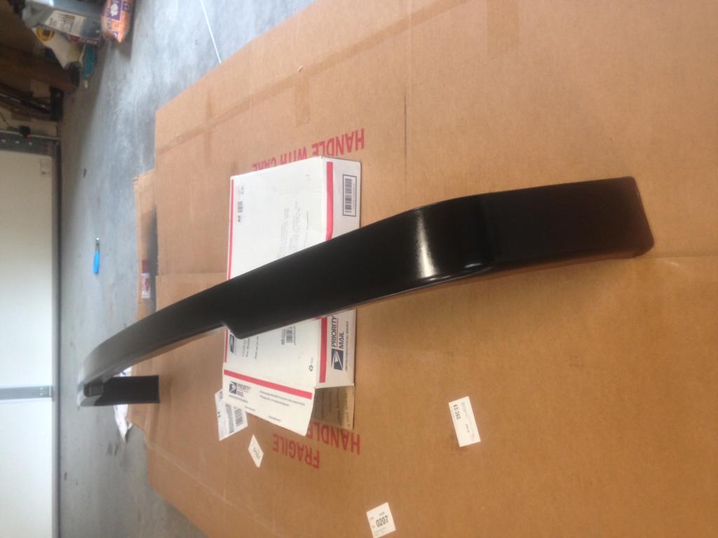

                            If you don't mind me asking. How does the lip attach? Because I bought a series one with a missing lip and found one, now I just need to know how to attach it. In the stock lip there are 5 screws but the side has something weird and I can't find clips or anything.
                            • Bimmian89
                              • May 2012
                              • 170
                              #89

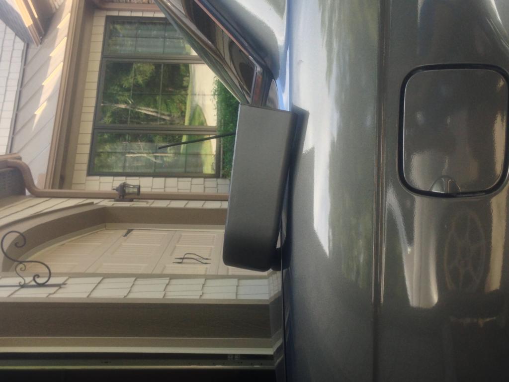

                              It has like two prongs that stick out on each "clip" it just slides between those prongs and the upper lip of the valence itself. Mine only had the ones on the side so I drilled a hole in each one without the prongs and ran a zip tie through it and the lip ( lip has a slit where it slides on the prongs) on the backside so you can't see it. PM me if you need more details.

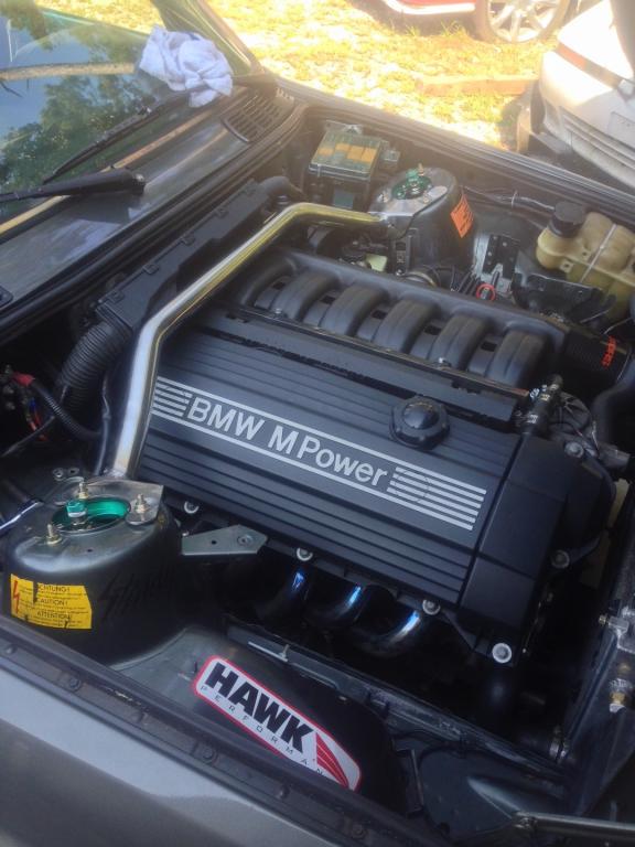

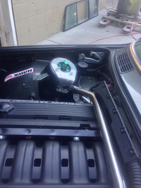

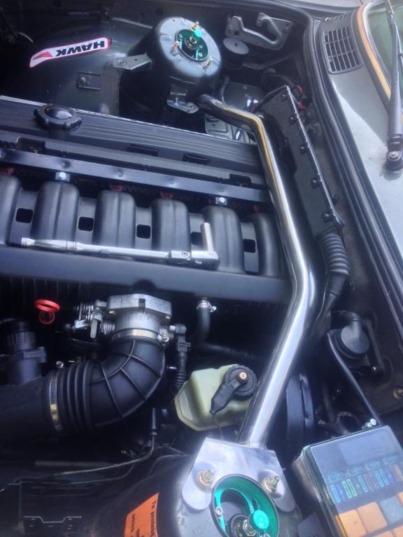

                                Alright so I got a Ireland engineering strut brace from a member here and it was too long for his car, so I tryed my luck since our measurments matched up and still ended up being ~ 1/8" to long. So I had a friend of mine that owns a fabrication shop work his magic on it. It feels so much better with the brace all the bumps in the road just feel so much smoother now, and handling is a lot tighter. Very happy with it.
