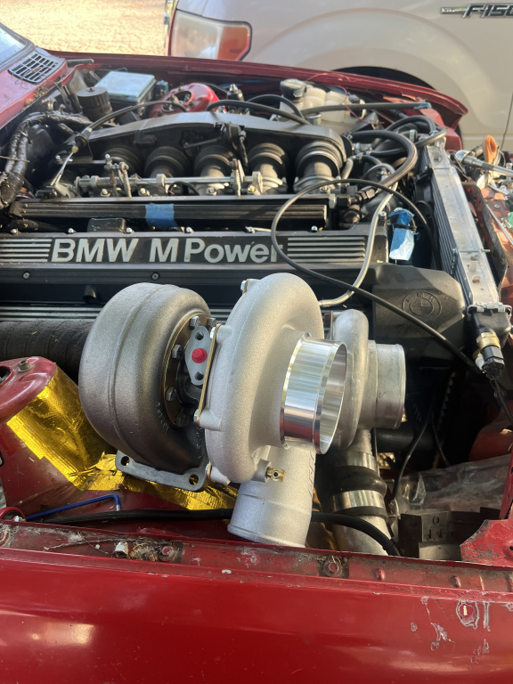

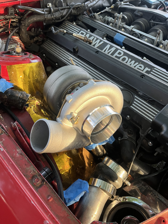

Originally posted by kronus View Postare you sure it's big enough? :)
this thing is going to do wheelies!
It might do some wheelies.

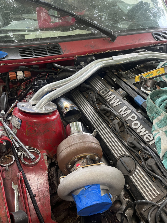

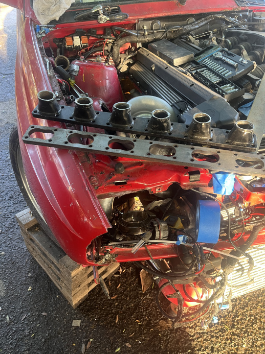

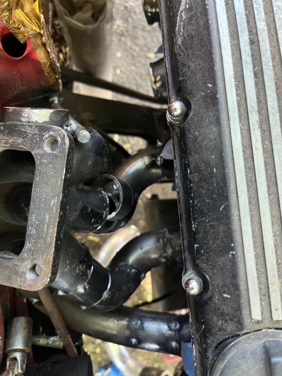

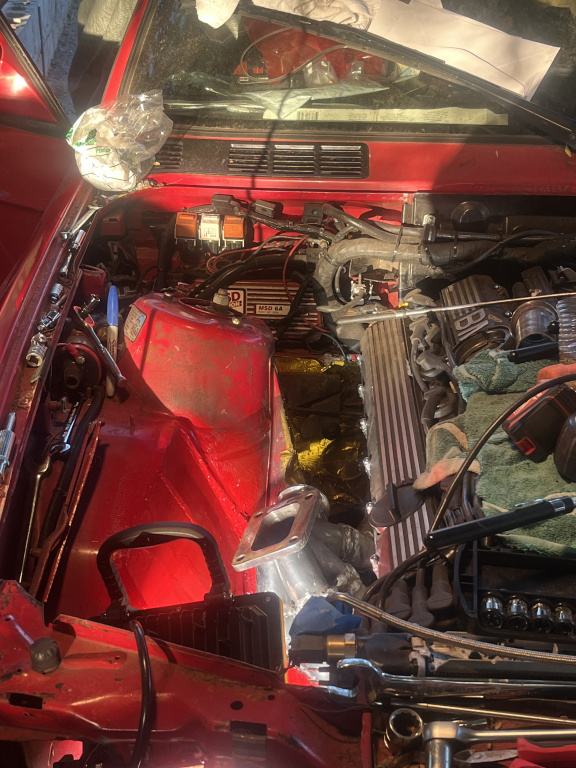

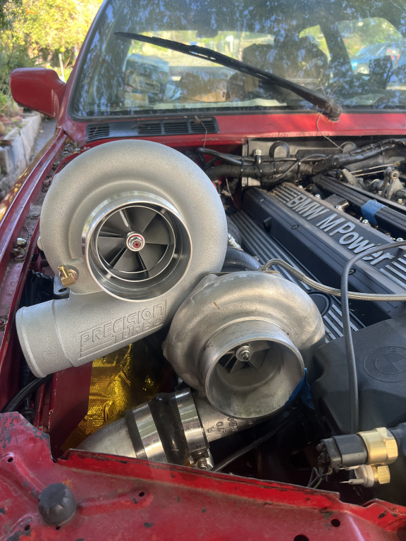

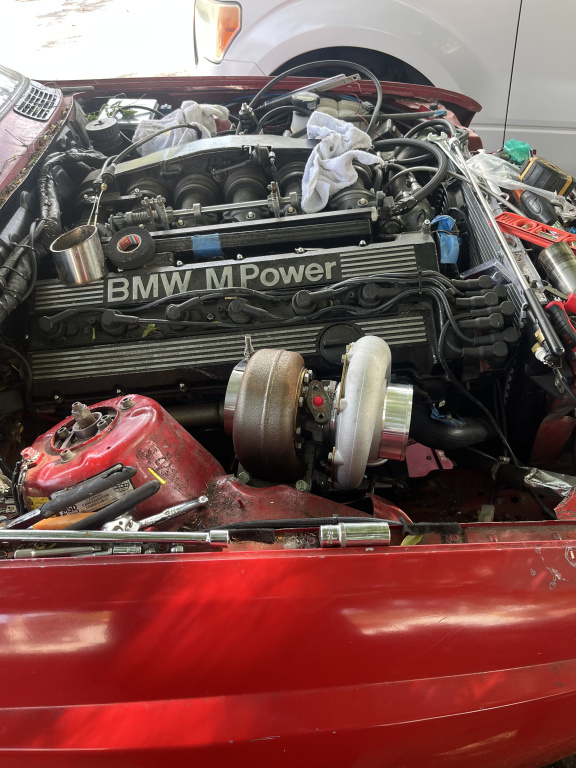

I started the tear down on the old customized turbo manifold today. I’m still on t4 flange. That’s why the turbo is not set up correctly. I will need to go back 4” back towards fire wall. I will need to cut up inner fender.

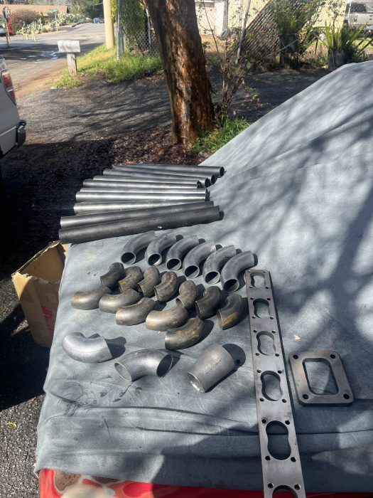

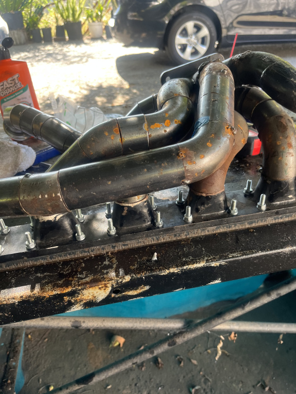

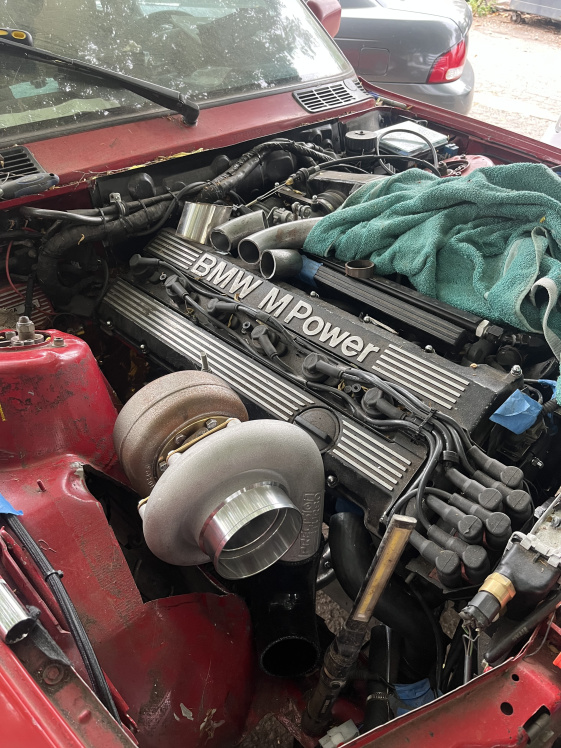

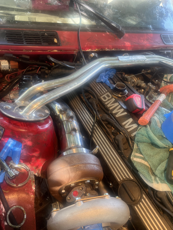

It took a little longer than I thought make my custom turbo manifold. It was great experience to do it. I thinking of making one out of stainless in the near future with V band Precision ball bearing 7675. I bolted it down to steal table plus a one inch thickness of flare steal to make sure my my flange does not warp when I’m welding.Projects Hartge,Alpina & AC Schnitzer Builds.http://www.r3vlimited.com/board/showthread.php?t=280601
