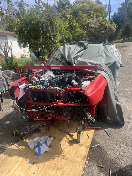

This weekend I replaced the steering tie rods and got the motor to run steady. I have a small oil leak on pan. It is where it meets the block and timing cover. I will pull the Hartge H35-24 oil pan down to add rtv on top of gasket where timing cover. I hope it works. That was advised by my friend Brandon that works for BMW dealer.

I pulled the timing cover off because one the bolts punched a small hole in it. I had my friend repair it. It looked ugly. I ordered a new one. The leak was above the turbo return line to pan. It was leaking between gaskets and Hartge wind tray.2 PhotosProjects Hartge,Alpina & AC Schnitzer Builds.http://www.r3vlimited.com/board/showthread.php?t=280601

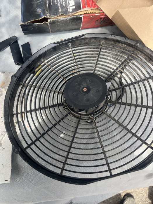

I put the Hartge pan back on. Ran it for a while to check for any leaks. I was lucky with no leaks. My 16” spal grenaded on after ten minutes of running. I had to small bolt holding the fan in place. I thought there was enough room for blades not to interfere with blades. The plastic moves more under temperature of radiator and engine running. This time I used out side tabs secure it.

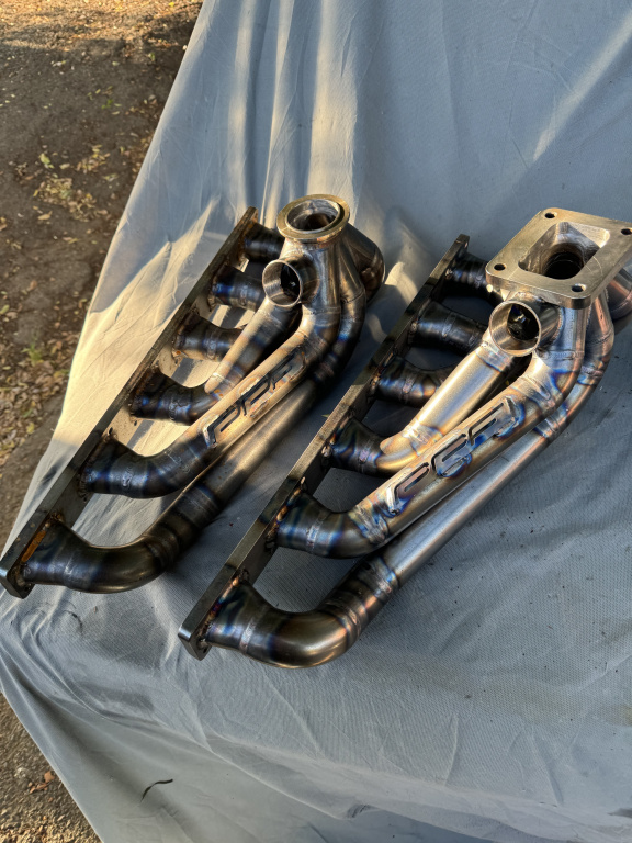

Up date.
My turbo manifold I modified has a warp on front of flange. It was leaking between s38 stainless gasket. In the past I had it on table belt sander. It is to thin. I had good experience building a turbo manifold.
I ordered new PPF’s turbo manifolds for t4 and V band. I ordered V band for later v band turbo up grade.
