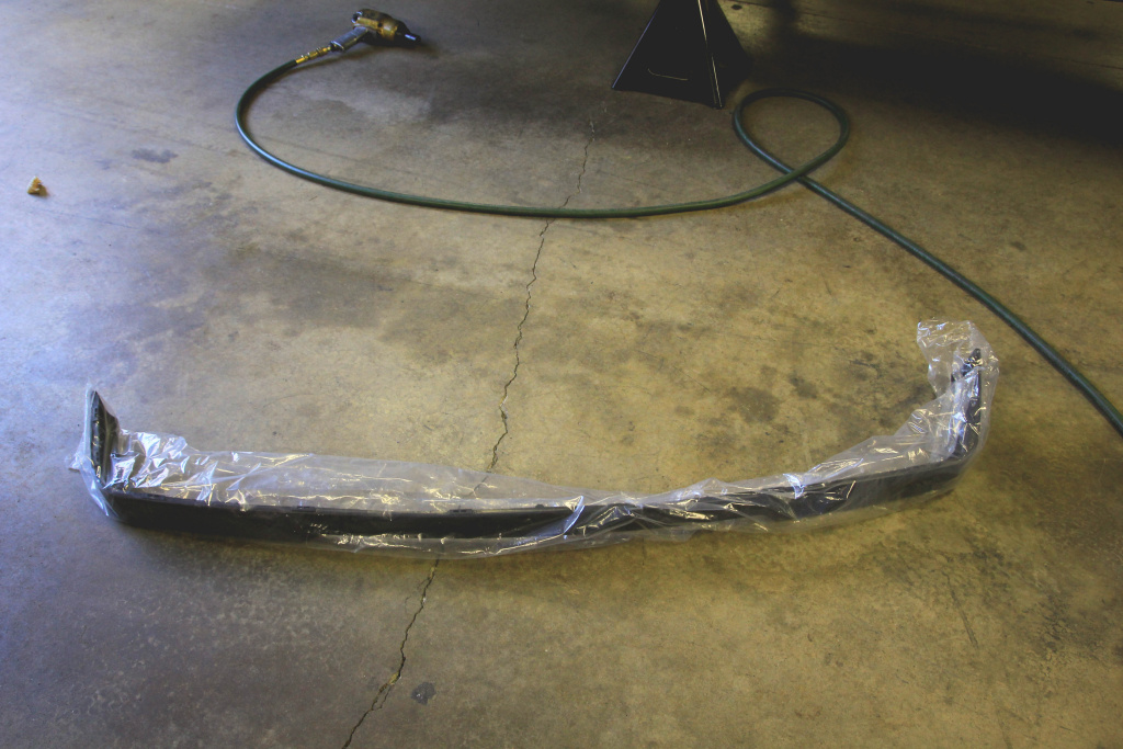

                          325is front lip
                          Click image for larger version  Name:	front lip (1 of 1).jpg Views:	0 Size:	287.4 KB ID:	10088435
                          Pretty stoked about all the parts. I'll be installing everything over the next couple days so I'll have plenty of updates. Hopefully everything goes along smoothly and I should learn a lot along the way.
