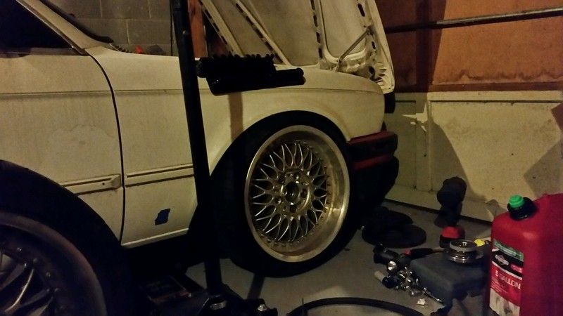

    IMG_20151012_185558 by Rdreas, on Flickr
    18x9.5 squared setup et 29. 2 have bent lips which is why they were so cheap.I wanted to see what they looked like on the e30 but would need some big fat adapters to get any sort of idea, but I do have some smaller lips for the front to make them 8.5" and bigger if I wanted to go to a 10.5" rear.
