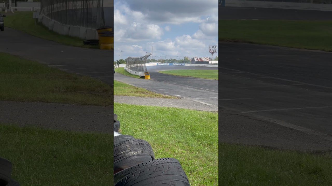

    Well the last track day didn't go as planned I broke more stuff and my last lap ended with the engine rod knocking.... :(
    I do have some pictures and videos to add. The car was ripping.
    So I ended up changing the cams a little bit by advancing the exhaust cam and retarding the intake the max amount the cam gears would let me. The Cylinder pressures and VE definitely increased in the low-mid range from this since the AF went to like 18:1 so I did some light street tuning and got it all back to where it was happy. Up top it was still a little rich but I was fine with like 10.5:1 AFR considering it gets such a beating at the higher rpms.
    I broke and axle the first session, then bent a tie rod the next session. Had my hood fly up on me before going on track luckily it went right over the whole car and didn't destroy my windshield. I was still battling the catch can filling up issue and trying to empty every session then check the oil in the car but the second session it overflowed again got all over the engine bay and just was not a fun a time. I ended up cleaning it all up and emptying it but never checked the oil level in the car afterwards like a big idiot. It was probably 1.5-2 quarts shy which might explain why my engine got rod knock I could've very well starved the sump from oil with the high G-forces of drifting and low oil level on top of all the oil pooling in the head and shooting out the catch can. OR I stretched a rod bolt which is also possible since they are just factory bolts and I probably should've upgraded to ARP ones when I built this engine.... Regardless decided to call it the end of the this season of driving and figure out what I want to do about an engine setup after having nothing but problems this year.
