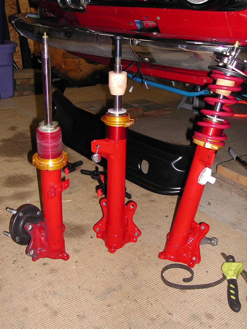

              Originally posted by oliver.r
              be careful with that style. notice how there is no gauge in the right side hole in all the pics? because the hole is too close to the side panel, preventing putting any gauge in it that is more than about a half inch deep....bad design. the right side panel should be angled differently.
              i have one. trying to figure out what to do with it.
              • mlytle
                • Jan 2010
                • 50
                #532
                Originally posted by RCM3
                Nice choice with the suspension upgrade. So are those your GC housings^^ yours or just pics of what the final product will look like? Wondering since you mentioned a couple days back youre preparing housing for the coil overs. What I am getting at is that I'm curious about your choice on the front sway bar mount location and if you gave any thought about the length of the threaded piece that the adjustable collar moves up and down on.
                yes...for 2002's this design should be changed. move sway bar mount up onto the tube like more modern M cars, and reduce the amount of threaded collar to 2inches. this gives more tire to tube clearance and the lower 2inches of threaded area can't be used anyway. i had mine custom made by GC this way.
                here is comparison of the two designs. left strut is the "stock" GC design i originally bought. right two are the ones they made to my specs after i realized the limits of the "stock" style
                  Wow, these are great photos showing the differences. I didn't delve too deeply in coilover design this time around. Mainly because I am a noob. But I will take this into consideration with the next run. Scout's honor.
                  These strut housings will get the Marshall/GC treatment special, swaybar tabs and all.
