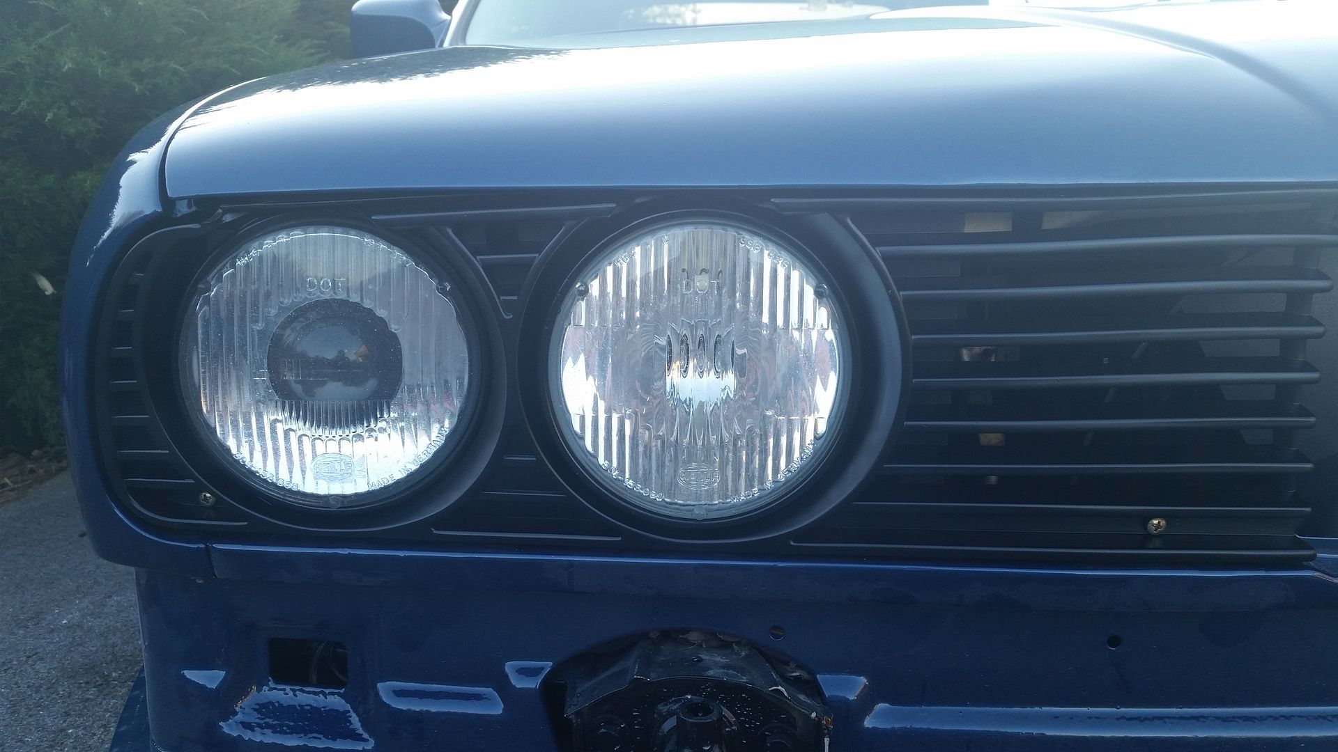

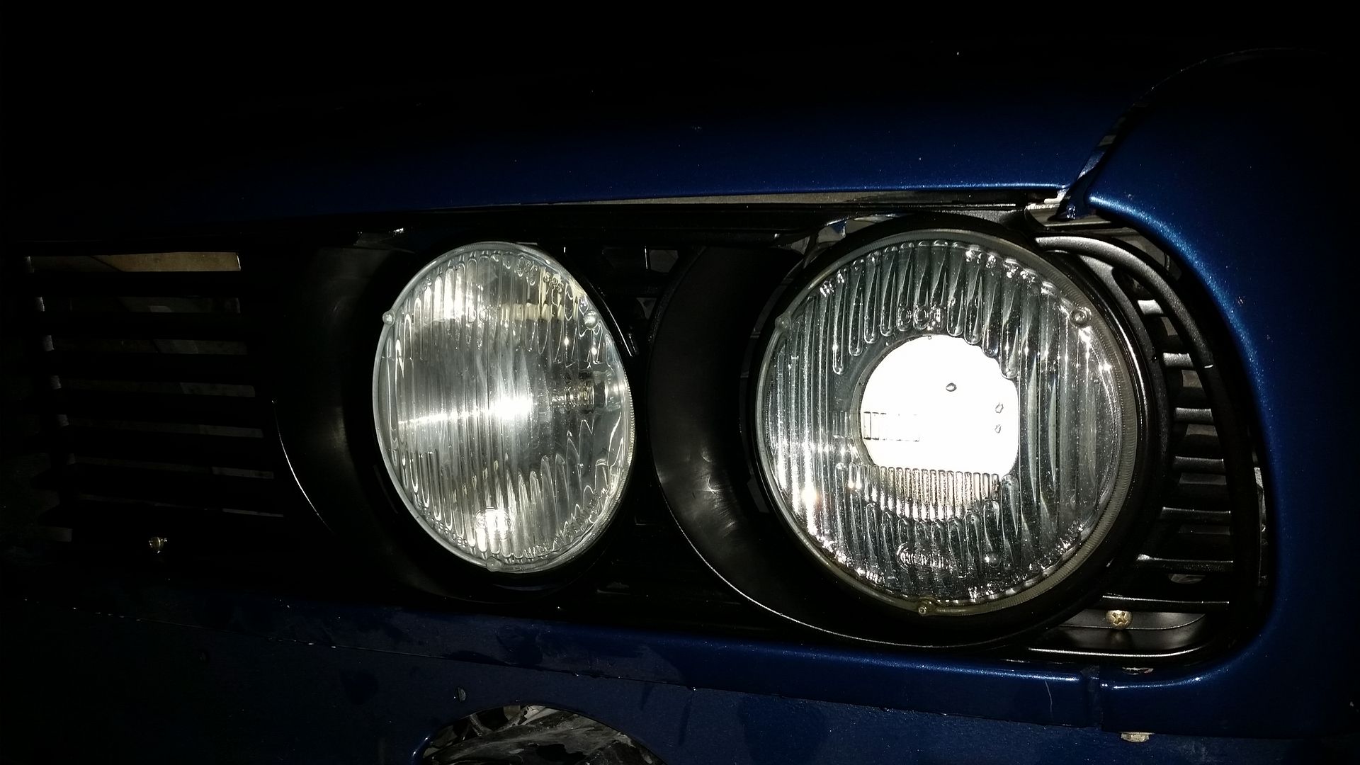

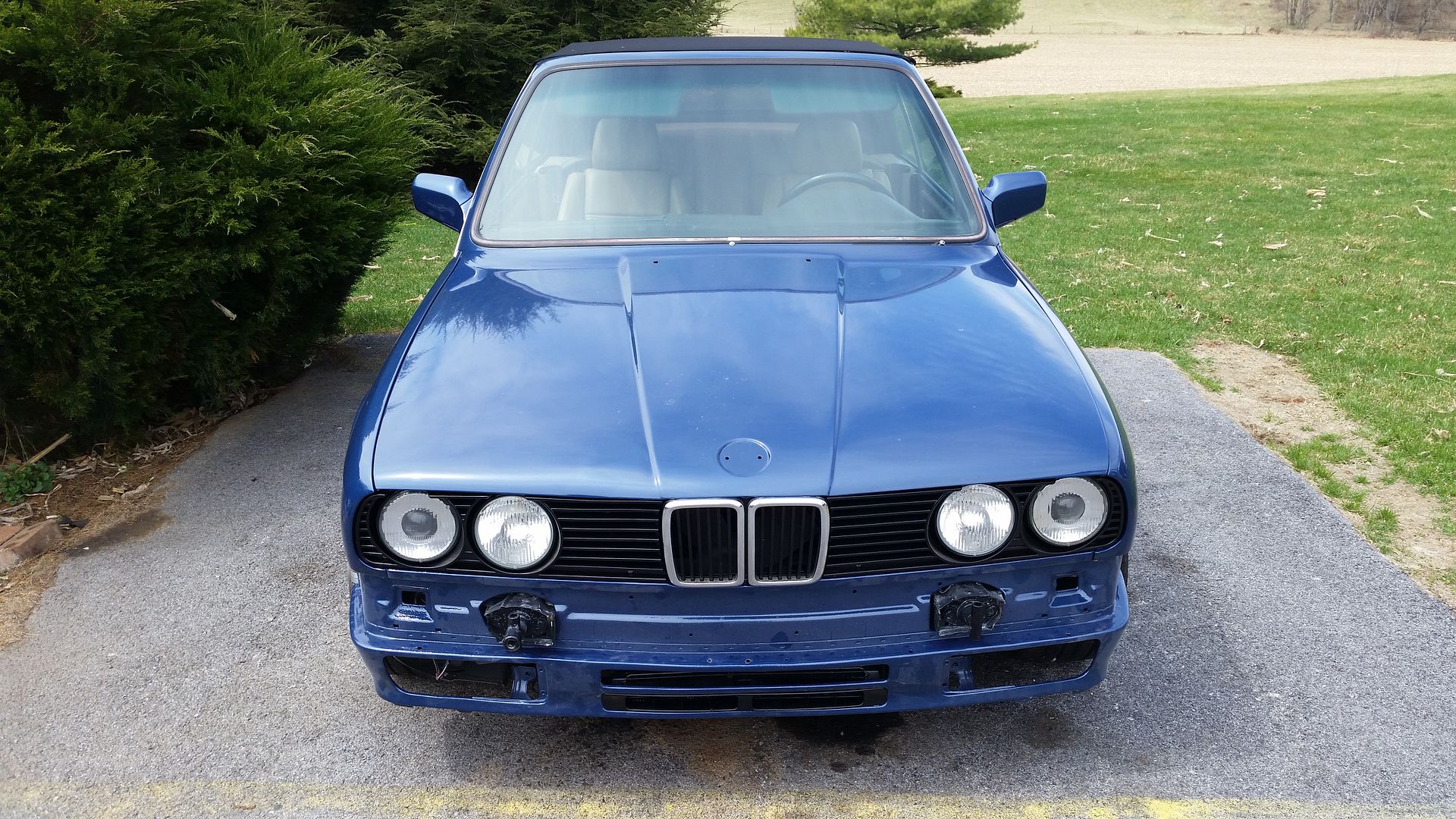

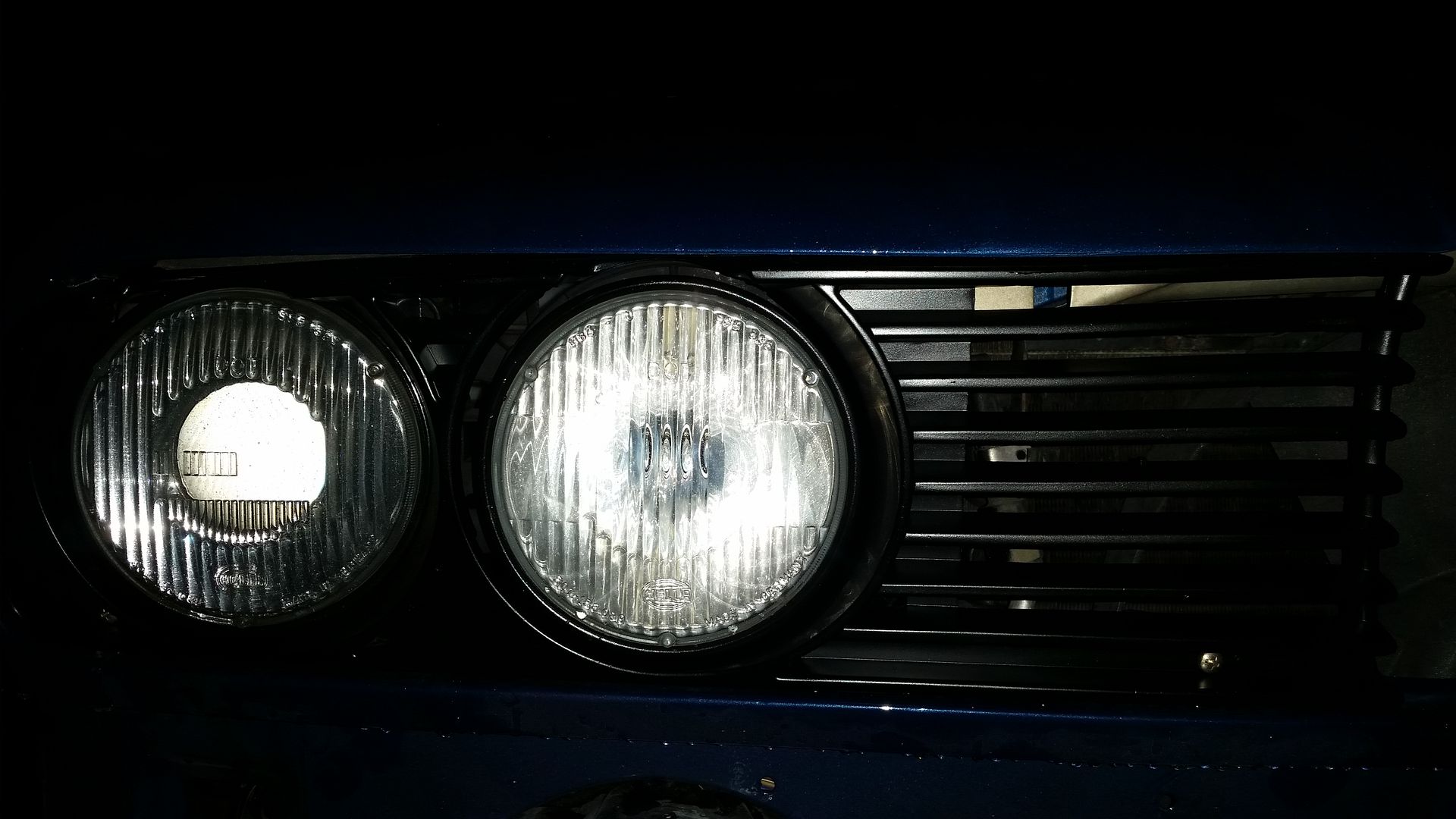

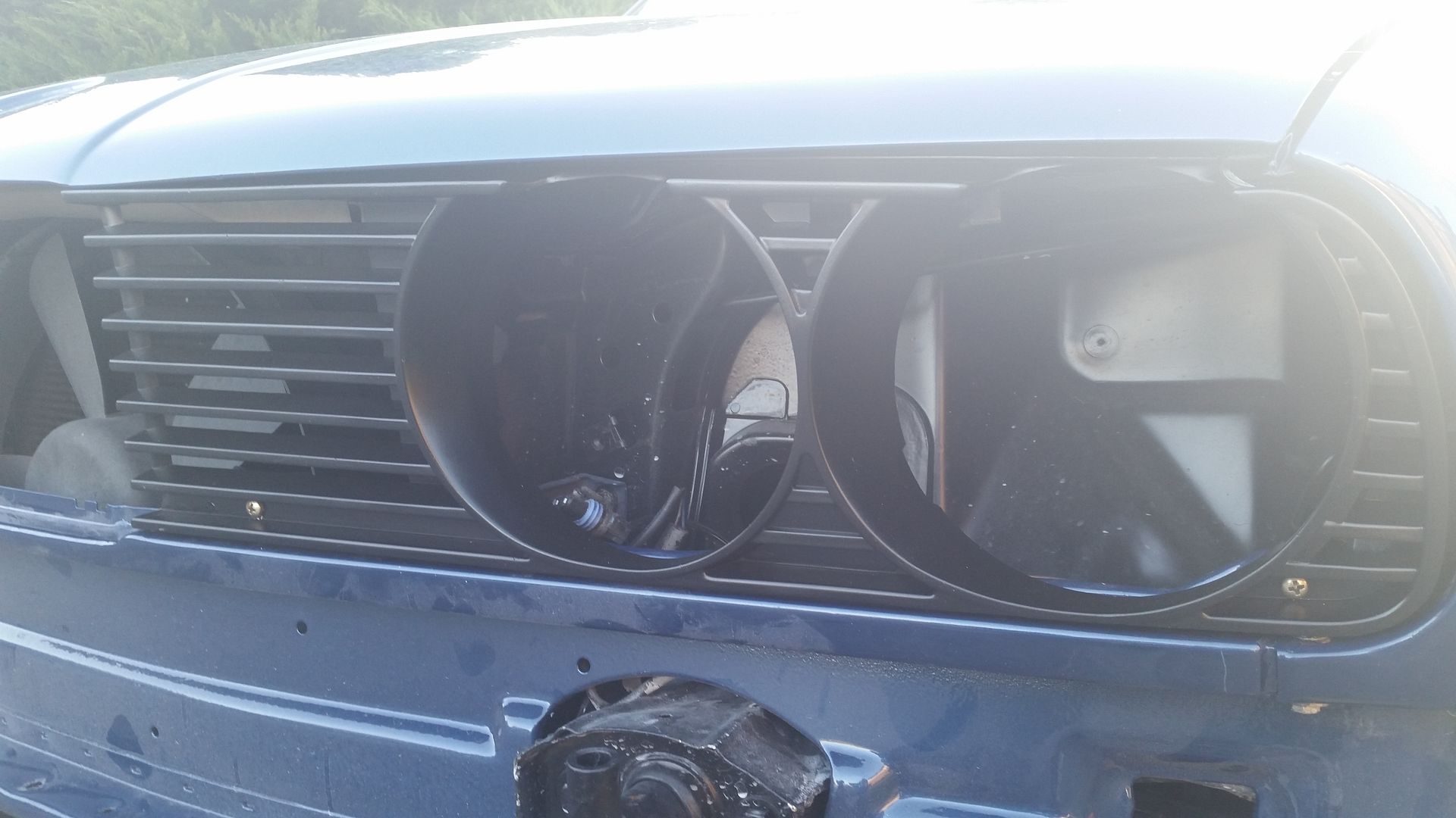

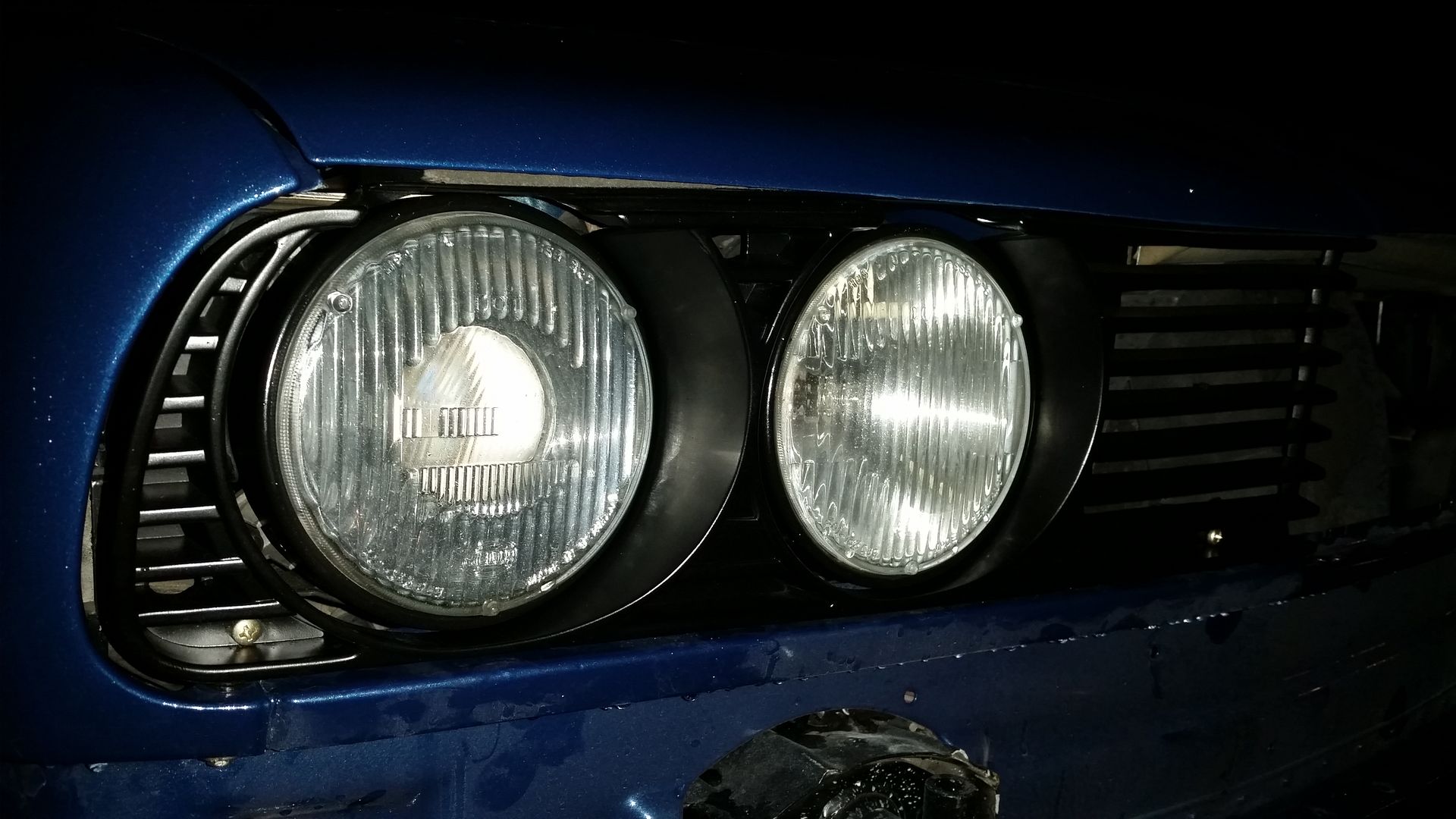

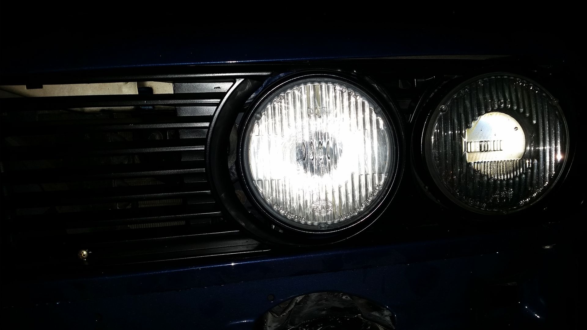

      So the grilles wen on late last week and I immediately identified a problem:

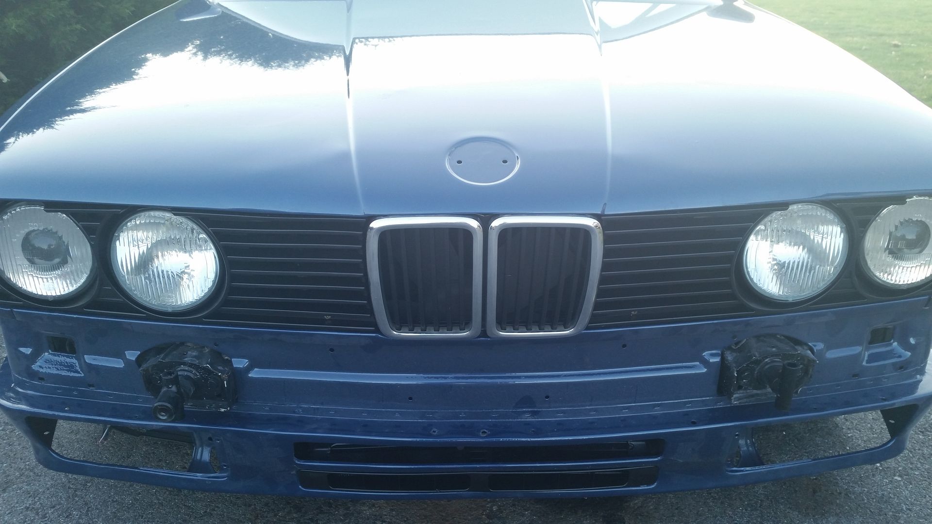

      Notice anything odd about the fit of the grilles? I did...they are in contact with the hood. I tried adjusting the alignment, moving the headlights, moving the screws, and trying several other things. No luck.
      Finally I took a step back in direct sunlight:
      That funny reflection on the hood- yup, that is a bend. I never saw it when the car was in pre-paint, and I never felt it in prep. I am a bit embarrassed to have missed it but I paid good money to have a bent hood painted.
      For now I will live with it but the hunt is on for a good straight hood.
      That said, I am still happy with the overall look-

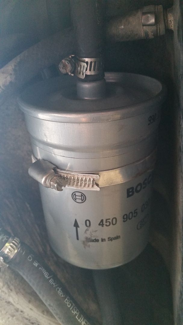

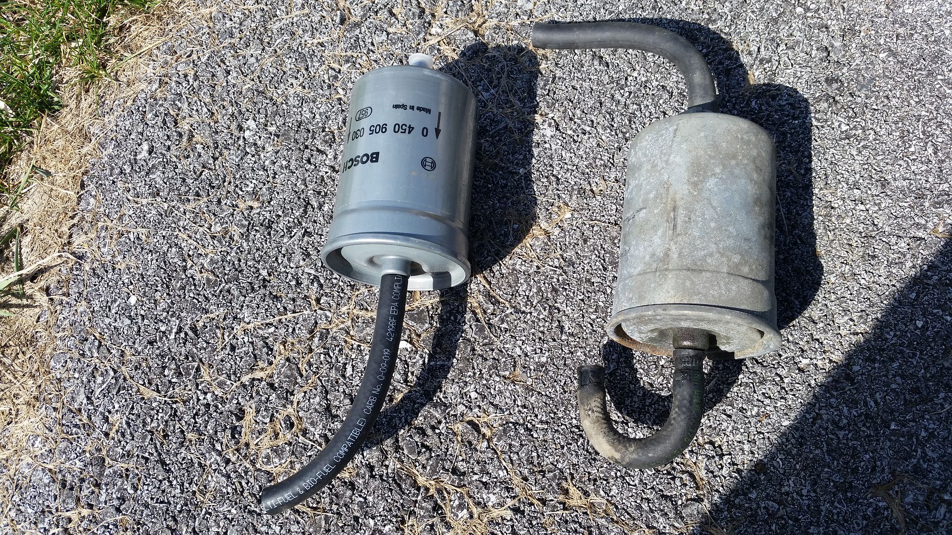

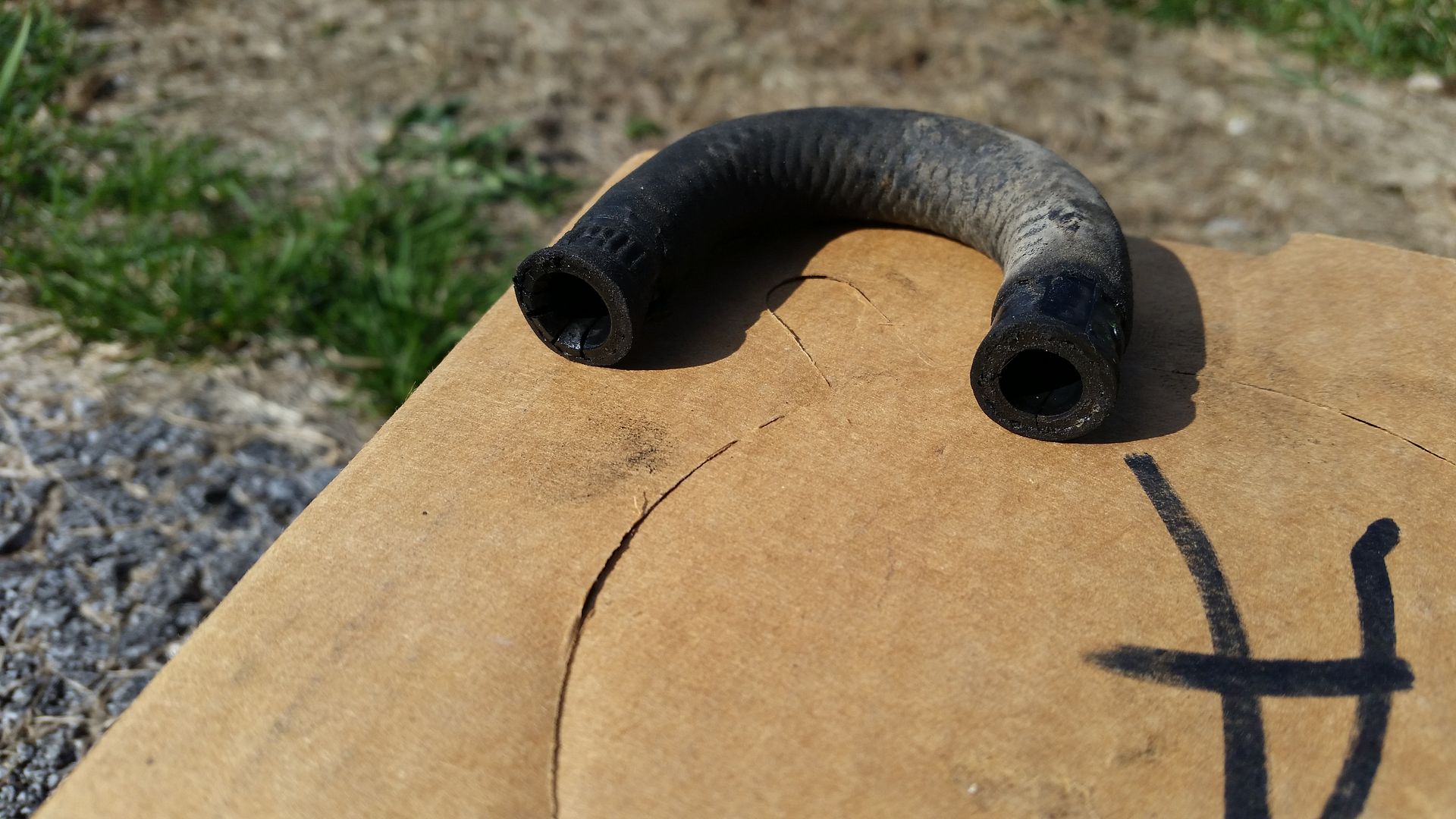

      Now for the good news- more progress toward being roadworthy. Last week I put up pictures of the sad state of the fuel filter, the fuel lines, and the general area associated with the fuel delivery. I ordered 10 feet of Gates SAE 30r9 fuel line from RockAuto and it arrived last Friday. I was on the fence on ordering the 2 pre-curved sections form BMW (about $25 for both) but decided to see if the "straight" line could work. I have not fired it up (I was too dirty to want to sit in the car after doing the lines and I had somewhere to go) but the curves feel pretty good and worst case I will buy the precurved lines and replace them. I needed the 10' of line to do the supply/return lines anyway so that was $24 well spent, particularly if the 12" of it that I used to make the curved lines works as it should.
      Some pictures:
      Old fuel filter versus new:
      Old cracked line. This was weeping gas- even at rest- and was pouring gas when the pump was running:
      And all buttoned up:

                  so you were pretty sure that there wasn't a bend in the hood before sending it to paint, but now there is one. seems like it's right at the spot where someone would push on it hard to finish shutting it... sucks :(
                    I, I actually am not sure that it was not damaged before. My guess is that it was bent before and I never noticed it. Before it was glossy it was not apparent. And eve after, I assumed that the curve was normal, until I put the grilles back in. I doubt that they managed to bend it from closing it...more likely part of the (PO's) damage that led to the mis-matched fender.
                    Patrick Henry
                      Looking back at pics in post 1 it looks like it was bent before and I missed it...
                      Patrick Henry
                        :P
                        Well, to be honest nobody else would have noticed it either if you hadn't. Just looks like a snug fit. Would totally kill someone with OCD, but I'd just run it and not worry about it unless a cheap perfect hood comes along.

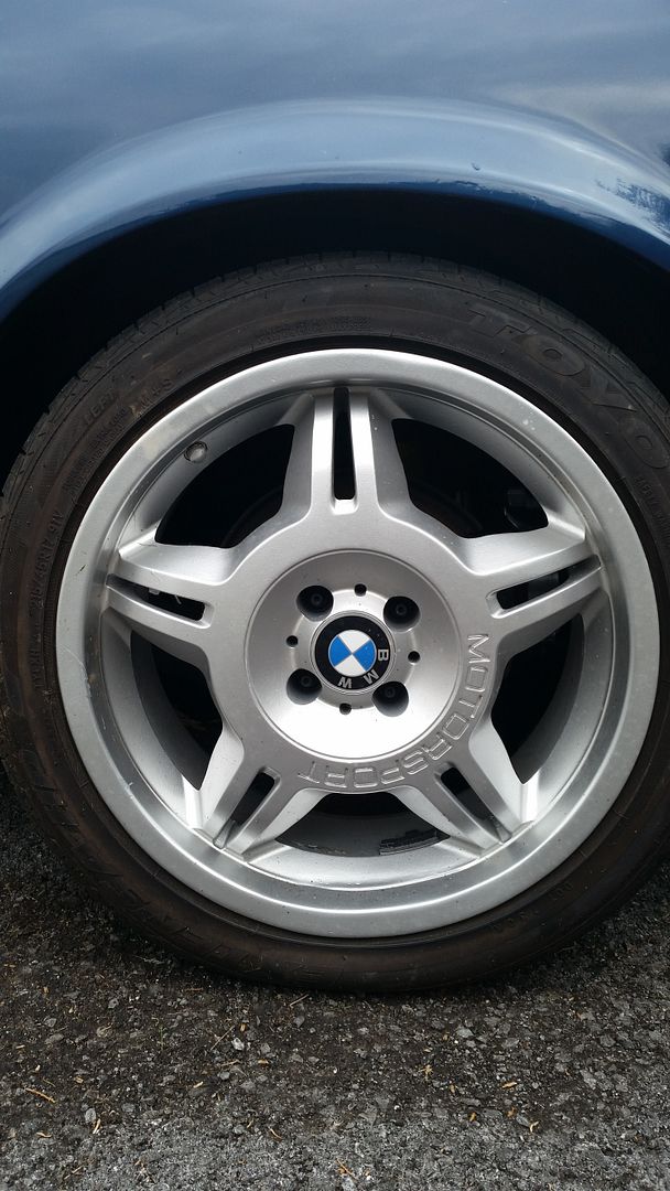

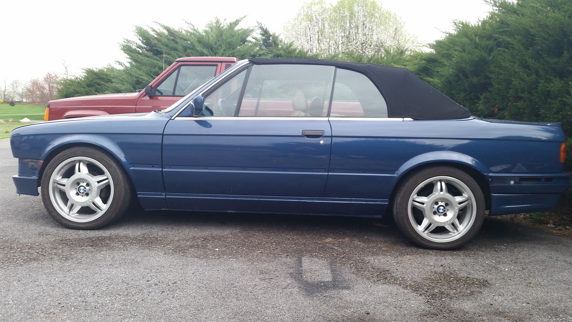

                                So I just noticed (after looking at the pictures posted yesterday) that the rear wheel gap did indeed settle a little after I drove it up and down my road. The trunk is still completely empty but it gives me hope that I will be satisfied with the final ride height without any changes.
                                You won't mistake it for a stanced car but for actual driving I think it just might work.
