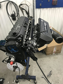

          • skarlqvist
            • Nov 2024
            • 5
            #425
ID:	10130595Click image for larger version
            ACSchnitzer S3 IXT with VW T5 Ronal wheels, Original M3 fenders with rework for read doors and handles.
            E36 compact hubs in rear and E87 rear hubs in front. Aftermarket big brake kit.
            CNC ported AMC head 43/37. Flows 173/134 at 10mm lift
            89,6mm M54B30 crank
            DP pistons 86mm/135mm Compression 9.0:1
            Full RHD roller cam kit with (AGAP roller cam 296gr)
            DBilas itb 45mm MaxxEcu sport
            Headers with 2x2,5" stainless exhaust and dual race cats.

                ~240whp (281bhp) seems about right for that, though i would expect it to peak at higher rpm with the short runner dbilas intake but this might be a lazy dyno tech not setting up rpm correctly. Personally i would consider the RHD inlet it is far superior perhaps except for the OEM looks or lack thereof

                  #428
                  280 whp in an ix on a awd dyno with perhaps 15% drive train loss is a dead race against an original S54 (tested on the same dyno).
                  There is room for an additional horses if you go for the 302/309/316 roller cams (street-ability will suffer, this is none vanos engines).
                  The RHD roller setup allows for revving to 10K but the 89,6mm crank in my car translates to a pistonspeed of 25m/s at 8400 rpm.
                  Piston speeds of 25m/s is the upper limit in most engines.
                  The original m20 oil pump will start to cavitate at 8000+ so the real max rpm is actually 8000 (one must move to dry-sump for higher revs).
                  My engine is build for boost and >500Whp. If I was to keep it na I would have gone for RHD itbs, any day.
                  I have been talking to DBilas and they have pressure tested the plenum and itb construction for 2 bar.
                  For this car I have bought an Australian "Raptor V" supercharger and since the ix front diff is the weakest part I will limit power to 500whp on pump gas.
                  The engine needs a lot of air in and out. I use AEM Dry flow 76/135mm and the custom build 2x2,5" exhaust below.
