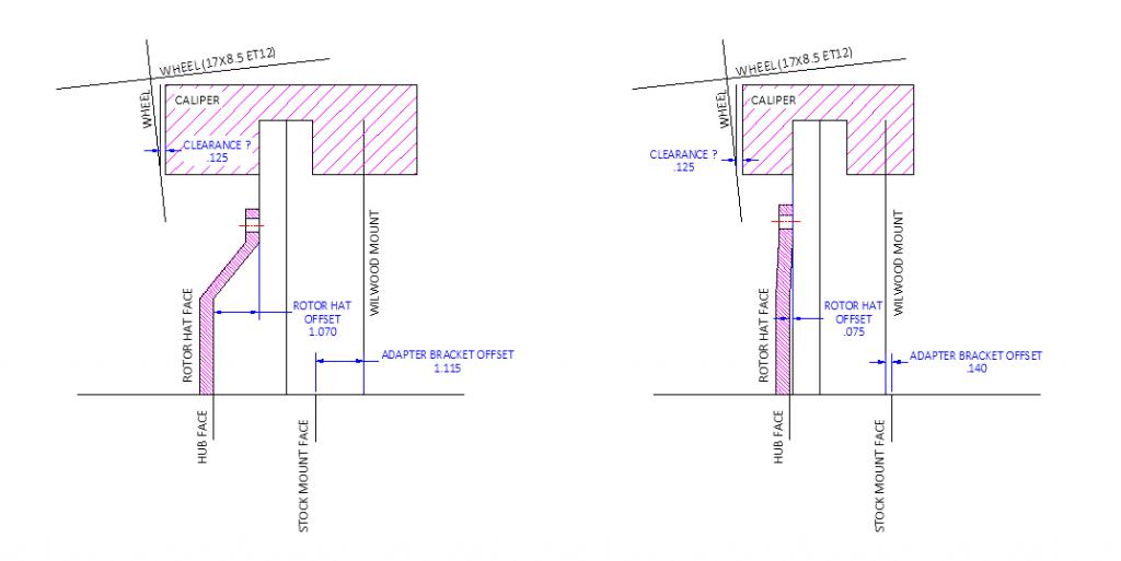

                So I'm trying to work out my brakes... and could use some advice
                Things I'm trying to decide on:
                - How far away the caliper should be from the wheel. Leave more room for different wheel options?
                - How far can I move the caliper before the rotor hat and adapter bracket offset is enough to cause an undesirable torque during braking?
                - Do I even need to be worried about this torque?
                The two calipers I have modeled are the Wilwood Forged SL6R (left) and the Wilwood Forged Narrow SL6R (right)
                The narrow version is about $75 more a corner, not sure if its worth the price difference, but if the offsets and clearance are an issue the narrow version should be better.
                Any help would be greatly appreciated!! :)

                EDIT: I'll get back to this later, but thanks to Northern for the help!!! http://www.r3vlimited.com/board/showthread.php?t=391821

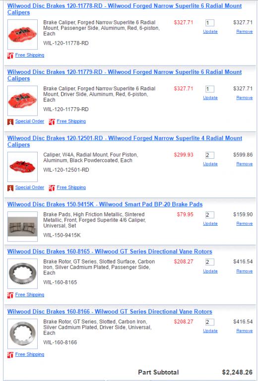

                                Why do brakes have to be so damn expensive?? Guess I wasn't expecting to spend so much to stop 0.o
                                Current wish list...
