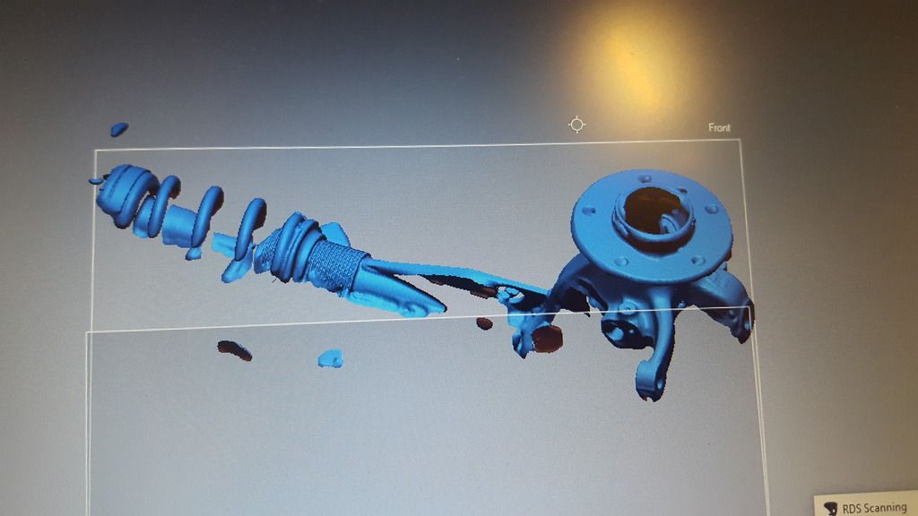

                        Ah, for some reason I thought the ix and rwd brakes were different (at least the caliper mount position anyway), good to know! Ethier way, with the 135i hubs up front I would need a custom hat for the massive adapters to work.
                        12.2" rotors would probably be more that sufficient for road and light track use, like Nisse has done. Even the cheapest 12.2" Wilwoods are $100, and anything up to 13" is about the same price at $200. Like you say it's not until you get the 11.75" straight vane are they below $50 a rotor. Idk how to compare estimated life of the rotor, besides strictly the difference in mass and surface area. I'll keep searching for a cheaper alternative to the $200 13" Wilwoods, maybe come up with something else.
                        I spent some time with the romer arm today after I pressed in my bearings and hubs. I'm going to bring in the front wheel tomorrow and scan it also. Planning on mocking everything up in Design X and Autocad. Hopefully minimize the guess work, and prevent me from going to bolt it up and ending up saying "well fuck" haha. I can share the files when I'm done if anyone else wants to play around with it for themselves.

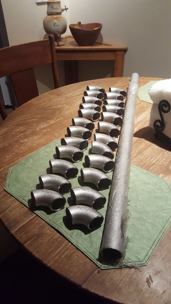

                            Also picked up this stuff the other day, all 321ss :D

                              I think I know what that stuff is for [emoji1]

                                My brake setup is pretty cheap, but pretty heavy too :P I will probably replace the calipers with aluminum ones and maybe also two piece rotors...
                                Uh, i see you have som welding to do! :D
