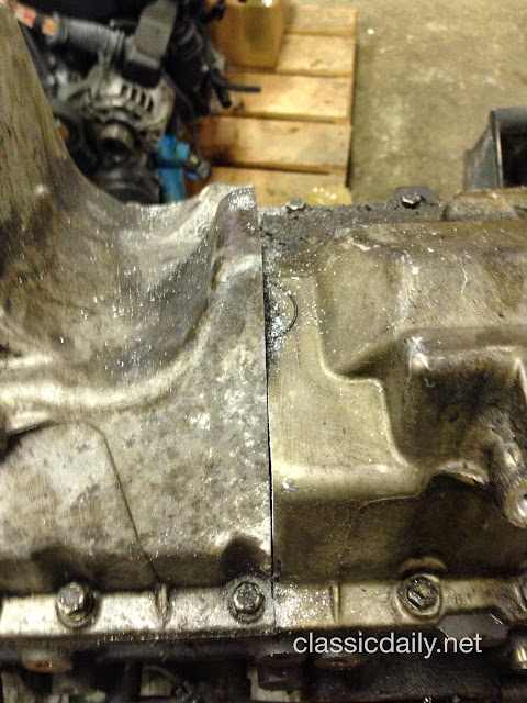

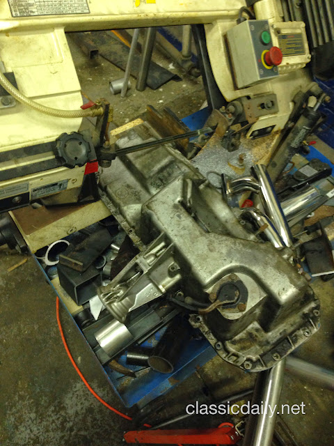

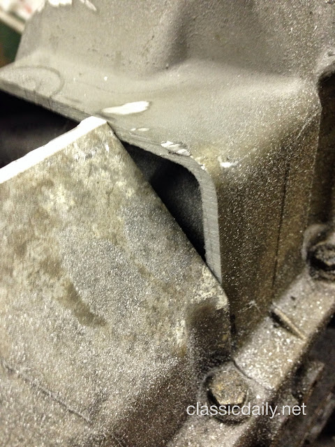

              Let's cut an oil pan
              And another
              [img]https://lh4.googleusercontent.com/-bL1ukLASG3k/U77PiN9BtiI/AAAAAAAAMFI/L9ifqkTCRgo/s640/IMAGE_1805.jpeg[/img
              Pretty happy with the fitment after a couple cuts...
              Two will become one...
              A few holes will have to be closed up.

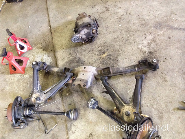

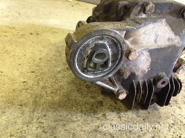

              All new bushings in the rear...trailing arm, subframe, diff
