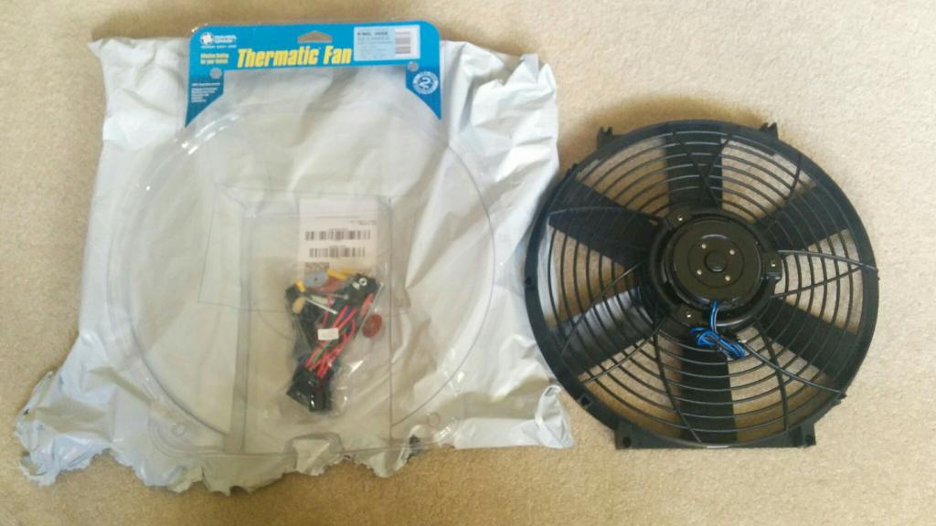

                          New radiator fan came in the mail. It's a Davies Craig 16" Thermatic 12v, rated at 2120 CFM.
                          http://www.daviescraig.com.au/Therma...6-details.aspx

                          Boost gauge is on the way, and I'm still working out what fittings I need for the oil pressure and water temp gauges.

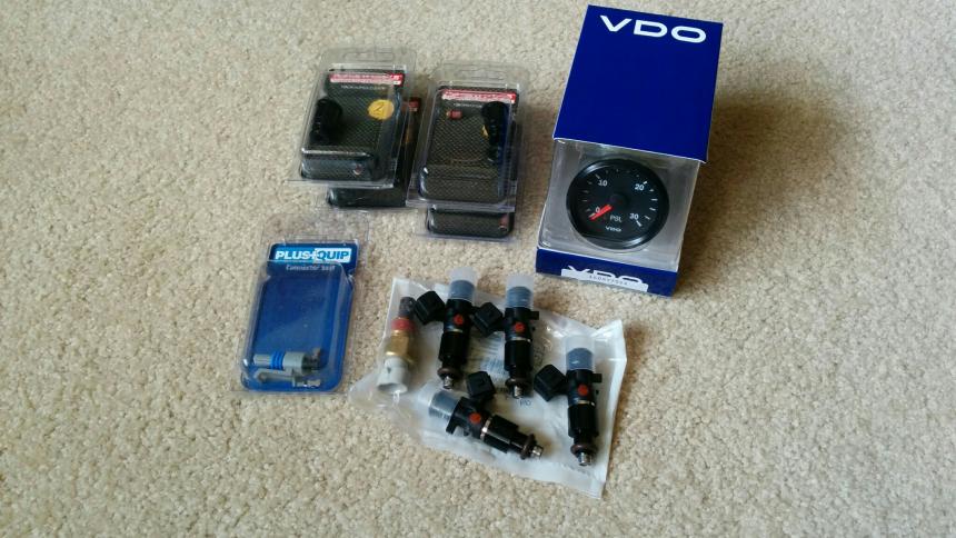

                            More bits arrived:
                            • VDO 30psi boost gauge
                            • Intake sensor
                            • Bosch 1150cc injectors

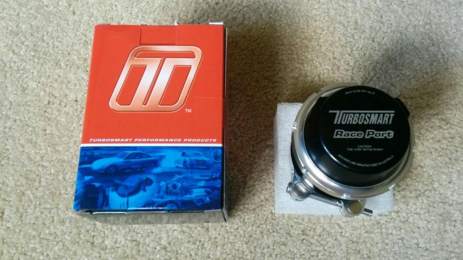

                                Picked up a Turbosmart Race Port 52mm blow off valve for a great price:
